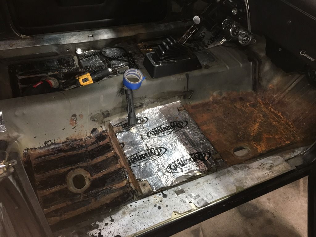

I was sent the correct muscle bar and installed it but it did not help with the body twisting and all and my tire woud still make contact with the quarter on both sides going up and down my driveway. I decided to purchase DSE subframe connectors. Also built some of those stands out of 2x4s to help with the install.
I started the install to find more rust as expected on the floor pan. I knew about this when I purchased the car but did not know it was quite as bad. All 4 low areas of the pan have rot and the firewall toeboards too. I'll hold off on the subframe connectors for the time being. I need to evaluate some things and see what I want to do with the floor and quarters.

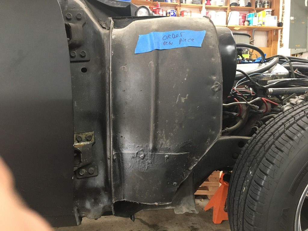

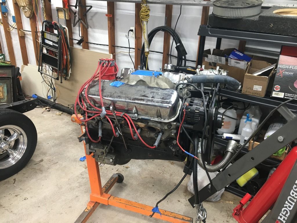

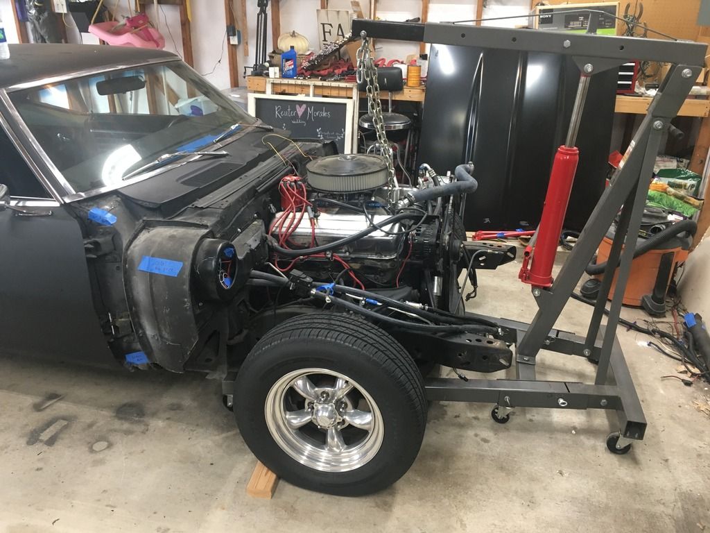

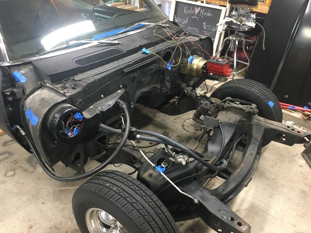

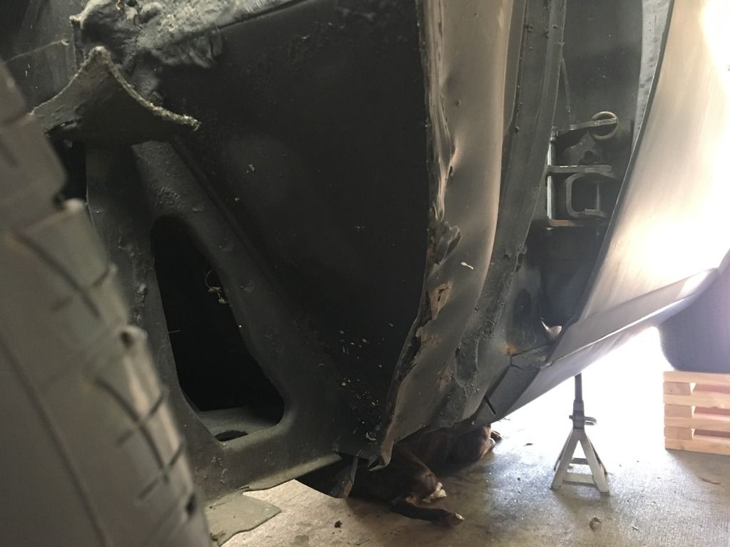

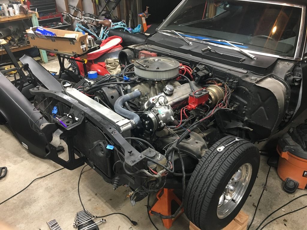

The shop said the cheapest way to get this stuff fixed was to send in as much of a shell as I could so I started by taking off the front sheet metal and the motor.
I found a creative patch on the PS side cowl piece that I'll be repairing when the car gets back and some rust on the driver side I'll be addressing.
FWI, I placed the motor mounts back on the stands after I removed it. Dont let the pictures fool you.
[/IMG]
