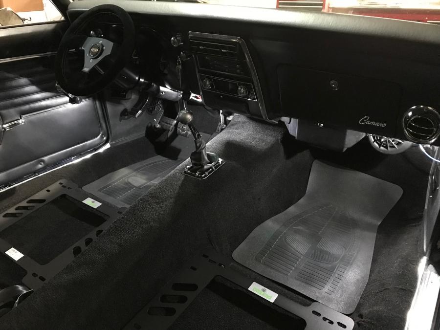

Ever have one aspect of your project that you procrastinate doing because it's gonna be a pain and you know that unless you're in the "mood" to do it, it's just not gonna turn out right? Well, I've been working around, delaying and just not in the right frame of mind to deal with that God-forsaken engine fuse box for awhile now and finally got stupid thing stashed away in the glove box. Although that's been the plan all along and at times I've fabbed up brackets, etc. I never really liked where or how it looked (or the glove box door didn't shut right).
I searched high and low for other types of brackets offered but to no avail with the exception of a GM bracket that didn't offer much use as it turns out. So yesterday I ditched the GM bracket and spent some time test fitting and mounting the fuse box and I'm happy to report that it's no longer hanging from a zip tie on the passenger window crank! Now that the glove box door is back on, it's finally starting to resemble a complete interior...

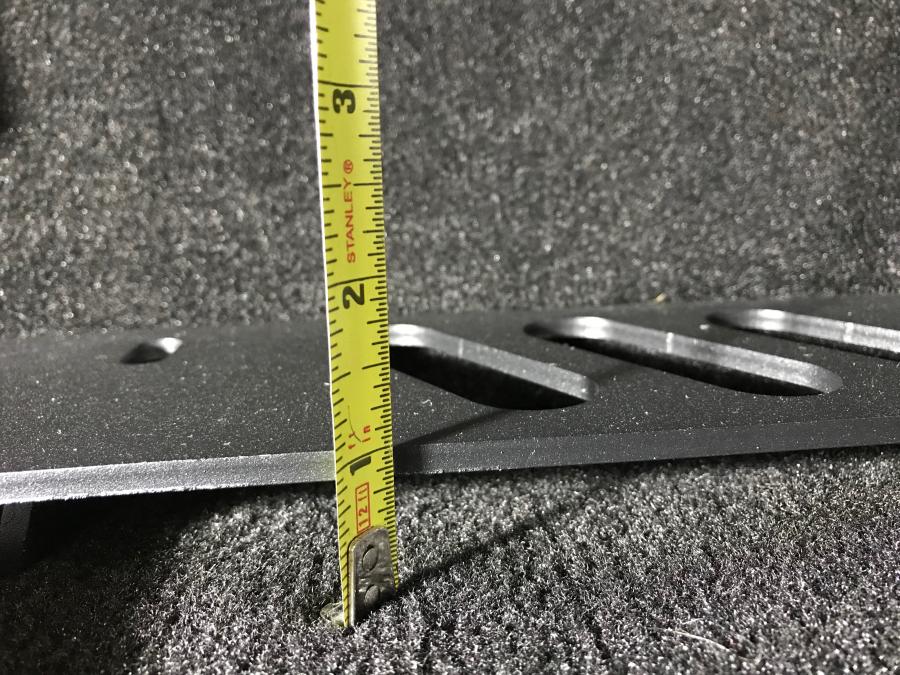

May I ask you for a huge favor ?
Could you tell me the measurements from floor to top of those seat brackets ? I am trying to see if I can fit my ecu under my seat
It measures 3/4" clearance between the carpet and the bottom of the bracket. In my case, in addition to the thickness of the carpet (which is thin), there's a layer of Dynamat as well as a layer of 1/4" Dynaliner. The Planted brackets are pretty typical for mounting Recaros I think and there'll be maybe a little more room by the time you add the seat adjuster plus whatever open cavity there is in the bottom of the seat. Hope that helps...
Thank you very much !
Where did you mount those under dash LED lights? they look great, makes the interior pop. also, where is that shifter from? thanks, nice work sir.
