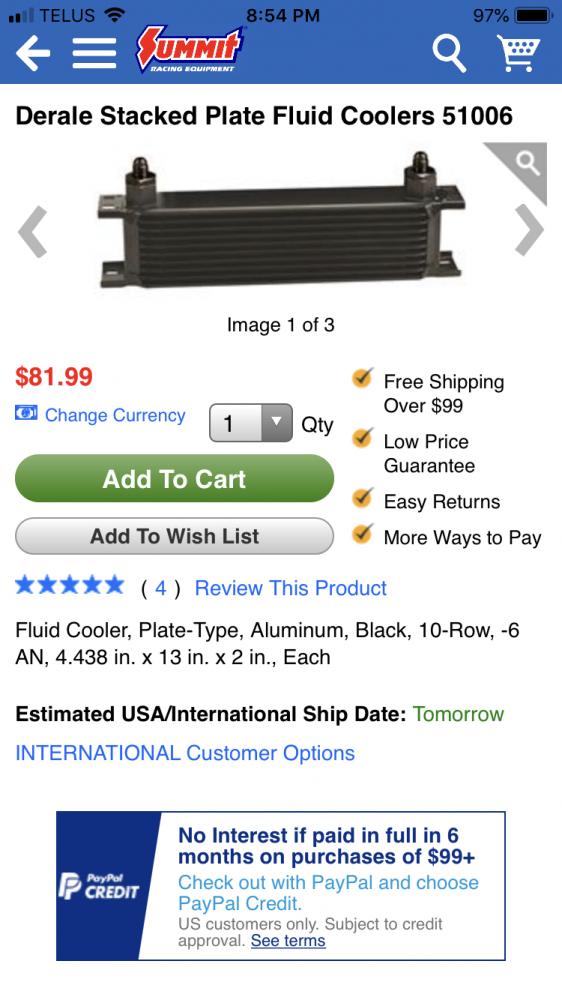

I recently picked up this one from Summit. Would this be big enough for weekend autocross and the occasional HPDE? I’m running hydroboost as well.

There are those with electric fans as well.
