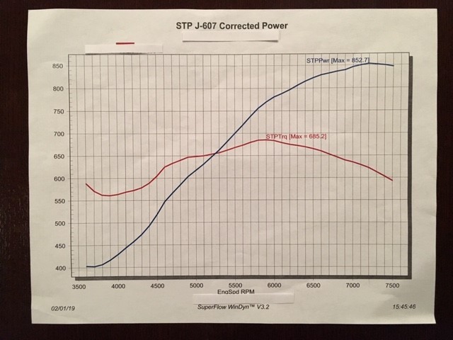

Finally got the motor on the dyno. 852.71 peak HP @ 7100 rpm, 685 peak torque @ 5900 rpm. Should be enough.

Not bad for an NA motor. The AFR was a little fat, especially 3500-4500 rpm, and the timing was only at 34 degrees, so there was a little more to be had with tuning. I will do that when I get it on the chassis dyno.

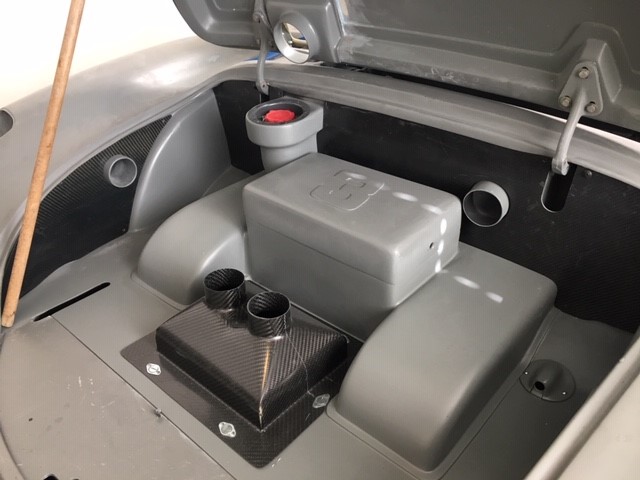

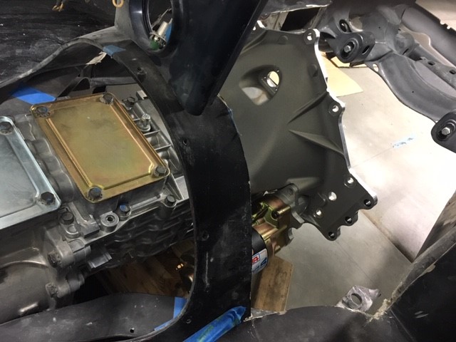

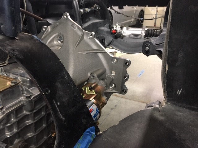

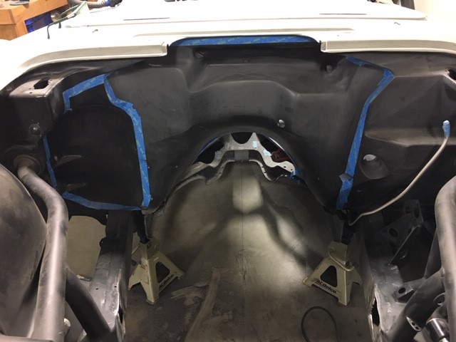

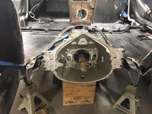

Haven't posted in a while. Finished up the Decalink rear suspension and rebuilt the trunk where I cut it up to do the rear suspension install. Added a fuel door in the deck lid so I didn't have to open the trunk (with the wing and supports that run through to the frame) every time I refueled. Cut the firewall out to move the motor back 6 more inches (for a total of 15) to get clearance between the dry sump pump and the lower control arms. Turned out to quite complicated since I had to modify the x-member to get clearance for the rear mounted starter motor and so I could pull the transmission from below the car instead of out through the cockpit, but I'm getting it done. Looks like my driveshaft will be 19 inches long - LOL
Pappy
The open 3 inch holes get air hoses that bring air from the side scoops to the differential and fuel coolers.

Firewall before the cut
Name:  56 Corvette Firewall before.jpg
Tilton Bellhousing
Name:  56 Corvette Firewall 6.jpg
Reverse mounted starter
Name:  56 Corvette Firewall 7.jpg

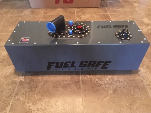

I also got the fuel cell from Fuel Safe. 19.7 gallons, 1.76 gal sump with trap doors, Aeromotive 1000 pump.
Pappy
