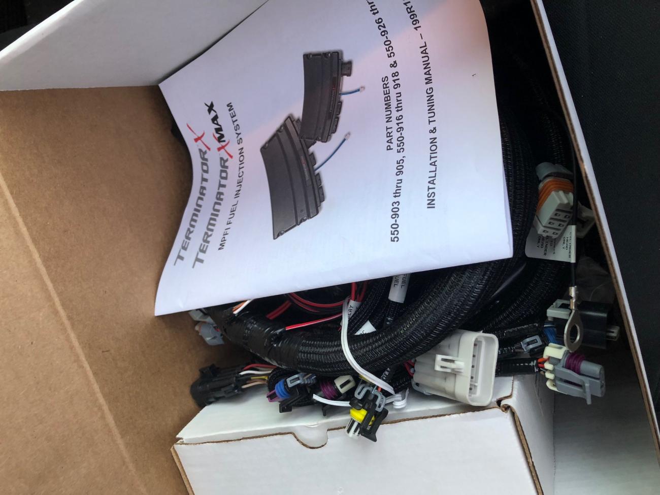

Eh, well maybe I was a little more ready for this than I thought...
I'm sure there will be plenty of reviews out there before mine is done but I'll let you all know how it goes!

Look forward to hearing it.
Watched a couple of reviews of the software and it does seem like a truly capable piece. Excited to see it.

You and I both! I'm ready to get the car going.
I'm really liking the videos that I'm seeing, it looks like it's going to do everything and more than I need.
