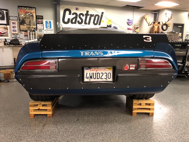

Filled the bumper recess with
1/16" ABS and a little Aluminum
Saving weight
Bob

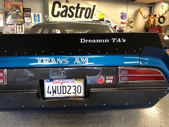

Fixed the broken rear spoiler extension and
installed the Dreamin Ta's decal that my wife and her
friend made up for me two years back
Finished the new harness belts Car is almost
ready for Crow's this weekend
Bob
