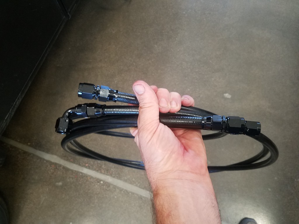

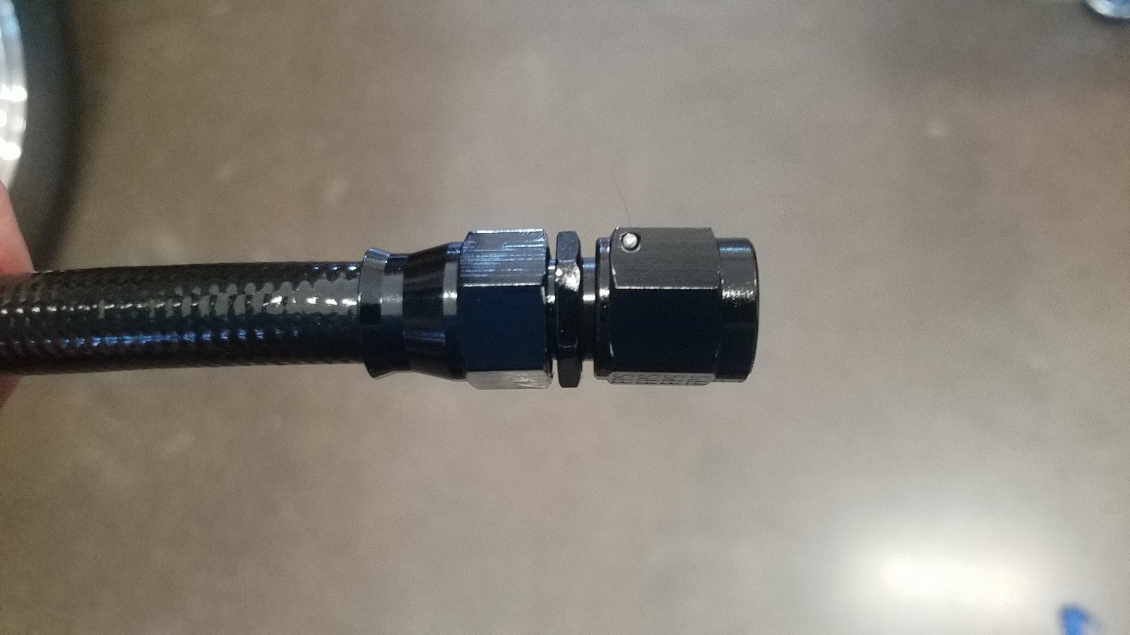

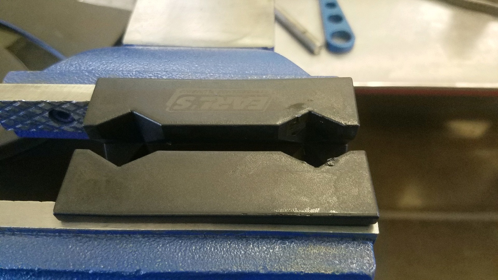

I'm not going to sugar coat it...had a couple of pretty frustrating days in the shop.
I finished up putting the hose ends on the lines Friday and actually got pretty good at it by the end.
This "third hand" I picked up really helped with the process
Wish putting the tank in went as smooth. My guess is the new replacement tank is a smidge larger than the OEM tank and I struggled getting the old straps around the tank and installed. What should have taken about 15 minutes took a couple hours. Then I had to run the fuel line and my desire to make it as fit and finish as OEM led to more frustration. Between being larger diameter and stiff...I had a fight on my hands, but I got it done. I quit for the day and decided to wait until I was fresh Sunday morning to fire up the pump and test for leaks. Good thing I did...
