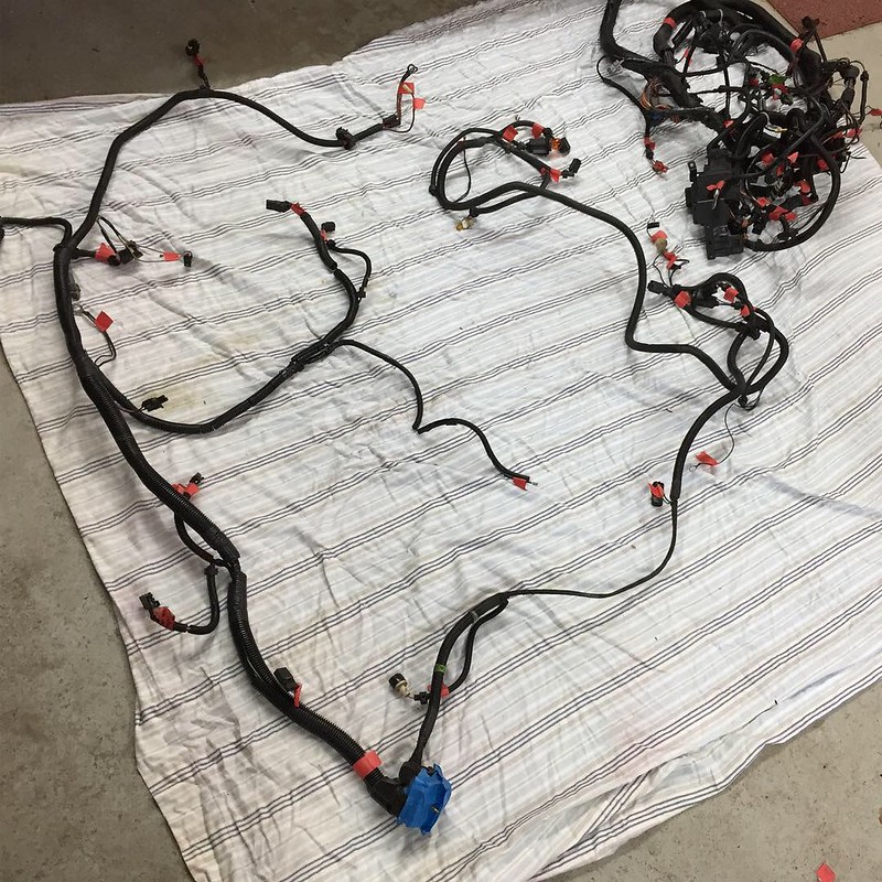

Not much of an update tonight, been busy with a kitchen remodel so car time has been minimal. One thing I did get started on was the wiring harness. I've done some basic soldering in the past to extend and shorten wires or put on a new connector here and there, but nothing to this magnitude. I'm looking forward to it though, there's a been a lot of learning experiences along the way here and this is just another one to take on!
I started with just laying out the harness to get a good look at it:

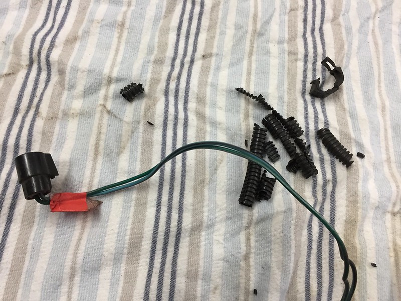

I started taking off all of the old plastic loom next since I plan on re-taping the whole harness using some quality tape. The stuff was literally disintegrating in some places:

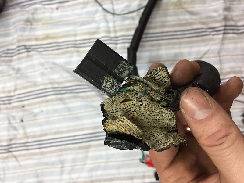

Some of the connectors are in rough shape too... this one for the AC compressor has a resistor shoved in it for some reason:
I'll post some updates as I move along with the harness!

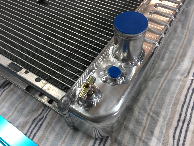

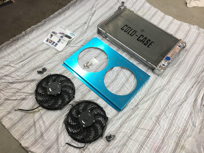

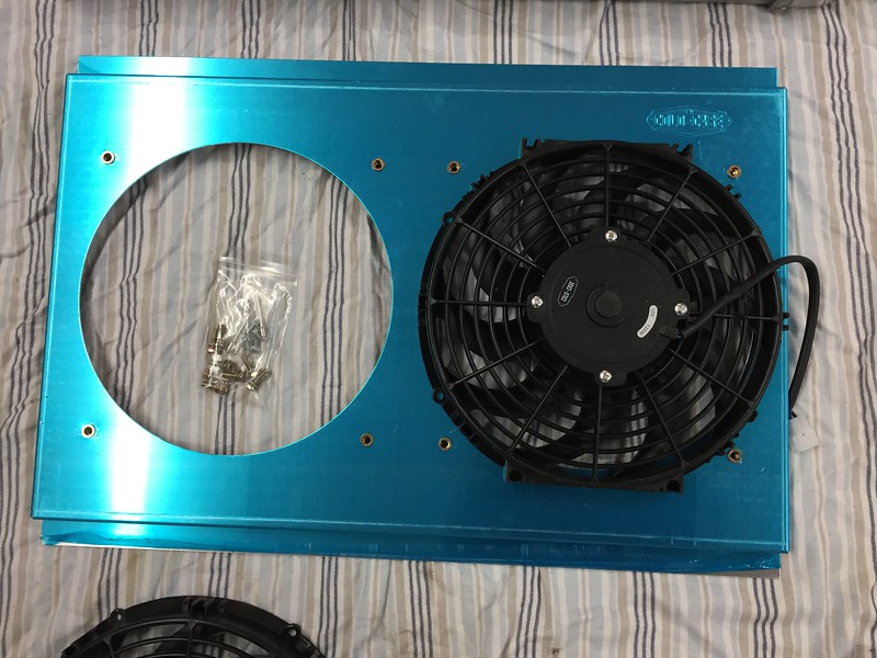

I had some issues with overheating when I had the car on track back when it was running so I've been doing some research on a new AL radiator. I ended up going with a drop in replacement from Cold Case Radiators. I hadn't heard much about them before but as I started looking around I found they had some great quality products and their prices were quite a bit lower than the big guys out there. I decided to give them a shot and so far everything looks good... it will be a little while before I can install it but I wanted to unpack it and see what she looked like:
One thing I'm a little concerned with is that the fans do not have any designated mounting holes in the shroud. It seems that I'll have to drill these and use some riv-nuts or something to get them mounted. Maybe this is where the lower cost comes from:
One last question - the radiator is universal for 3rd gens, so it has an automatic transmission cooler built in. Has anyone ever used this for an oil cooler? I was going to buy a separate cooler but maybe this would be more efficient?

A/T cooler fittings are too small and not enough flow for an oil cooler.

What you called a resistor is actually a factory diode on the AC compressor line.
The diode prevents the AC clutch from creating a voltage spike or arc on the relay contacts when engaged. I know it looks like a hack job but that's how the factory did them at the time. Newer cars have the diode placed in the fuse panel which is a much better, safer and more elegant spot in the harness.
I build my own junk...

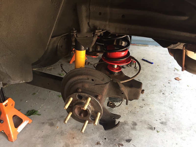

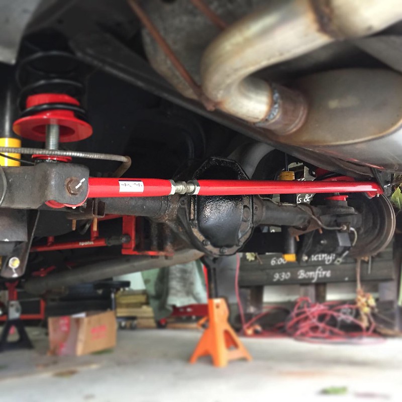

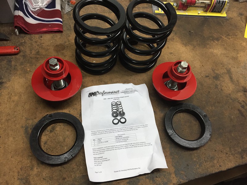

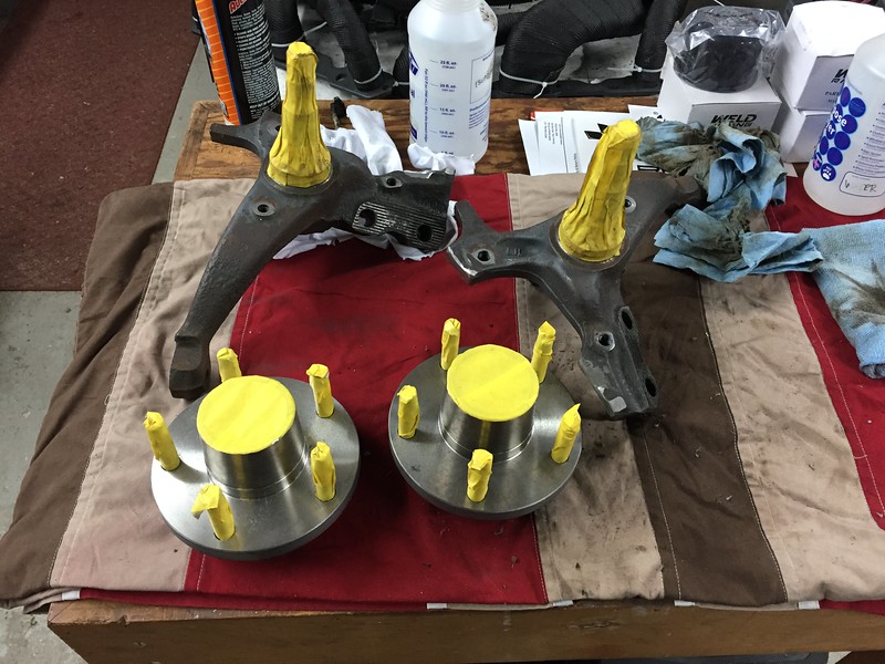

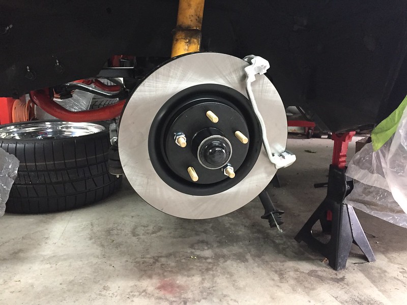

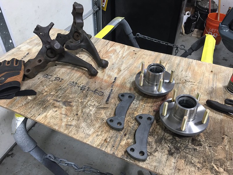

Rear suspension going in. UMI weight jacks, new ARP studs in the axles and a Spohn Panhard bar that came with the car:

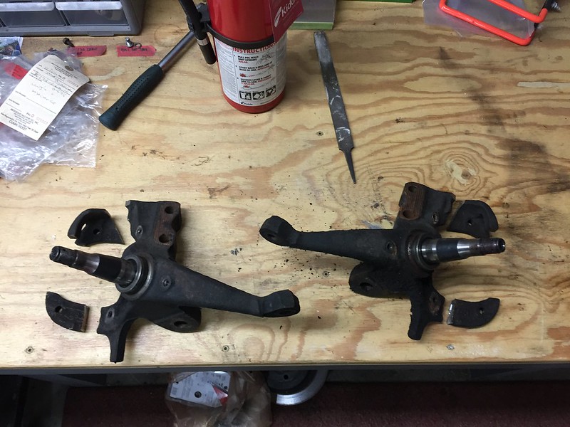

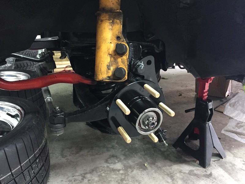

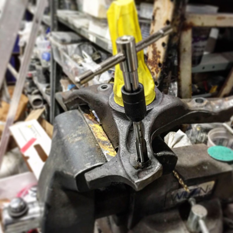

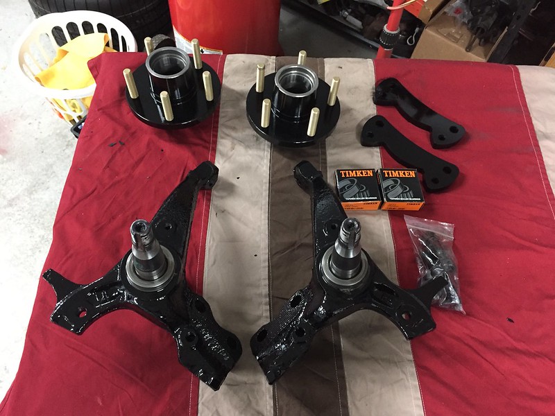

Front suspension going in. UMI weight jacks, stock A-arms rebuilt with Delrin bushings and tall ball joints, modified stock spindles for C6 Z51 front brakes and 13.4" rotors, upgraded hubs for 1LE bearings:

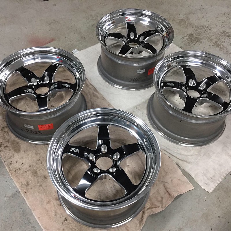

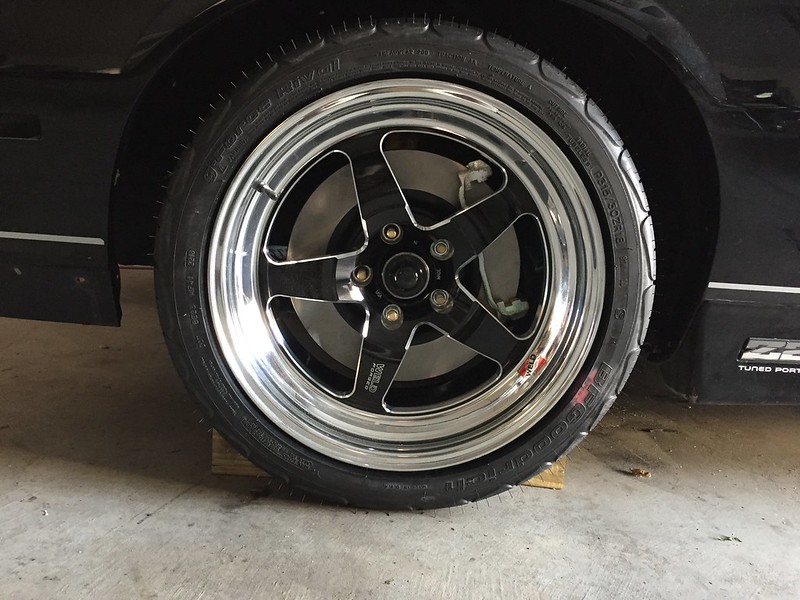

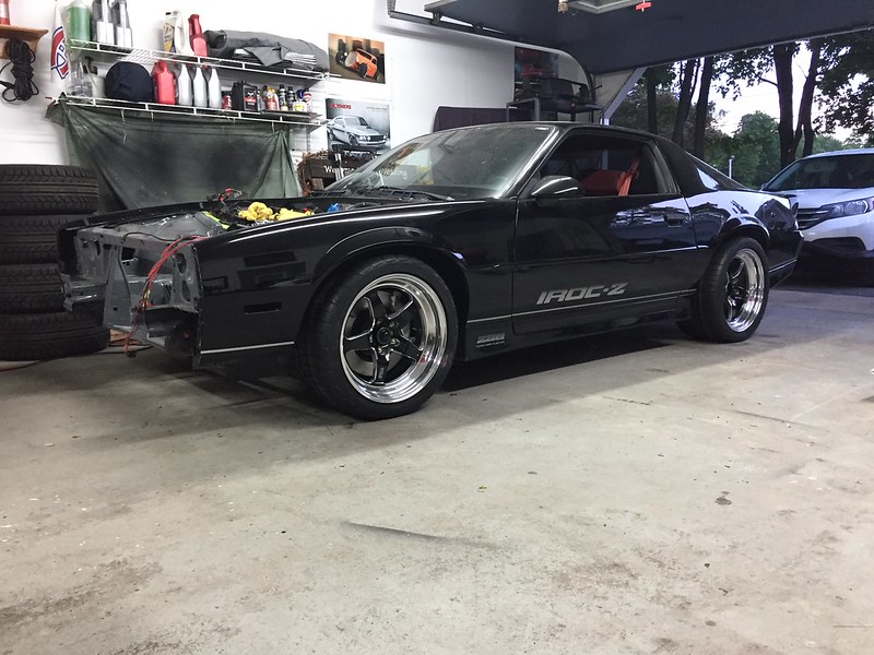

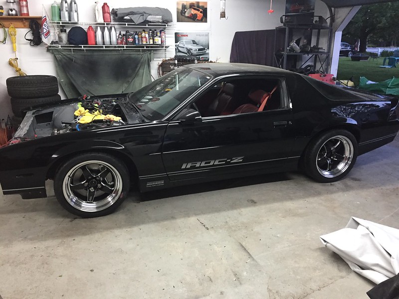

And my wheels and tires are all mounted up and ready to go!
First time the car has been on all 4 tires in 1 and a half years!

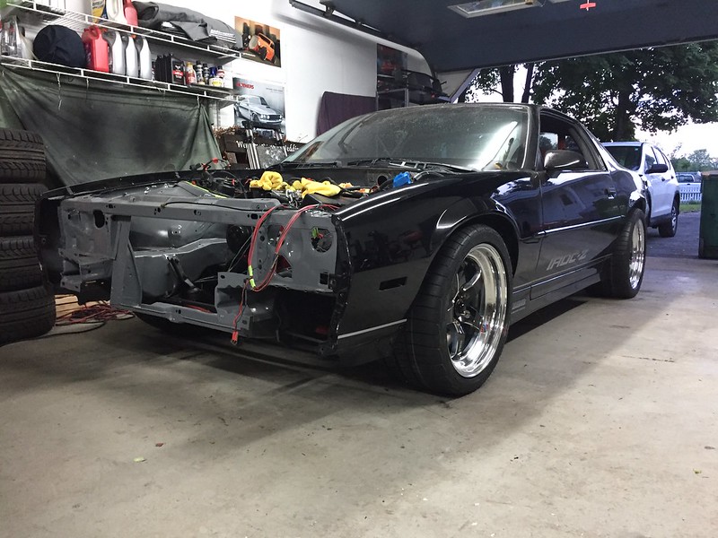

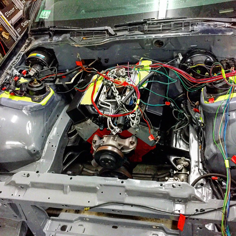

I'm currently attacking the engine bay and trying to get everything squared away there. Since this picture was taken, I have my steering shaft installed, headers wrapped and installed and I'm almost done with installing a newer serpentine setup from a later 3rd gen:

Where did you get your hubs and caliper brackets? Those Weld wheels look great on the car!
