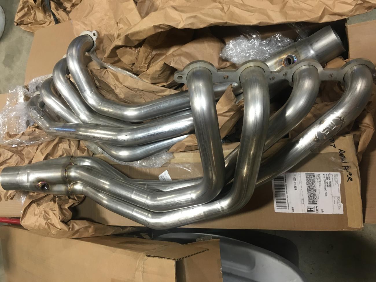

To get the ghosts of horsepower past out of the engine and flowing to the rear I picked up a set of Stainless Works 2" C6 Z06 headers from a member here. These and the trans were both guys that reached out here.

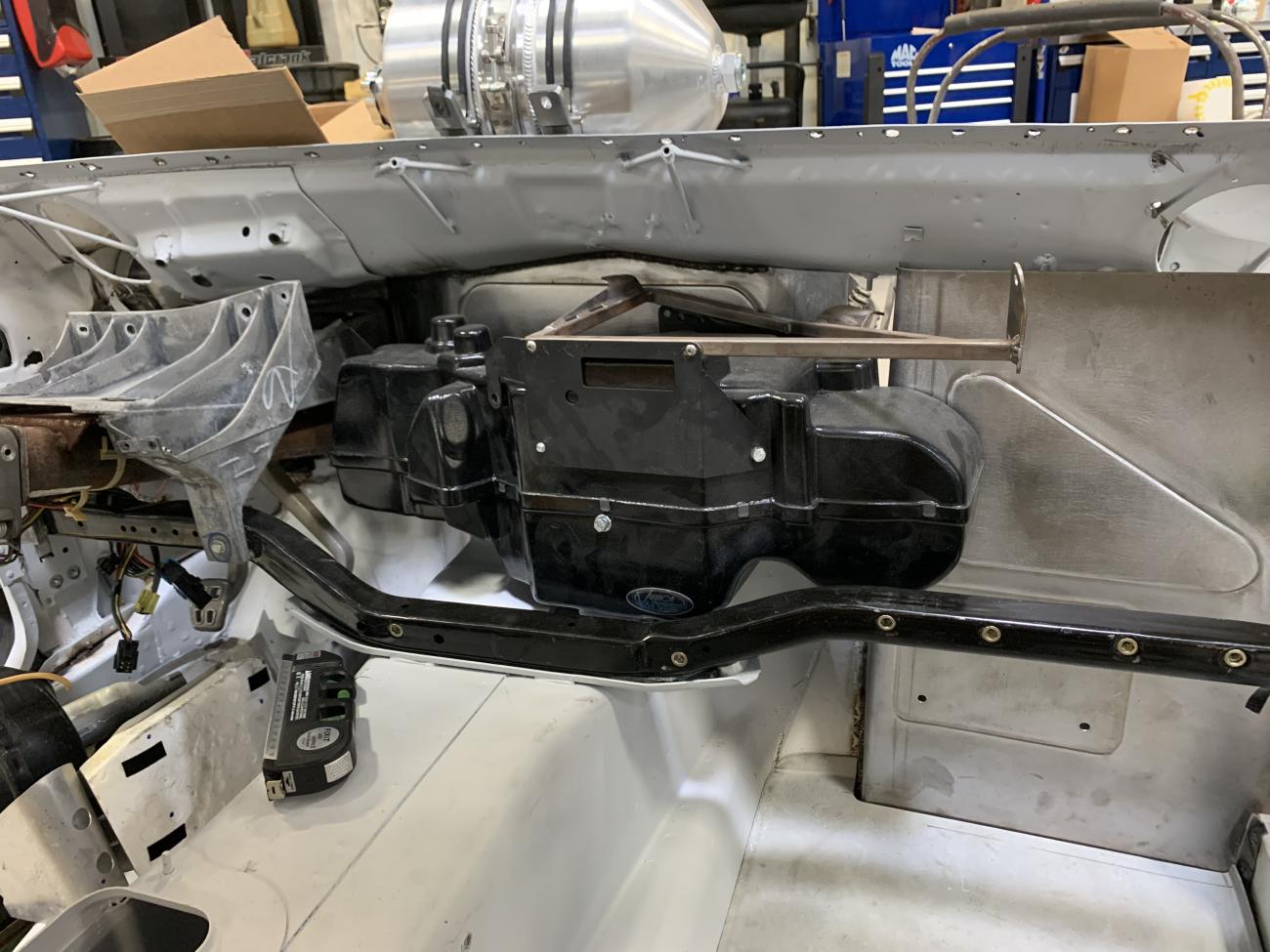

Now lets talk about the last part that showed up and progressed the firewall this past weekend. The 3 gallon dry sump tank. I wanted to put the tank in the tulip like Mark does, but the Vette frame takes up a lot of that area. So I moved it inboard some. It looks like I gave up a lot of foot well space, but you can see how much of the floor I hard to cut out. This is also the area GM put the fuse block and BCM so I actually lost no room at all. New firewall and the oil tank are mounted. I can now finish up the firewall on the passenger side and get the Vintage Air bulk head mounted too. I'm still trying to figure out were to put the breather. It might go where its pictured or on the other side. The plan is to make a cover to close out the tank area and help protect it from the header heat. I also still have plenty of room to mount the full size Vintage Air IV Magnum over the trans tunnel so my glove box will actually be full size.
