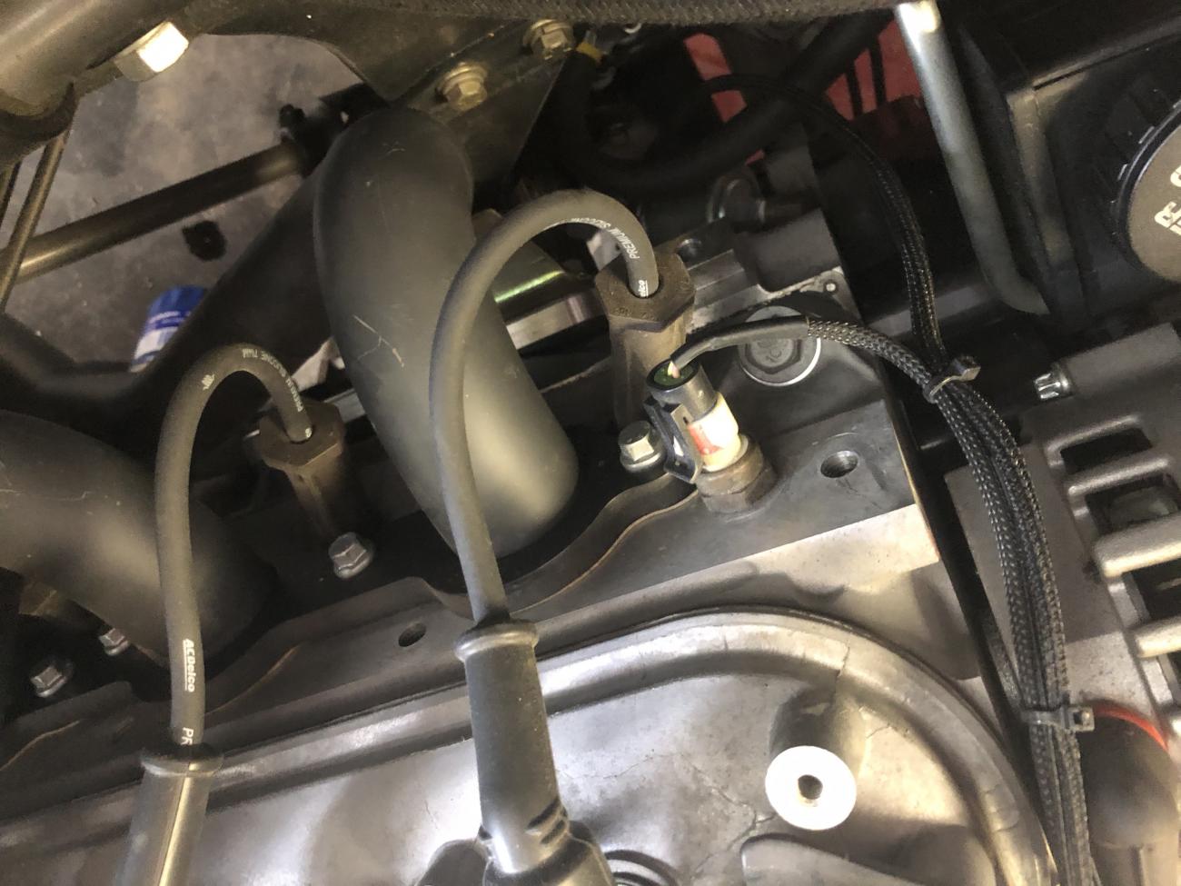

The steam is likely causing you the issue. I don't like the location for actual engine temperature either. You want to know how hot the coolant is in the engine, not after being cooled by the radiator.
