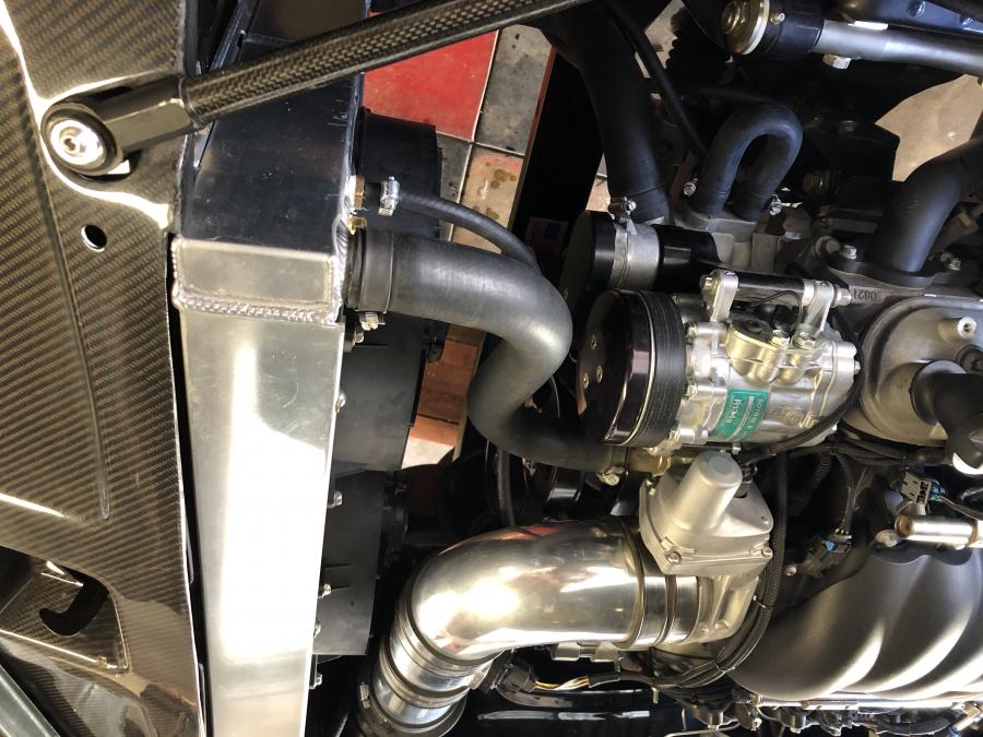

Alright maybe there is a blockage? I brought it up to temp this morning with the front end raised really high to try and bleed some air but I also put a thermometer in the radiator to see what the temps were. Whats odd is that the temp in the radiator never climbed and stayed around 80 degrees but I can fill heat in the top hose and the gauge is reading around 250.
I've ordered a new thermostat from Summit to try that option and I'm not sure the one I got locally was the right one.
Just so I can get confirmation, I have the hoses going the the right inlets right? The top one goes in, well the top one, and the bottom returns back to the lower radiator.

It sounds like your thermostat is not opening or you have an air pocket. I can’t remember if you can install an LS thermostat backwards but if you can maybe that is what is going on...
Hoses are correct.
