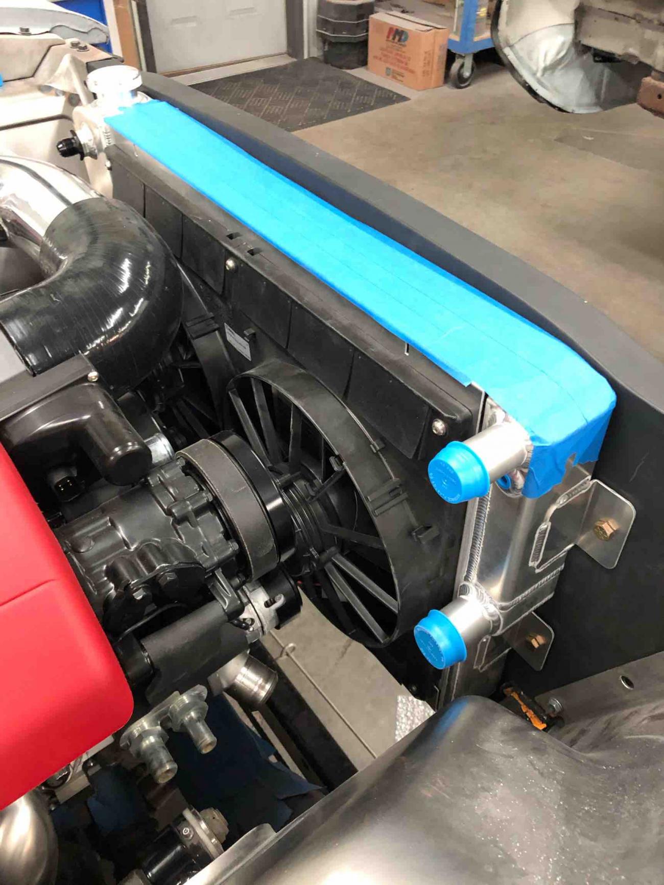

Made it over to Eau Claire last week to check out progress on the Nova. Kurt has the engine, transmission, radiator, etc. in and checking clearances all around. We’re also mocking up the path of A/C lines, oil cooler lines, heater hoses and catch can. We’re using the round II Much bulkhead for the Vintage Air EZ-clip hoses. We will use one bulkhead to route hoses from the A/C compressor and water pump through the lower inner fender near the radiator on the passenger side. We’ll route the hoses under the passenger inner fender through a second bulkhead in the firewall into the cabin to connect to the Vintage Air unit.
We’re also working on a custom air intake and intend to have a cone filter that will sit between the driver’s side inner fender and the radiator. We plan to open up the core support in that area to allow cold air to the filter through the grille.
Kurt also fabricated housings into the lower sides of the dash to mount round air vents, similar to what has been done on a number of first gen Novas built by DSE and others here on the forum. Front seats were test fit and seat brackets installed.
Once we have the air intake built and we’re finished with mock ups, the drivetrain will come out, and we’ll remove the front subframe to allow some final finishing of the firewall, and then we’ll be ready for paint. Here are some recent pictures:

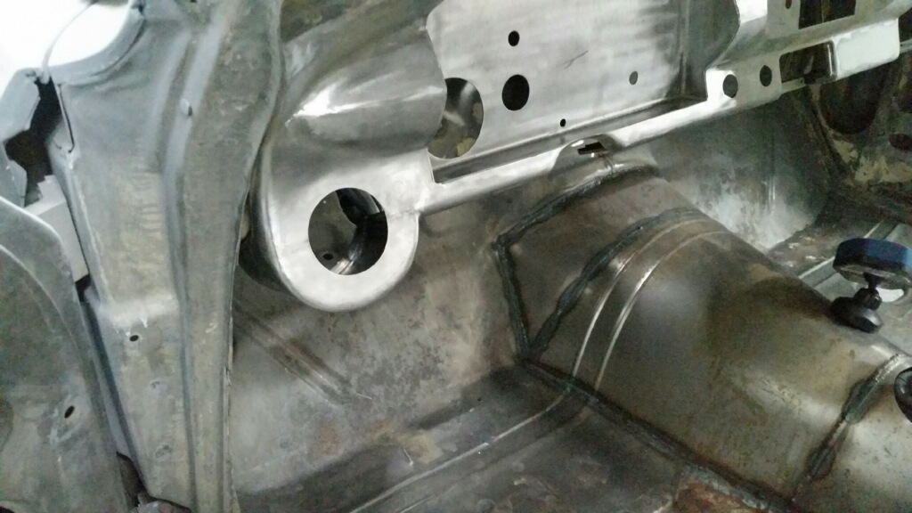

Hope everyone is doing well and keeping safe... drove over to Eau Claire today to see progress on the Nova. Kurt had the air conditioning unit installed, was nearly finished with the cold air intake, and had completed the extensions he built for the bottom of the dash. The extensions are a subtle change, but really add some needed height to the dash and do a nice job of hiding things that might otherwise be seen when looking at the dash (e.g., the air conditioning unit is largely hidden now, as is the mount for the gas pedal, etc.) We also installed the short hub adapter and mocked up the steering wheel.
Kurt also sprayed out a test panel for the body color (shark gray metallic) and trim (carbon flash metallic). I really love the colors and can’t wait to see them on the car.

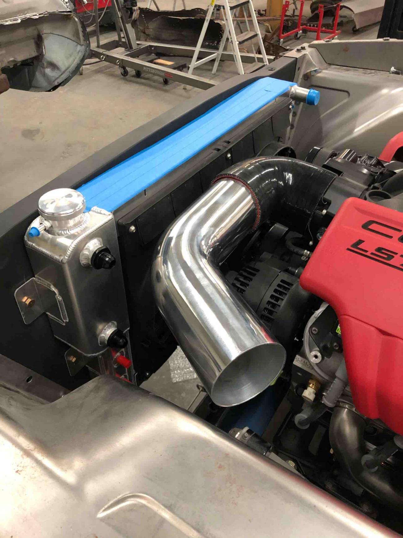

Here are some pictures of the progress. Below are some pictures of the cold air intake. We will run the polished aluminum tube through the bead blaster and have it powder coated black. In order to get the air filter past the radiator, Kurt cut a hole in the inner fender and will weld in a new dished panel to cover that hole, providing a pocket for the filter to sit into. He will then cut a large hole in the radiator fill panel providing a direct path for fresh air to the filter. The pictures below are not the final cuts - these initial cuts were just enough to allow the filter to sit into the pocket. Kurt will open the pocket up approximately 3/4” on all sides to ensure adequate air flow to the filter.
