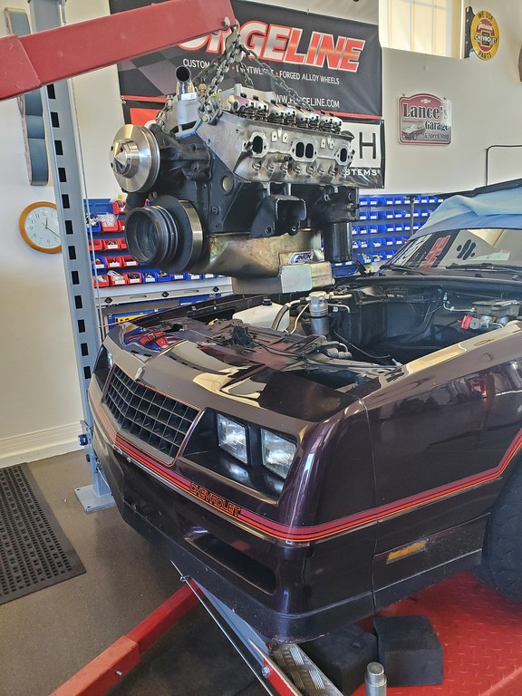

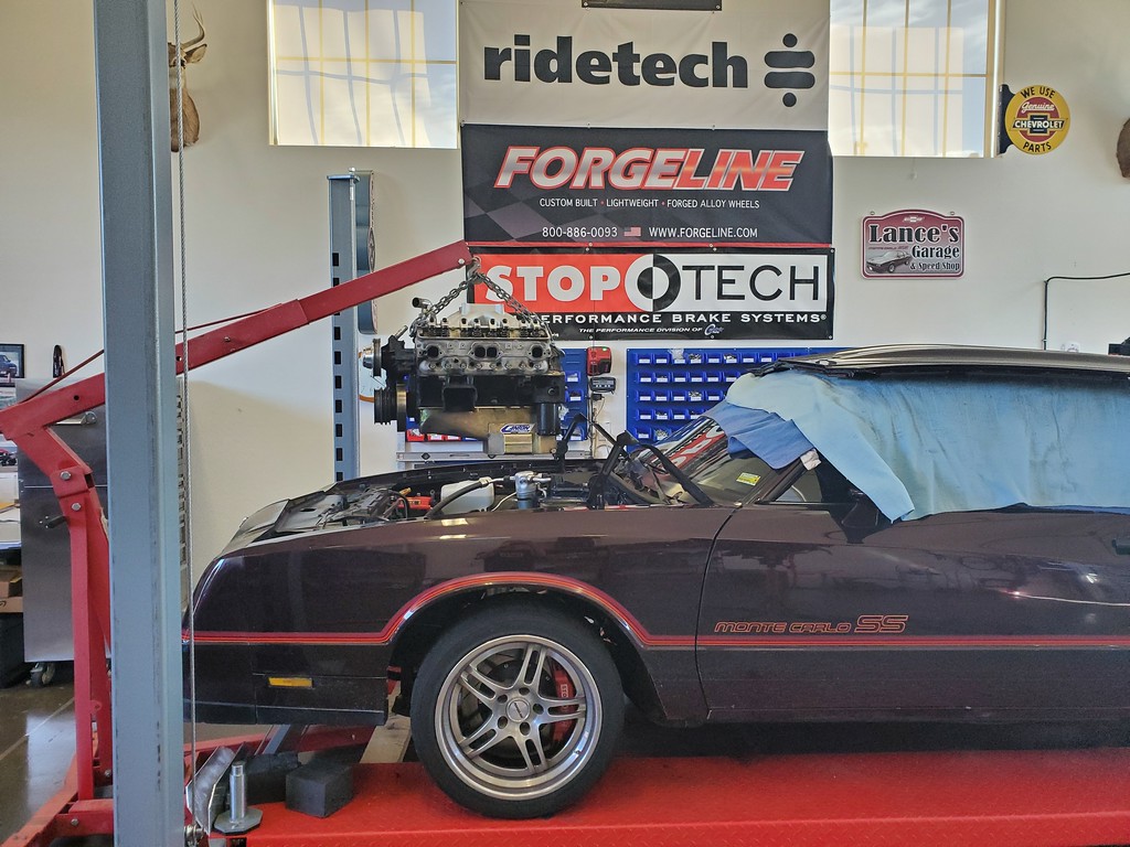

Figured out a way to pull the engine with car on the lift.
All kinds of room

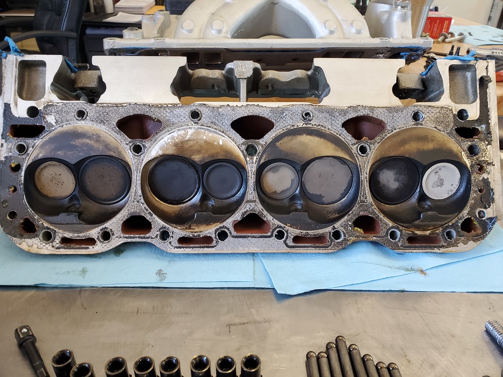

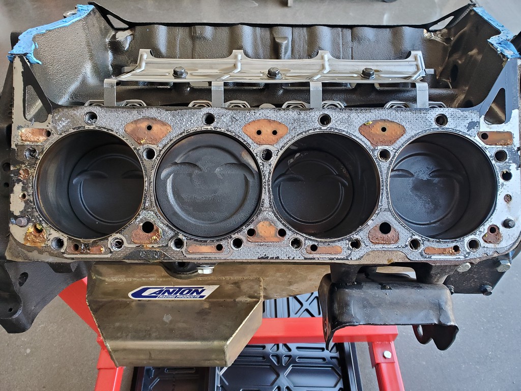

Here is passenger side head. All looks good, just a bit more oil on #4 exhaust valve.
Tops of all of the pistons look normalish as do the cylinder walls.

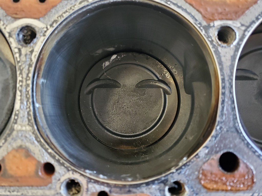

This is #4, the one in question.
Popped #4 out and found this.

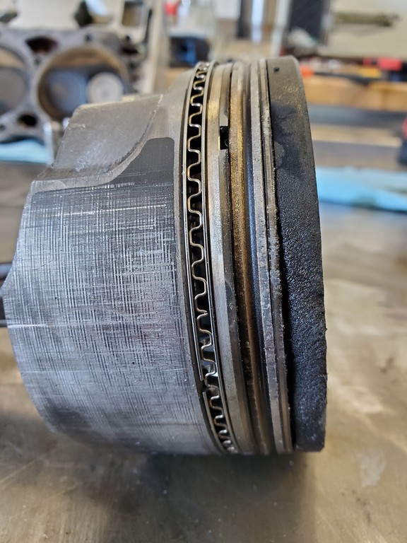

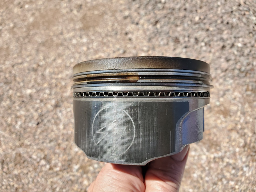

Multiple rings are broken in multiple spots and the top edge of the piston has started melting away. Hard to tell what happened first, oil ring could have failed, let oil in chamber which may have raised compression just enough to cause detonation raising temps above what piston could handle. One or multiple rings could have been just a bit tight, got a bit too hot and broke causing loss of compression. Or something with cooling system could have caused an air pocket, causing that cylinder to get just a bit hot and start the meltdown. It'll be interesting to see if any rings are broken in any other cylinders, haven't pulled any other pistons out yet.
Everything else looks excellent though. Bottom of pan was clean, cylinder walls are unscathed, head gasket looked good, basically you wouldn't know there was problem if not for that one piston. So glad I stopped when I did, that piston was one straight away from exploding.

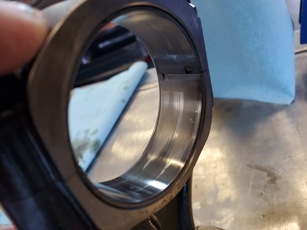

Bearings look pretty good still.

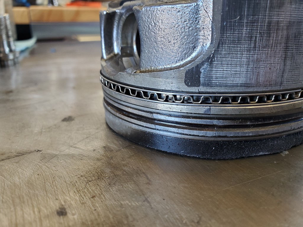

Spent a week or so investigating, diagnosing and soul searching. One thing I found changed the direction I thought i was heading more than anything else.

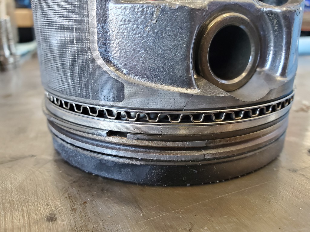

When I pulled the rest of the pistons out yesterday, I found this broken ring land in #8.
Everything else about that cylinder was normal as could be.
This tells me that the top end we put together simply outpowered the bottom end and the weakest link (cast pistons) is what gave up first.
Since the block is a 4.005" bore, there is no forged off the shelf piston that will work with it, so machine work it is. This actually helps though because now I can do the machine work to match the parts I pick out...instead of the other way around.
