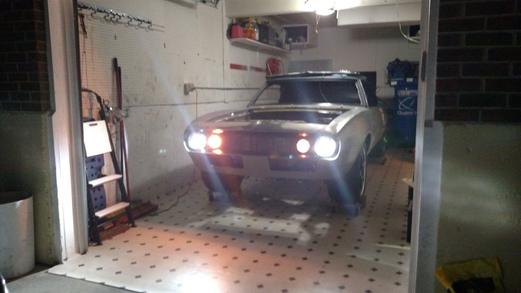

Cool It's the small things ...
Heck Yeah!!
Thought it looked cool w lights off .... thanks!
I dig the blacked out too as well. Good job!
Yeah it will tie in the front end great ... thanks!

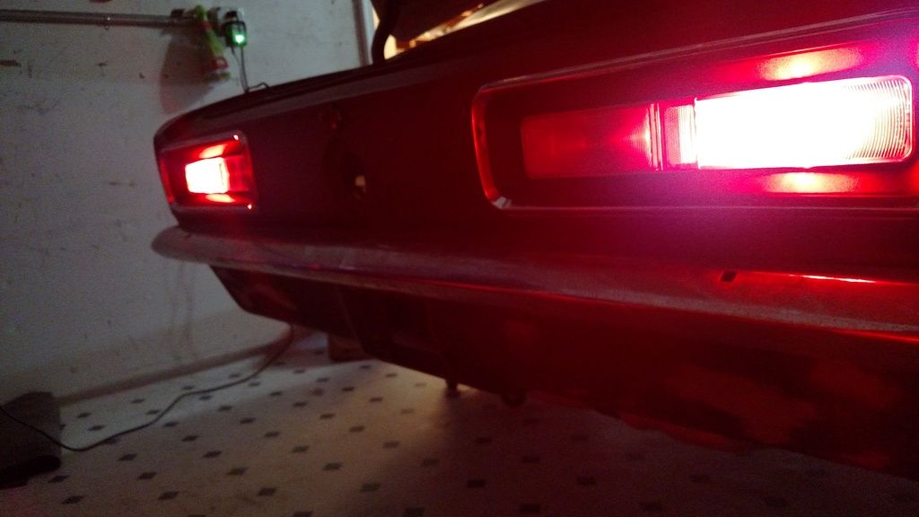

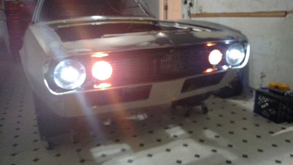

Winner Winner chicken dinner ... thanks Shane for the tip, went to Youtube and found an AAW video concerning their [chinese] made switches and it worked ... APITA
It's good to hook up your battery and find out you wired the circuits correctly, no fuses blew and lights came on ... yeah. So I put the taillights in to make sure all was ok and BAM they worked also, hell yeah.
The headlights are not adjusted of course but WOW the Dapper Lighting LED 7's are bright. couldn't be happier, well I could if I had an LS3 525 hp installed but that's another day, right?
A win is a win ...

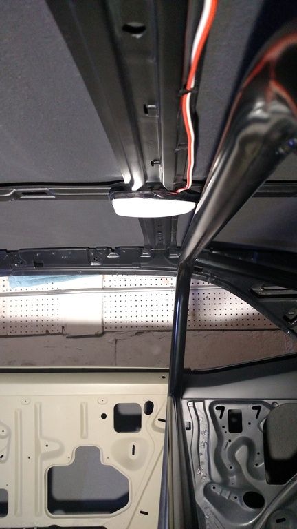

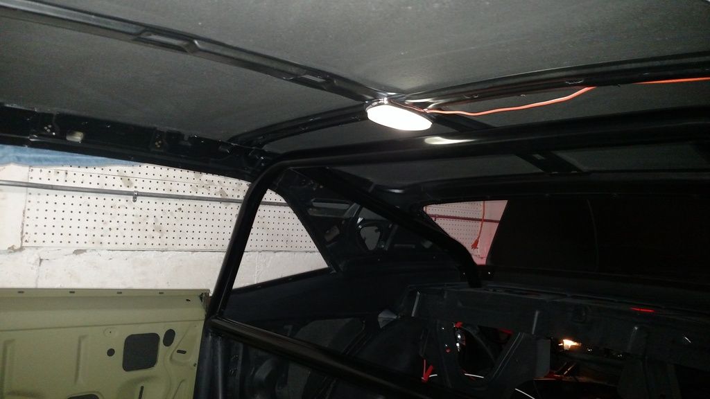

Can you tell me the roll bar distance from the hoop to the roof cross braces, please my welder seems to want to weld on my car, so I have a list of things for him, hehehehe,

It's good to get some quality time with the car ... as far as the roll bar question see attached picture, the top bar is not under the cross brace cuz the angle I installed the bar. But, to answer your question the top bar is 1.75" from the center roof brace to the top of the bar and closer to 1.5" out to the down/ trunk bar.
