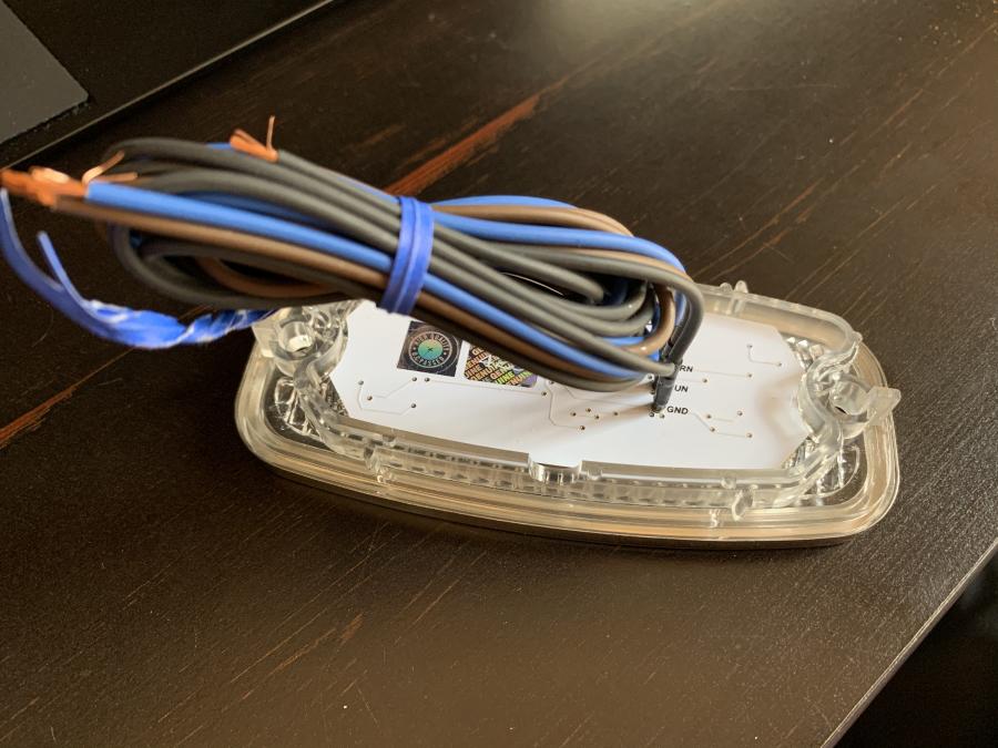

Hi
I have recently ordered Digi-Tails LED parking light for my 68 camaro. I have realized that the LED circuit board supplied by digitails look different than the what i advertised and the installation instructions came with the kit are for the older deign.
As per Digitails, the design has been revised for better sealing and the board design is smaller compared to the older one.
My concern is that if any vendor revisit the design of their products, I believe they should also need to update their installation instructions.
I am having a bit of difficulties on how to center and align the LED board within the light housing.
Would appreciate if anyone has recently purchased the new design of LED boards and could share some photos

At the beginning I was having some difficulties to center and align the LED board within light housing due to smaller size boards compared to the previous design, but yesterday I got it all figured out.
However, when I wired up the parking lights, the little green indicators for the turn signals/hazard on the classic instruments cluster come on and stay on when the parking light is turned on. When I turn the hazards or the turn signals on, the dash indicators blink at a higher intensity like the parking lights. It is strange.
I did replace both the flashers with LED flashers and not sure why this is happening.
This phenomena happened just when I had installed Digi-Tails parking lights.

Thanks for the offer Randy but I live on the other side of the world. Just an update on what I am planning to do and what I have done so far:
I received my new parking light gaskets ( rubber type). Even though Digi-Tails claimed that the LED board design had been improved to a smaller board to prevent the gasket from covering/blocking some of the LEDs around the board boundary. Unfortunately, this is not true because I had to trim the part of the gasket that blocked the LEDs.
Digi-Tails customer service sucks as well. They responded only once to my queries , and have not heard from them regarding other queries.
Regarding the indicators on the gauge cluster, I am awaiting the LED flashers with ground wires and see the results afterwards.
I wish I had bought a good quality LED bulbs instead of going though the hassles with Digi-Tails

wow this came up just as i started working on mine and am having the exact same mounting issues? how did you center attach and have the gasket not block any of the led's?

Do you have any pics? I have digitalis in the front and rear of my car.

So before they used to extend all the way out to the screw holes. Now they just kinda float. The rear sucks too because it is so far off center it makes it hard to move them around. And finally when I put the gasket on it blocks a whole row of leds.

Can you wrap the gasket around it? Would that hold it?
