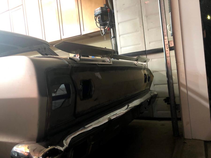

This is a picture of it sitting on the deck lid. This isn’t the actual mounting position, but gives you a sense of width of the spoiler and size on the deck lid. The spoiler will be painted the same black as other trim on the car.

Just got my RB spoiler today curious to see what you do. I was looking at it a different way hmm...
I’m planning on positioning mine similar to the way Ring Brothers mounted it on their Mustang, not as it was sitting on the deck lid of my car in the pictures (i.e., so it looks more like a duck bill spoiler than a blade and the hinges will be visible). How are you thinking about positioning yours?

Here is what I was doing a little different and lower down on trunk.
Thanks for sharing - that actually looks really good in that position. The Ring Brothers Mustang has it mounted lower on the deck lid as well, I just wasn’t sure how it would look on the Nova. Yours is flipped 180 degrees from the way Ring Brothers mounted theirs - allows the blade of the spoiler to be higher and more prominent. I could see mounting it as you have shown, or, potentially, higher on the deck lid (before it starts sloping down) and flipped 180 degrees from yours... wish I could actually experiment with it. Due to COVID restrictions, I haven’t been able to see my car for weeks, let alone the new spoiler!
