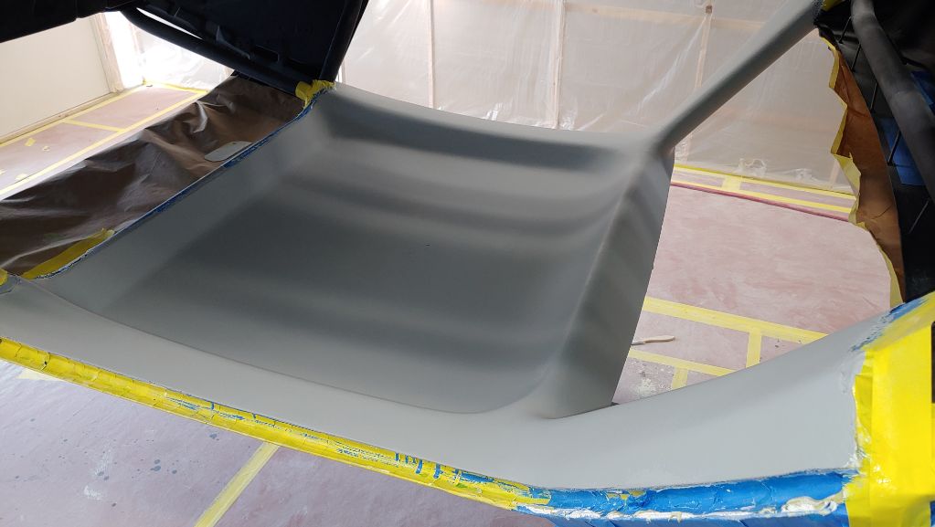

Originally Posted by Goosesdad View Post
One layer of 3/4oz and one of 1 1/2 ounce mat.
Attachment 72103
Even with a skim coat of filler, the whole headliner shouldn't be very heavy, it's pretty thin - if the filler made it to heavy, I take a splash mold of it and make a new part so there is no filler at all. It'll get covered with suede later.
Attachment 72104
A layer of primer to insure the shape is uniform. I'll cut it all out this weekend.
Attachment 72105
I oversized the mold in the front here just to help with shaping this area. This will obviously get cut back to fit nicely to the windshield.
Attachment 72106
I'll put the seam at the top of the A Pillar.
Attachment 72107
Attachment 72108
I really like this! It makes it look much more OEM!
