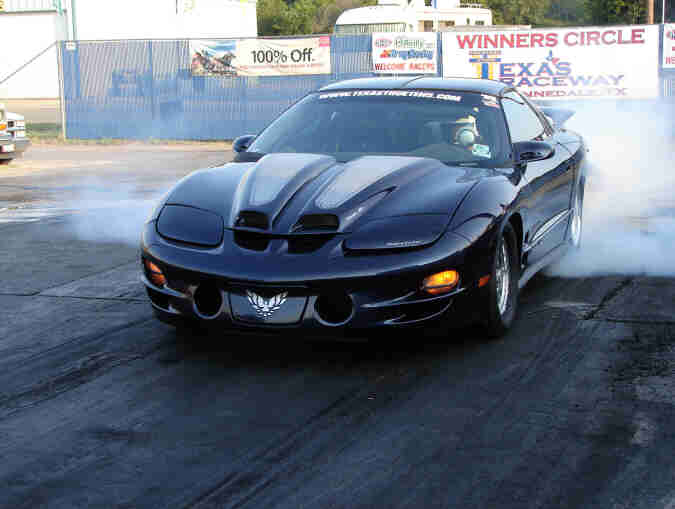

I have a 6.0 ltr iron block in the 99 T/A in the attachment below. It makes 500 RWHP N/A and 750 RWHP on the bottle and runs 5.9X to 6.0X in the 1/8th all day long. The difference in weigh of the blocks at this RWHP level is negligible. I went with the iron block because I can throw as much nitrous at it as I want and don't have to worry about hurting the motor.
