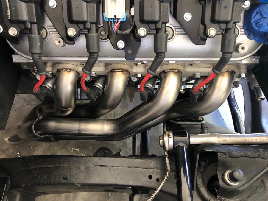

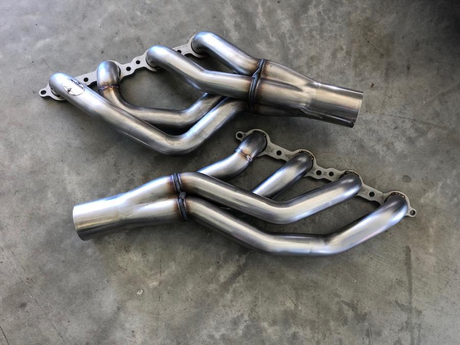

Some shiny stuff showed up today
Hooker 1" 7/8 Mid-Length headers

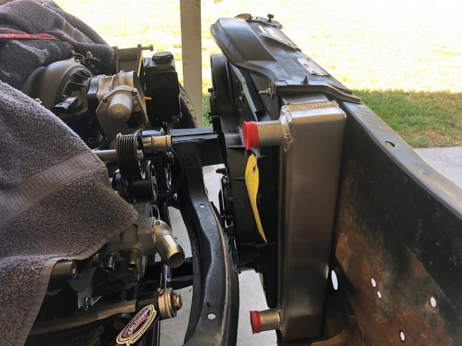

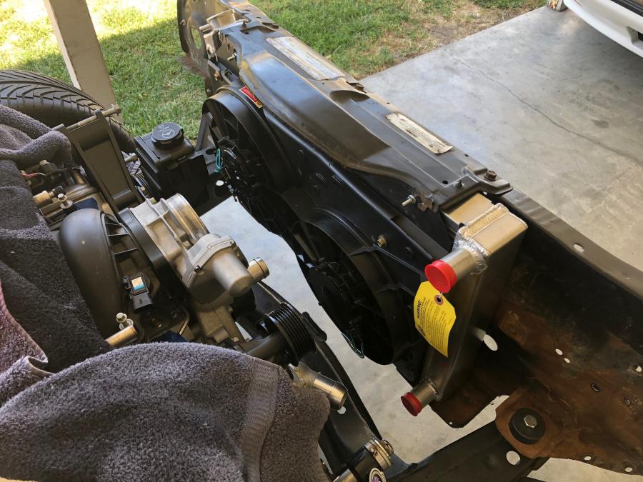

Although I got side tracked by a couple other projects, still pushing forward with the Nova.
After a bunch of research, I ended up with a Be Cool radiator. I like that they moved the cap to the drivers side. That will make routing the catch can and LS steam line easier.
For fans I went with a Ford Contour setup. I like the oem fan setups for reliability and noise level. This also calls back to my foxbody mustang experience

John-what factors led you to choose a Be Cool radiator?
Like I mentioned above, it's actual made for a Nova. I returned another name brand radiator that was labeled to fit "x-body". It was really a camaro radiator... I would have had to adapt the nova to flange mount
I like the radiator cap on the passenger side. I'm planning to keep the battery up front and the AC components are over there too... so not a lot of room for the catch can. Lastly, I like the LS vent tube on the drivers side, although that's not as big a deal.
Last part was the fan setup. This radiator provides a core area big enough for the dual fans. Most "Nova" spec LS radiators are narrower cores. I would have ran a mark VIII singe fan in that case.
I seriously considered a "Summit" branded radiator, but they were back ordered.
*forgot to add.. the Be-Cool radiator is a beautiful piece! Very impressed with it.
