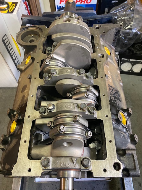

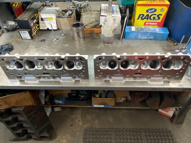

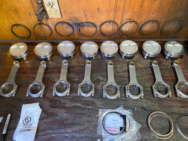

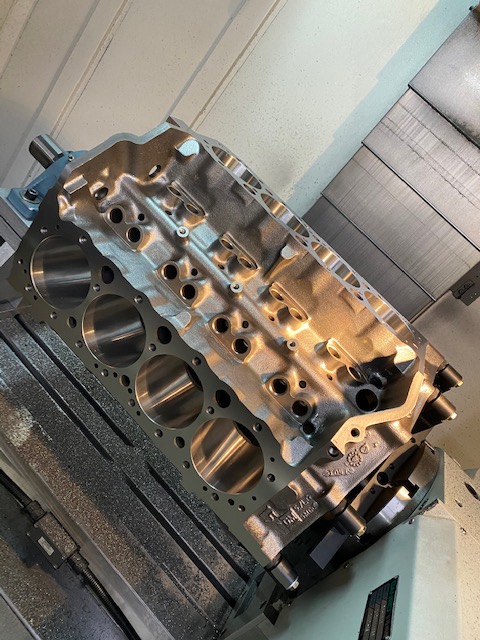

I ended up pulling my engine in late May. Most summer events were cancelled and I didn't have any good reason to wait until this winter.
I decided to go with a local machine shop/engine builder to have another 383 built from the ground up. The new engine will have a roller cam/lifters, forged crank, forged pistons and will be internally balanced.
The builder sent me a few photos. Hopefully, assembly will start later this week.

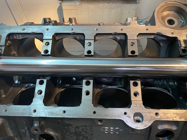

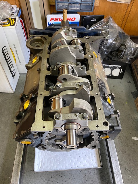

Default Getting closer
Slowly but surely...
Daniel

Now that's a sexy post!!
Curtis
