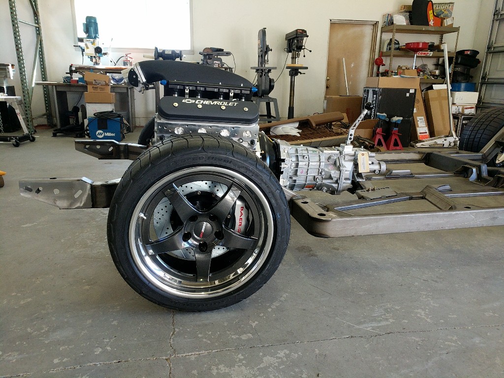

Got the Baer brakes yesterday so I did a quick mock up so I could get the front wheels on and the chassis on the ground. Everything fit perfectly, no drama or "hotrodding" required.
Next up I'm going to pull the body off and get it on a rotisserie to do the inner tubs and cut the tunnel for trans clearance. Then get the body on the new chassis and finalize engine placement with the adjustable motor mounts.

Sweet Jody!! What are your wheel specs?
x2..... And Tires? Looks like 315/335's?

Wheels are 18x9.5” w/5.875”bs front, and 18x12 w/6.25” bs rear with a 57" rearend.
Tires are BFG Rivals 275/35 up front and 335/30 rear.

Love the wheel design. Simple yet stylish. Not to mention FAT! Good lord those rear tires are wide.
