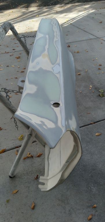

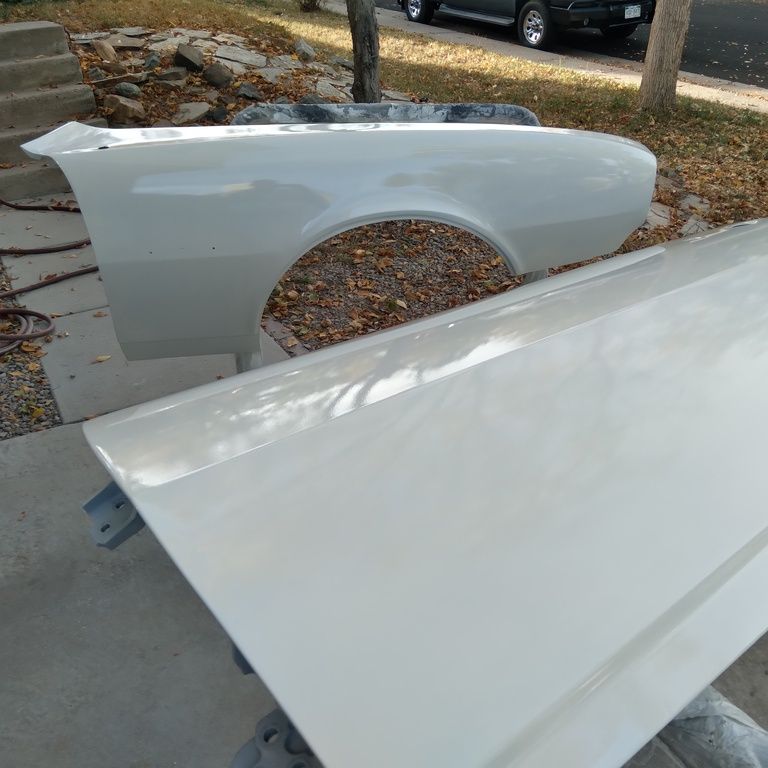

Grit er Dun .... sanded the underside one more time and epoxied and then sprayed some ss black, heck yeah!!!
The hardest thing is keeping the ash off the fresh paint, APITA!!!
Thanks for looking ....

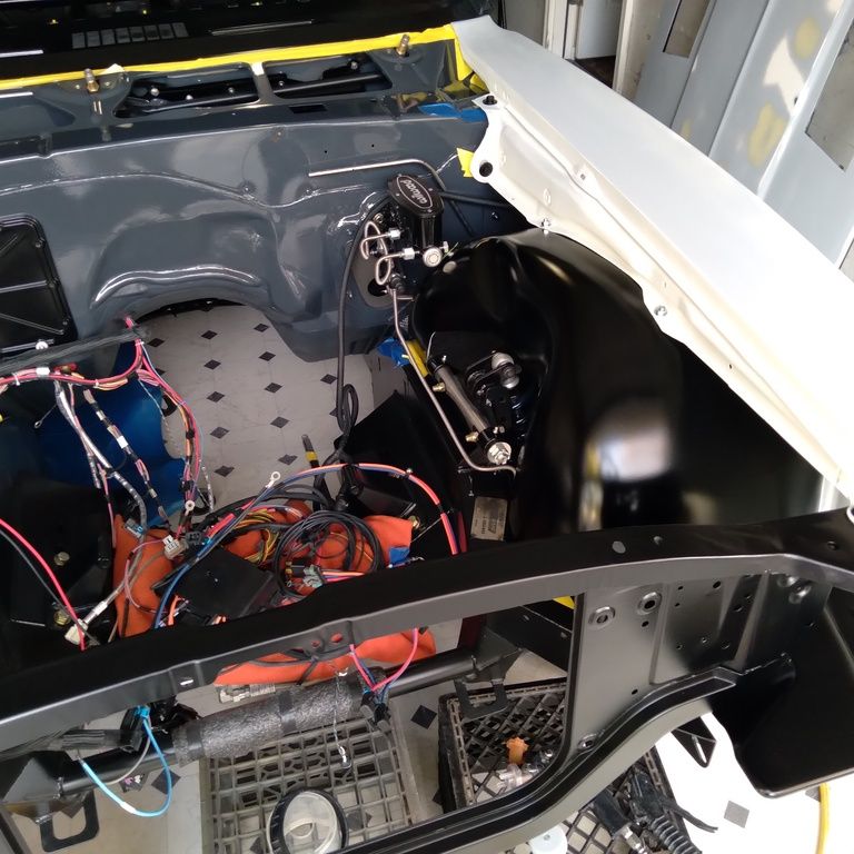

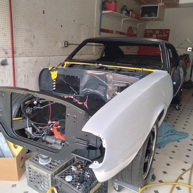

Well make a goal and Got the radiator mount painted a single-stage black along with the Speed Tech inner wheel wells and then mounted driver's side to see what interference with the clutch master cylinder ... needs a hole to clear master and AN3 fitting.
Looking like a car again ...

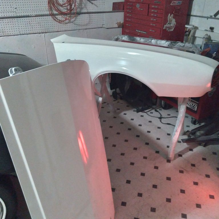

While the weather was good I got some putty on the fender and sprayed some SPI epoxy on the driver's door and passenger fender and left in the garage with a heater on overnight to cure the paint ...
Still needs a layer or two of primer/ surfacer and sand down w 400 grit!
Hopefully I'll get the door hung and semi straight before long and then get the rest of the front end sheet metal installed and aligned.
