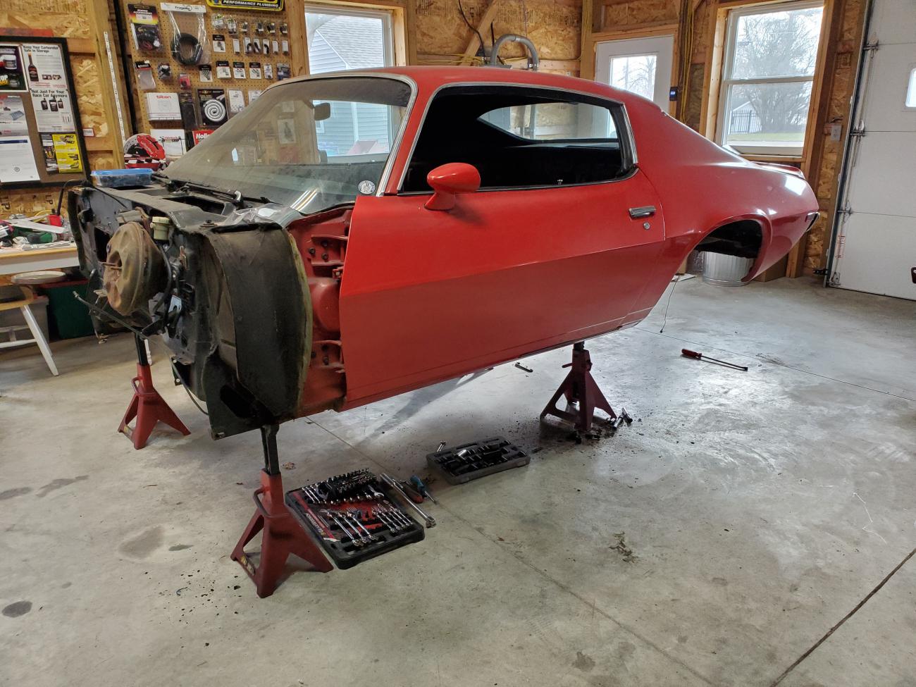

Not as much as I'd like. Been busy putting a SpeedTech setup and an LS9/T56 in a '70 Camaro. A lot of fun, but also some headaches. Since GM doesn't support the LS9 anymore you have to rely on the aftermarket and everything is expensive for them.

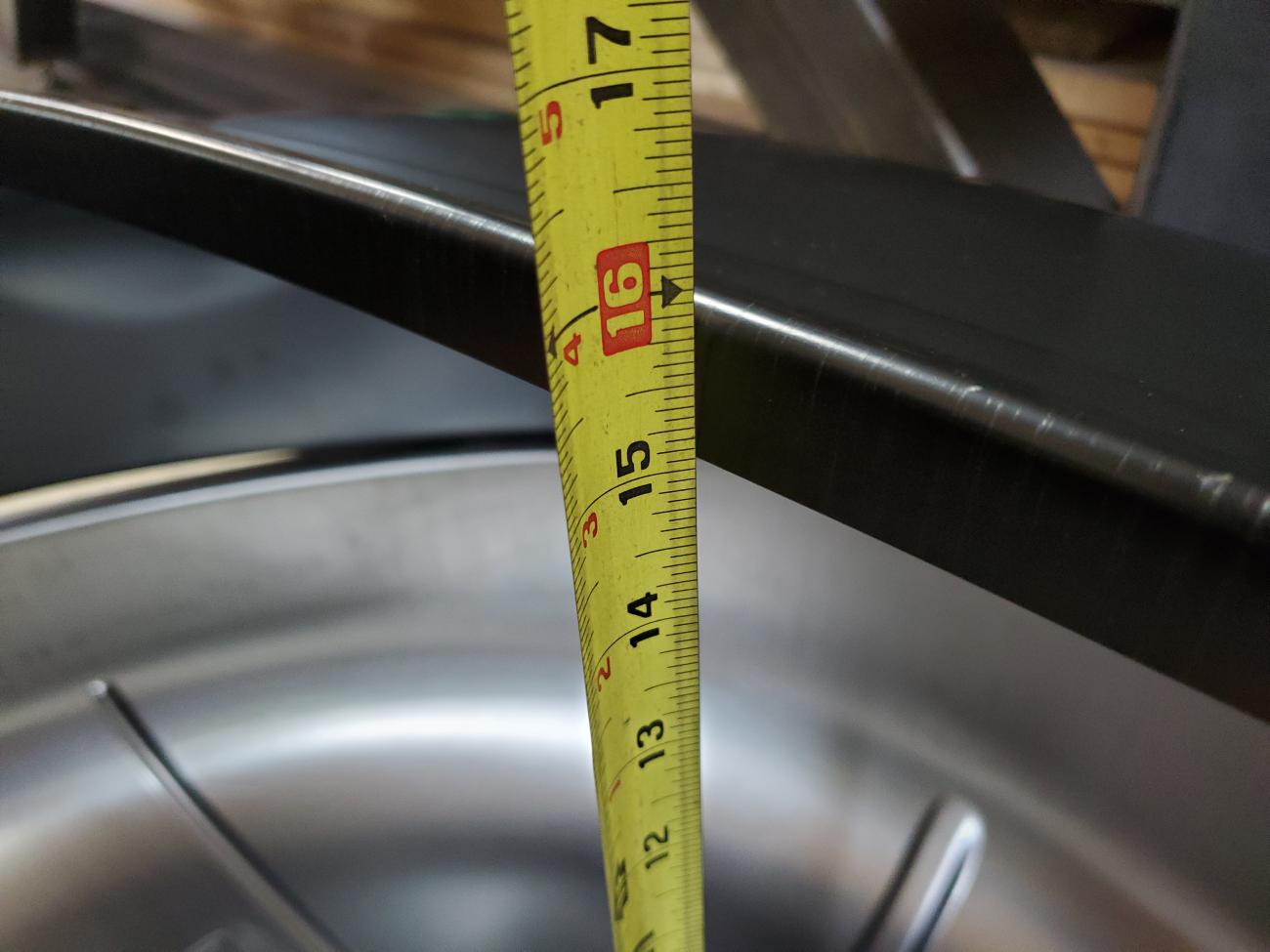

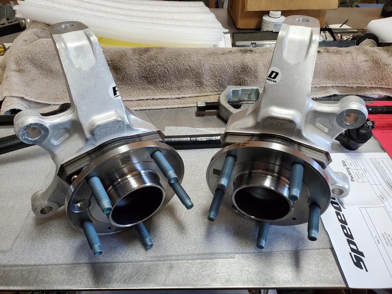

I have been still collecting parts for the Chevelle. I bought a set of Mini-Tubs from Tony at ABC Performance, this will give me almost a 15" deep wheel tub in the back for plenty of tire clearance. I also bought the SpeedTech ATS Spindles and bump steer/ackerman kit. Those are very nice pieces. I've also started collecting pieces the dry sump setup on the engine. I really wanted to do a Dailey, but by keeping the stock front crossmember and steering linkage, their pump is mounted too low and would interfere. So I'm going with an Aviaid system with their Series 2 pump. I decided to upgrade my 12:1 Turn One box to a 10:1 and have a few more pieces tacked on the the chassis. I have some ideas floating in my head about the intake system on the engine. Since LS intakes are symmetrical and can run them backwards, I'm thinking of blocking off the kick vents since I'll have Vintage Air and then use the air box in the cowl area as a cowl/cold air intake area. Just have to figure out how to work around the wiper linkage...

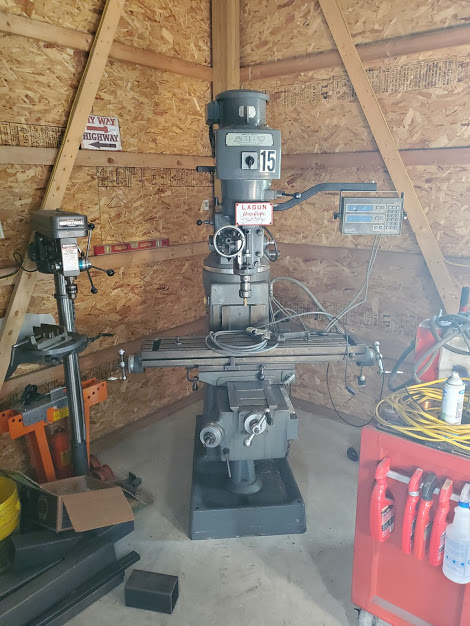

I have also picked up a new tor for the shop, an old Lagun, should make a nice little mill for making custom pieces on the fly. I just ordered a VFD for it this weekend so it should be up and running soon.
