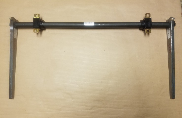

Just to follow-up.... I purchased a 1.25" x 37.5"L x 48-spline bar w/the 1.25"x 18"x .750" 48-spline arms, 1.25" collars, & end-caps.
Plan is to trim the arms to a 10" length & drill 3 holes to allow for some tuning (@ 7", 8", & 9" from the bars center-line).
I appreciate the feedback that was given.
