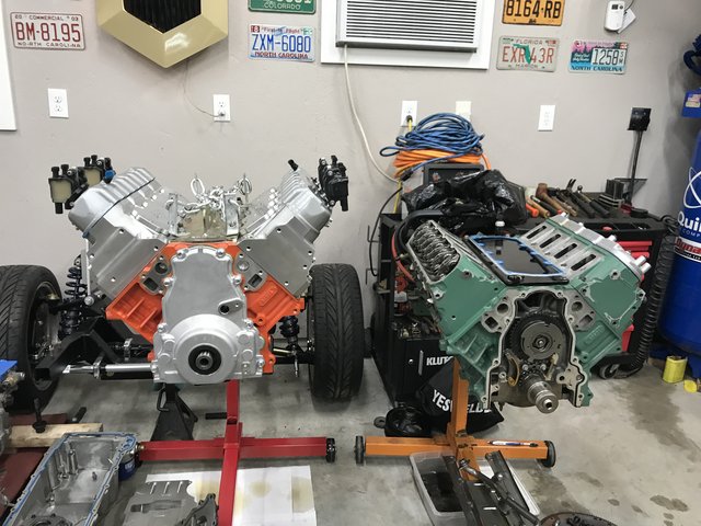

I was real excited when this crate arrived.
This is a Blueprint engines 427 LS. 625HP and 565 ft. Lbs of torque. I’m using their long block so I could select the external items to fit my needs. Its a LS3 based stroker that has an all forged bottom end, Mahle forged pistons and rings, ARP rod bolts, Melling oil pump, and 12 degree 255 cylinder heads that rotates the valve angle from the 15 degree angle of the standard LS3 to similar to the LS7.
The old and the new.

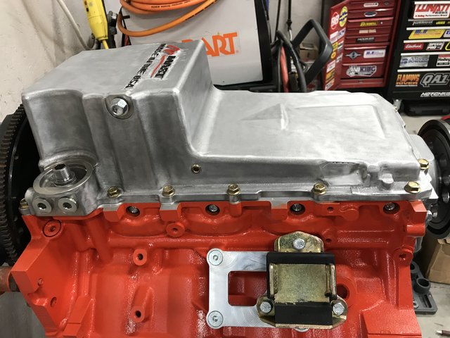

The one thing I missed during mock up that caused lots of head scratching and some challenges to overcome was the oil pan. I had a Holley 302-2 oil pan I used to mock up and it fit great. The longer stroke of the new engine didn’t clear the pan. The new Holley pan 302-3 is good for up to 4.00” stroke but I am at 4.125” stroke. The original Holley pan 302-1 would work for the engine, but the sump is too deep for my liking and hung below the cross member. In addition the front of the pan was to deep for my steering rack. So after looking into lots of oil pans I selected the Mast Motorsports stroker pan. I prefer the cast pans and it had all the clearance I needed or so I thought. For those studying oil pans here is a comparison to the 302-2 Holley pan.
The Mast pans have those kick outs in just the right places to clear the rods. I am using their pickup and windage tray as well, all designed for the longer stroke. The only thing I didn’t like about the pan is the cast in baffles but no trap doors for oil control. I was using the Improved Racing baffle trap door assembly in the Holley pan and I really liked it.

When I test fit the engine and the Mast pan I created a new clearance issue. The left front portion of the pan didn’t clear a steering rack fitting. I had to cut out a small notch and create a piece to go back in place to clear it.
Before shot.
After shot
Next up was to create a trap door baffle for the pan. I started by cutting out the cast baffle in the pan. Then I started with a Improved Racing baffle for a Holley pan. The first issue is the Mast pickup is clocked 180 degrees opposite of the Holley so this meant the lower part of the trap door had to rotate 180 degrees as well.
Here is what I started with.
Here is the Mast baffle laid over the Improved Racing trap door.
The pickup difference. Mast on the left, Holley on the right.
And here is what I ended up with. It took way to much time to make this piece.
While fitting the pickup I decided to make the little hold down to use the second bolt on the oil pump. You can buy these but I was ready to button up the pan and didn’t want to wait so I made this one out of some scrap metal.
Before buttoning it all up I ran the Pan, and baffle through the dish washer to give it a good cleaning. Since it was not oily the wife approved. She has gotten used to parts coming into house for various reasons over the years.

The Speedway motor mount plates that attach to the block position the motor really well but they are made of steel and felt very heavy. The other thing I didn’t like was they used some separate spacers to position the actual motor mounts. This is just a pet peave but I hate have to line up bolts, spacer, motor mounts, and engine plates. So I decided to make some lighter weight ones out of 6061 Aluminum to save weight and incorporate the spacers in the design so I don’t have to worry about them falling out and rolling off when taking things in and out. Also saved 2.8 lbs ! My oldest son is a CNC machinist and enjoyed the challenge. He did a great job. This is probably the fifth or sixth set of LS mounts he’s made for me for various projects.

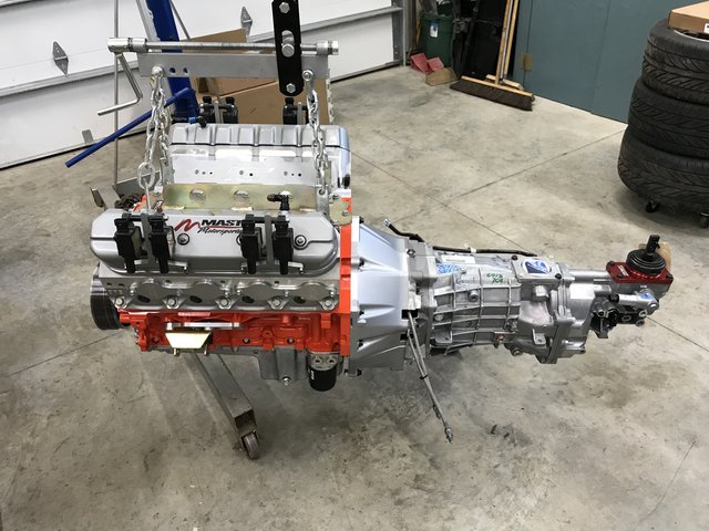

I was able to reuse my flywheel clutch and throw out bearing as they didn’t even have fifty mile on them. I am using a GM LS7. I checked the flywheel for runout and checked the bell housing alignment using a Bowler test fixture.
I made a little trip to the other side of Illinois to pick up this.
Tremec T-56 Magnum-F six speed from Bowler Transmissions. Thanks Mark and Tom.
Using a Summit Racing SFI harmonic balancer (4th gen F-body spacing)with ARP bolt.
All bolted together for the final install I hope.
