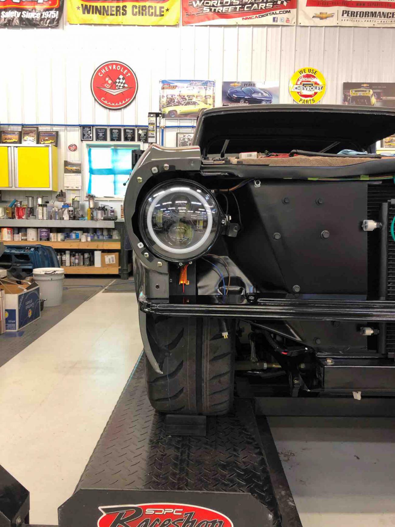

Made a trip to Eau Claire recently to meet with Kurt and check out some nice progress on the Nova. Wiring is basically finished up, but for a few items that will require mock up of center console (e.g., power window and lock switches). Kurt got the Vaporworx PWM fuel pump module mounted in the trunk (wiring is nice and tidy), along with the battery and the II Much fuel vent.

The headlights are also mounted and wired up. These headlights are LED units with halos. The halos shine white most of the time, so they serve as daytime running lights when headlights are off. When the headlights are on, I can either leave the halos on or switch them off - I have them wired to a virtual switch on the Holley pro dash. When turn signals are activated, however, the halos shine amber and blink with the turn signals. Pretty cool, and excited to see them in action.
Attachment 73198
Attachment 73199
Attachment 73200

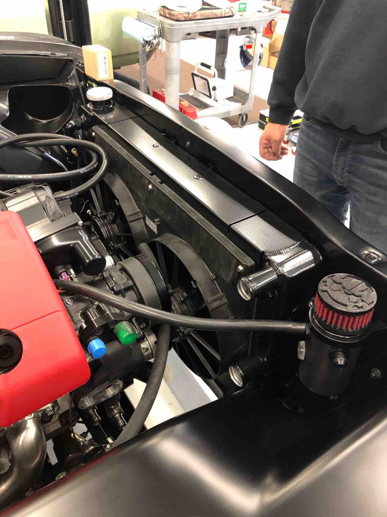

We also got the radiator back from powder coating and it turned out great! We powder coated the tanks, top, bottom and sides. The fins weren’t powder coated in traditional way, but coated in a very thin coat of similar color to ensure no degradation of thermal transmission of the fins. We still need to deal with the radiator cap. We didn’t want to coat the cap as it has a rubber gasket that we were concerned about putting in the oven as part of the curing process. Instead, we’re going to have the cap coated with Cerakote, a product similar to a powder coat, but thinner and can be air cured rather than oven cured.
Attachment 73201
Attachment 73202
We also got the catch can mounted. Went with a Mighty Mouse catch can. Will connect via a -8AN adaptor on the valve cover oil filler. We had to modify the fuel rail cover - drilled a hole and will connect a 90 degree elbow fitting with push lock hose that will connect to the catch can. Other line out of the catch can will plug into nipple on the intake manifold.

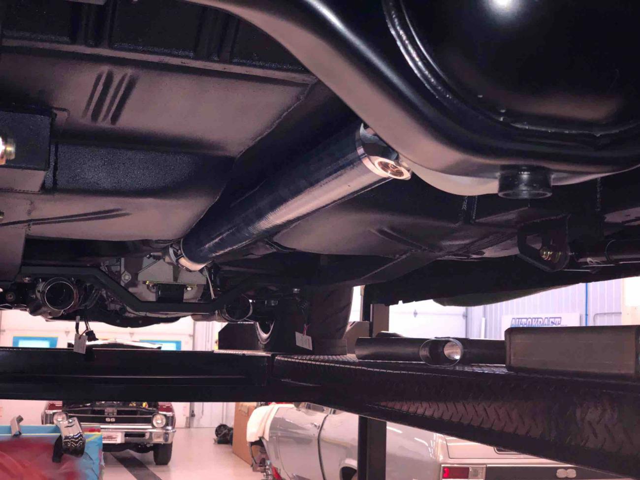

Kurt had moved the Nova on to a four post lift as we’ll be working on the exhaust next. Was cool to get under the car and see some of the work close up. QA1 carbon fiber driveshaft installed, and good look at the aluminum center section 9 inch rear end.

A couple of under car shots where you can see where we will run the exhaust from the headers...
For exhaust, I’m using Spintech oval tubing from the headers to an X-pipe to their 3000 series mufflers. The oval tubing is 3 1/2” wide and 2 1/4” tall, and the equivalent to 3” round tubing. The oval tubing will give us a little more ground clearance to tuck the exhaust up tighter to the floors. The mufflers are oval inlets and 3” round outlets. The round tubing will exit the mufflers and go over the rear end, angle toward the back corner of the rear of the car (the fuel tank has clipped corners) and will exit near the rear bumper. System will be Tig welded together but for a handful of V band clamps to take it off in sections. Once completed, we’ll coat the exhaust black. You can see one of the mufflers, the X-pipe and other oval tubing in the photo below. The exhaust components are sitting on lift in front of the rear tire.

I like the idea of the air flaps installed in the shroud. Is there anymore info in your thread on this idea? Great build info BTW, great information.
Thanks! The air flaps in the shrouds are just part of the standard Spal shroud system. The fans are part of a dual 11” unit, with each unit having three air flaps above and three air flaps below, the fan itself. Makes all the sense in the world to have those flaps so air can move freely through the shroud when you’re at speed and the fans aren’t running.

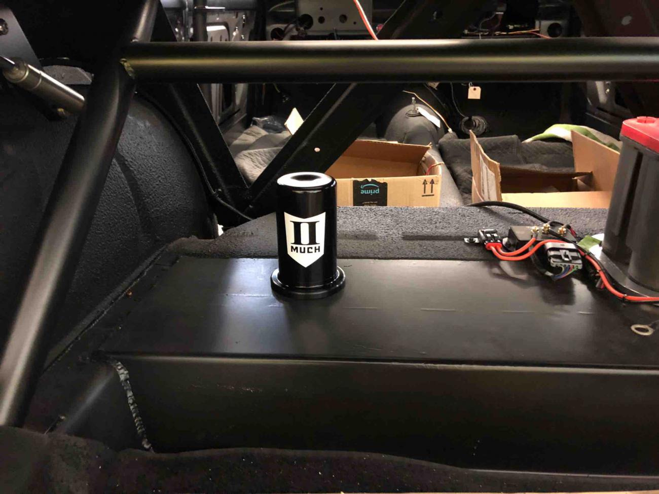

Thanks for the kind words... my plans for the interior aren’t too crazy. I’m aiming for an interior that is a nice balance between function and good looks, but also some cool subtle details.
My first objective was to get rid of the stock gauge pod and replace it with something more fitting of a pro-touring car. I considered fabricating a new gauge pod that could hold an assortment of proper analog gauges; however, there isn’t a lot of space in a first generation Nova dash. I decided to incorporate Holley’s new 12.3” digital dash, which offered the ability for various dash layouts, all with the swipe of a finger - you can swipe between dash layouts by swiping the touchscreen, just like a smart phone. I was able to customize my dash layout by adding digital gauges and read outs to reflect whatever info I wanted to display that was captured by my Dominator ECU, or that I fed into the digital dash. Below is the base layout that was embedded in the dash. I had a graphics designer modify the template by changing the boost gauge in the Holley template to an oil temp gauge (cost $50 on Etsy)...
We fabricated the dash to mount the Holley digital dash in place of the stock gauge pod...
Replaced keyed ignition with push button start and keyless locks, similar to newer cars (digital guard dawg)...
Front seats are Recaro LS-C seats from some model of early 80’s Volkswagen, which were rebuilt and recovered in black leather with diamond pattern.
For backseat, I’m using an early 2000’s rear seat from a BMW 3 series, which fits very nicely. Almost perfect width (the photo below doesn’t show the panels that cover the wheel wells and will need to be trimmed a bit)... purchased on eBay for $175... Interior shop will recover the rear seat to match the front seats (I purchased an extra hyde of leather from the guy who did my front seats in order to match the rear seats)
We’re building a center console to house A/C vents, vintage air controller, power window and door switches as well as cup holders. The console will look somewhat similar to the one in this very nice ‘63 Chevy II.
Momo steering wheel that I had recovered in same leather as my front seats, and added red stripe at 12 o’clock, as well as red stitching...
I’m having custom door panels made by the interior shop I’m working with... again, nothing too crazy, but will incorporate arm rests into the door panels. The headliner is black suede and the center console and door panels will be some combination of leather and suede to match the seats and headliner. I’m also using Clayton Machine Works door and window handles, and pedal covers; as well as matching shifter and steering column levers.
Will add custom black carpet and some black anodized sill plates. The stereo and amp will be mounted in the trunk behind the rear seat, completely hidden and controlled via RF remote. Speakers are mounted in the front doors and rear package shelf, as well as an 8” subwoofer mounted in the trunk. Thanks!
