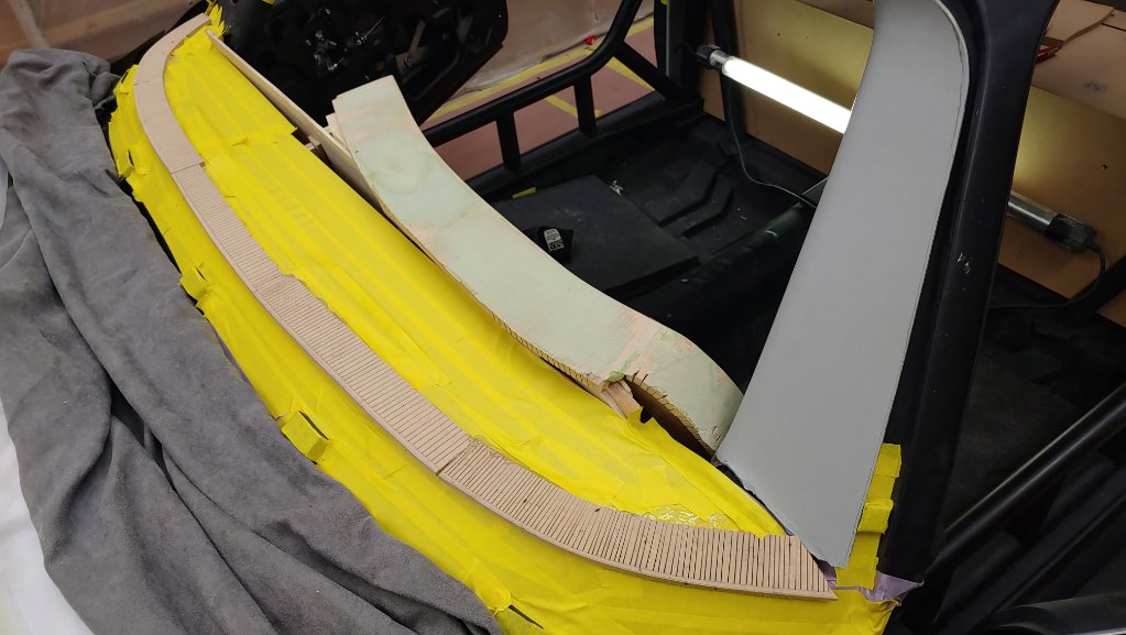

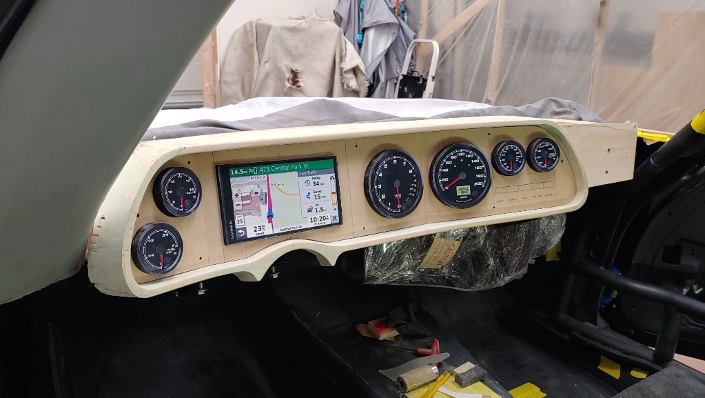

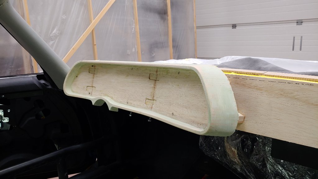

Didn't have huge progress this weekend but some...! Keeping the plug so there are reliefs for the mold and keeping proper gaps for the dash wrap material (leather or alcantara) along with the insert for the gauges....just time consuming.
Mock'd up some gauges (mdf painted black with color printed gauge faces) just to get the feel of the layout in 3D. This insert will likely be carbon. Not sure yet. Of course all of this wood is just mock up for the fiberglass mold. Lots more to come.
Started the front edge of the dash, will build it back to the gauge cluster next.

Damn your practice gauges had me fooled, having them like that gives you a great sense of the final piece. Nice job.
