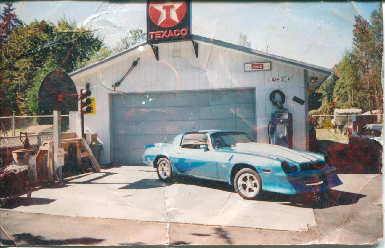

If it was a 4 speed car like I have A 1979 Z-28 with a 377 500 HP small block Chevy with a Super T-10 /3:42 gears .But with an overdrive trans you can get away with a higher gear ratio if you wish
