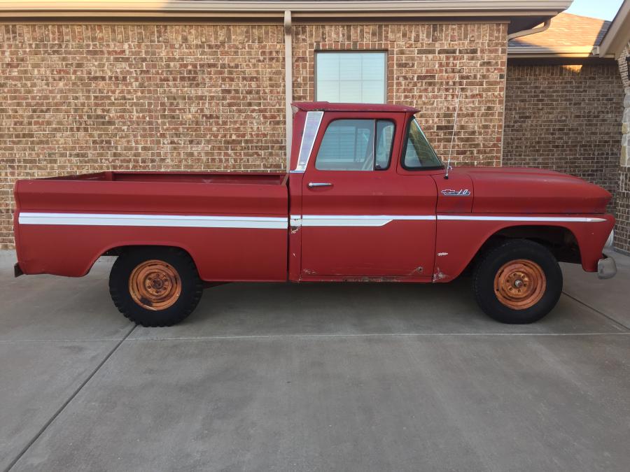

This truck is a thing of beauty. I love this model of truck. I had a 62 short bed, big window that I had planned to do. I ended up selling it and wish I hadn’t. Probably sold it because I actually prefer a 65-66 due to the a-pillar instead of the knee-knocker. LOL!!
That red truck looks like it would have been a good start. I think all of the 60-66's have their own charm.
It was a very solid truck. The bed sides were perfect. The top rails of them weren't beat up or anything. I have 68 C10 short bed big window and decided to keep it between the two.
