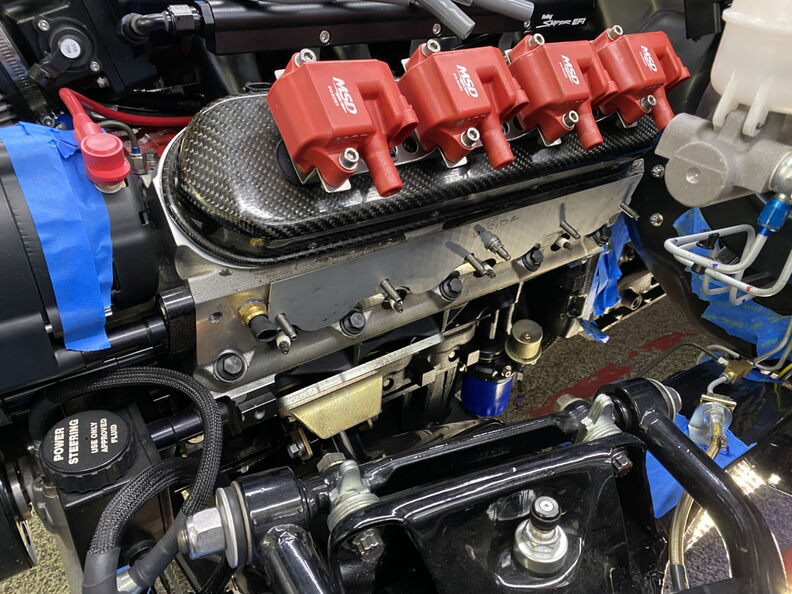

Here are the pictures

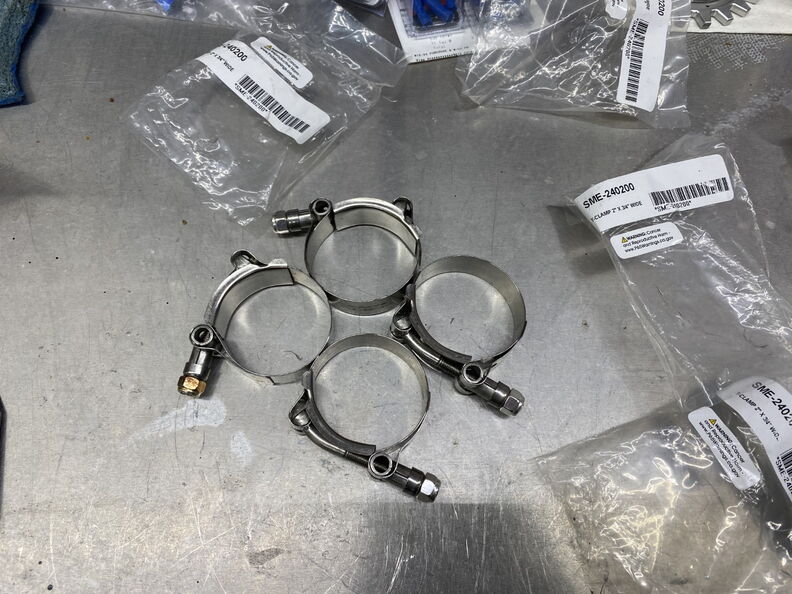

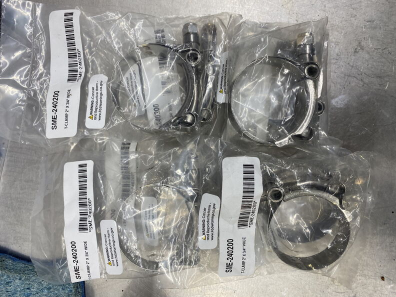

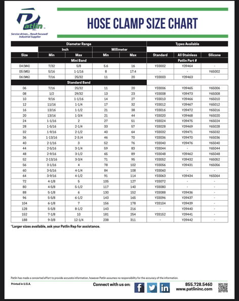

So, I have had a few questions about the hose clamps that I had mocked up on the car. I figure I would share all of the different options that I found and if you have anything that you want to share please feel free to share it.
Too Big
Looks much better but you better be wearing steel gloves as these will slice your fingers.
marty-mj

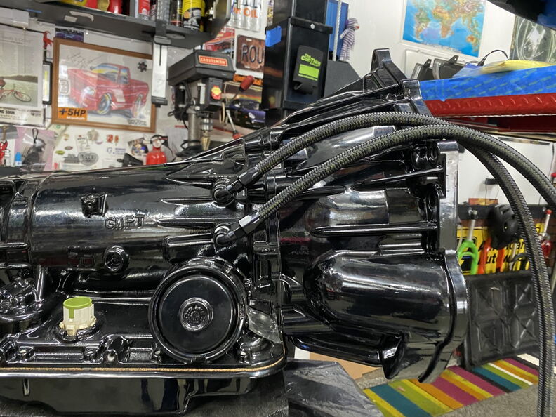

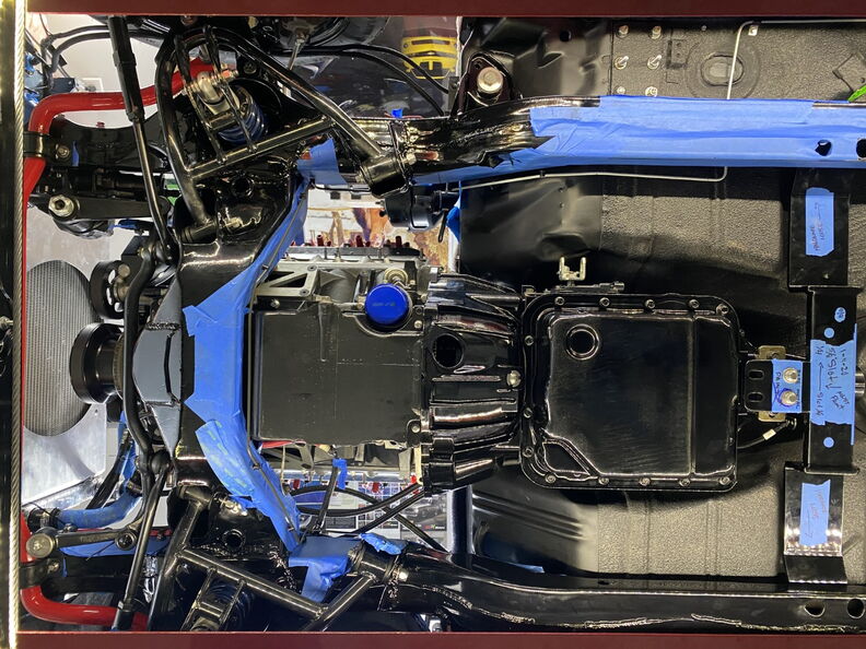

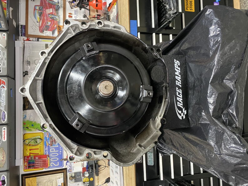

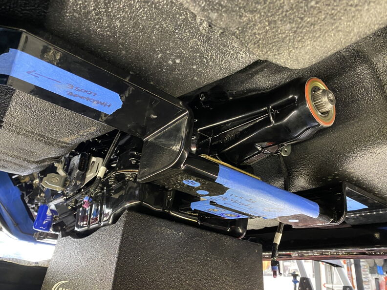

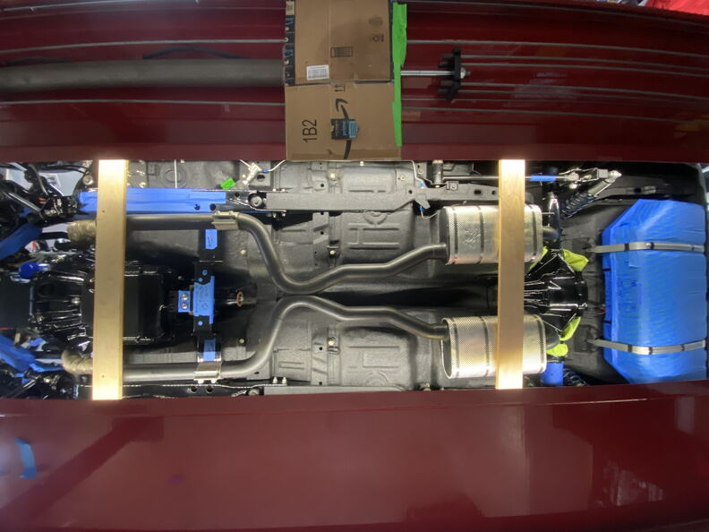

Default Atomic 4L60e Transmission Final Install (02-28-21)
Hopefully this will be the last time the Atomic Transmission gets installed.
I used the lift on the jack to support the engine.

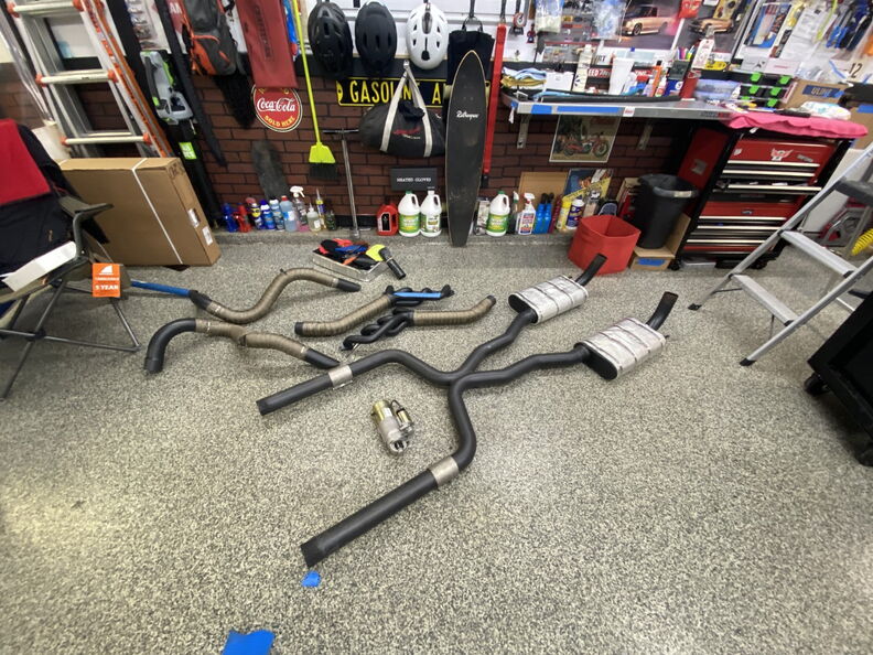

Originally I was going to try to install the transmission with the headers and exhaust installed. However I quickly decided that the 30 minutes it takes me t remove the entire exhaust system would be the way to go.
This is the only nut that is a pain in the ass to get to. Thankfully the motor has header studs.
Yes this is the exact height I need to get the trans in the car while it is on the lift.
So the first attempt didn't go as planned. Apparently I forgot to remove the powder coating that was in the alignment hole.
Here we go again. (( Twice as it seems the torque converter moved out the 3rd time ))
It's hard to see the soft lines I ran for the transmission.
Yet to do is replace the trans pan and pan hardware.
Time me
Calling it a night.
marty-mj

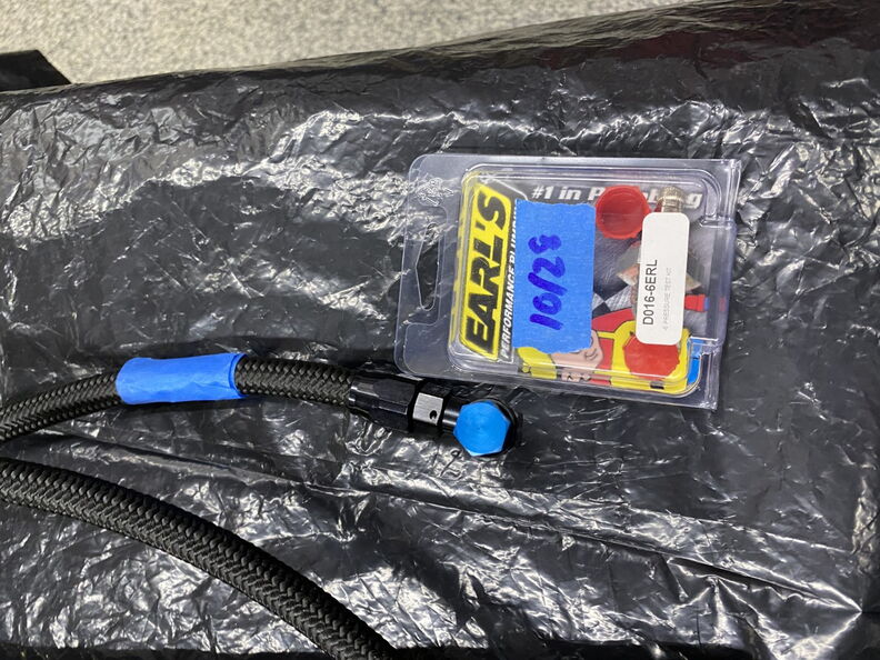

Default Testing the transmission soft lines ((02-28-21))
Before the Transmission lines went in I tested them to make sure the lines didn't leak.
No Leaks
I also installed the knotchead line clamps for the final time.

Another option on hose clamps....you do have to be precise on your measurements for proper sizing. Very clean and finished look for where they are most visible. I could not use them on the interior clamp at the throttle body because of clearance issues.
https://www.phase2motortrend.com/category-s/205.htm
You can see them on the CAI.

Originally Posted by Jimbo1367 View Post
Cyborg TT,
What brand truck bed liner did you use? It looks amazing.
thanks,
Jim
Oddly enough it is just Line-X
Well dang it looks like I will be buying some of these as they are bad ass.
