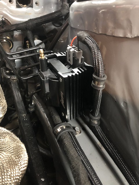

MSD coil mounted on the driver's fender well:

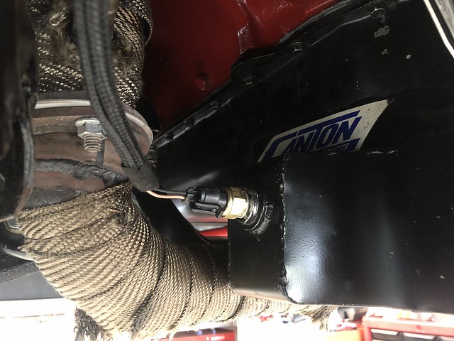

Added an oil temp sensor to the harness:

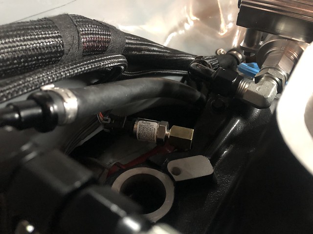

Fuel and oil pressure sensors mounted behind the intake so they're as hidden as possible:

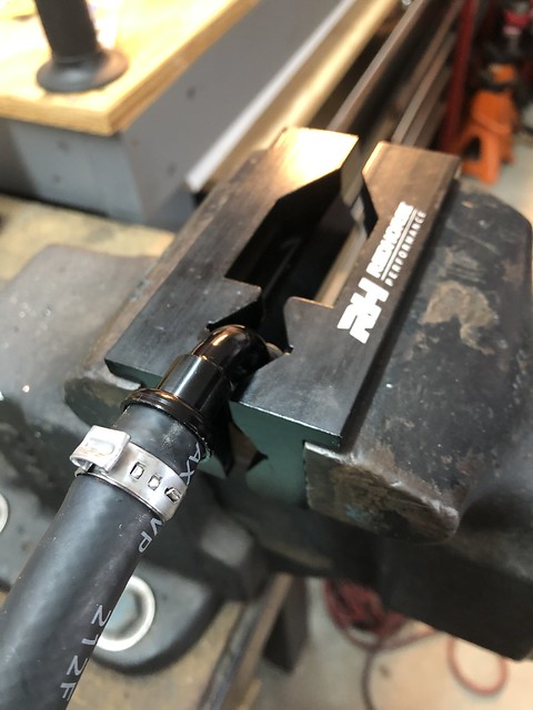

For the fuel lines, I had 2 options. The stock third gen Camaro TPI fuel rails have the fuel enter and exit at the front of the intake. For the Stealth Ram, it's at the back. I could either reuse the stock hard lines and run an adapter the a flexible line all the way to the back of the intake, or cut the hard lines and run new flexible lines to the back of the intake. I chose to go the harder (and better looking) route of making new fuel lines.
Again, I did not do a great job of taking pics, but I cut the stock hard lines underneath the driver's door and used adapters and new flexible fuel hose from RedHorse performance. You can see the lines in the pictures above of the fuel and oil pressure sensors.

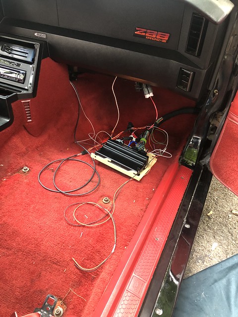

As I got ready to fire it up for the first time with the new Holley ECU, I plugged in my laptop and starting going through the setup procedure. It's a pretty straightforward process of answering some questions about your engine (size, firing order, injector type, etc). I ran into an issue on the step where you set your throttle position sensor. This needs to be completed succesfully before you can start the car. I kept getting an error:
I started digging a bit deeper into the issue and noticed my TPS sensor was not getting the required 5V... not good! This set off a 2-week debugging session trying to figure out why I wasn't getting 5 volts to sensor. Here's the quick version of how I figured out the issue:
1. I started at the ECU and back-probed the terminals that supply power and ground to the sensor to verify I had 5V there. All looked good:
2. Next, I pulled the wrap off the harness and found the junction where the power wire splits to supply 5V to all of the sensors on the engine. (The orange wire in the picture below.) Again, I could probe this and get 5 volts.
3. At this point I had all of the sensors unplugged from some other checks I had been doing. What I did next was start plugging in each sensor that gets power from this junction 1 by 1 and monitoring the voltage. With the just the TPS plugged in I was getting 5V now... hmmm. I then plugged in the fuel pressure sensor and the voltage dropped by 1.5V. Plugging the oil pressure sensor dropped it by another 1.5V!
4. Looking a little bit closer at the harness, it turned out that the power and ground and those 2 sensors was reversed, causing the big voltage drop on the whole sensor 5V circuit. Popping the terminals out of the connectors and putting them back in the proper place got me the right voltage to the TPS and let me calibrate it correctly:

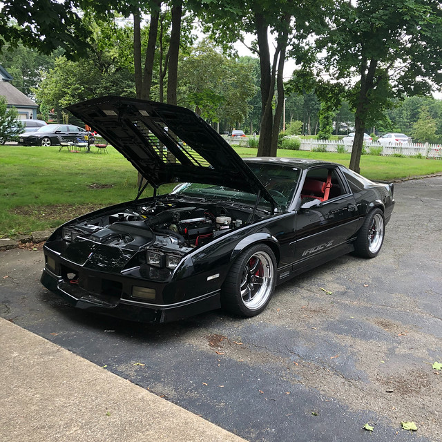

My next update will hopefully be a success story with a hood that closes and perhaps a test drive! Here's a quick teaser pic:
