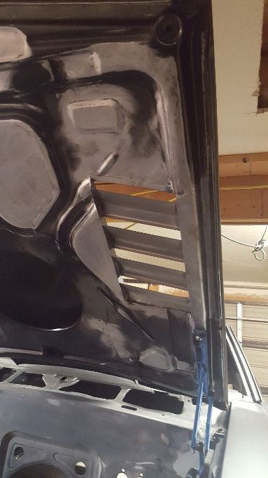

Here are some hood louvers from Frank with Gray Area Steel Co. Amazing hand fabricated hood louvers with a perfect fit and finish.

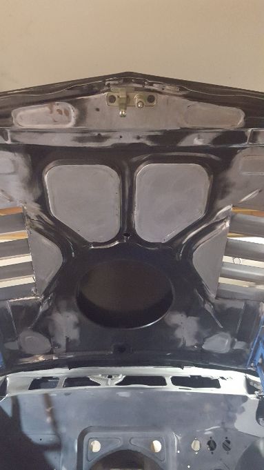

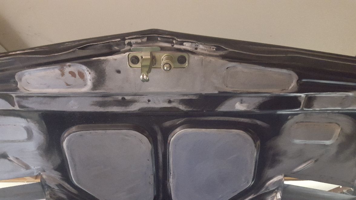

Some underhood work, filling in some holes and the porsche/VW hood latch modifications.

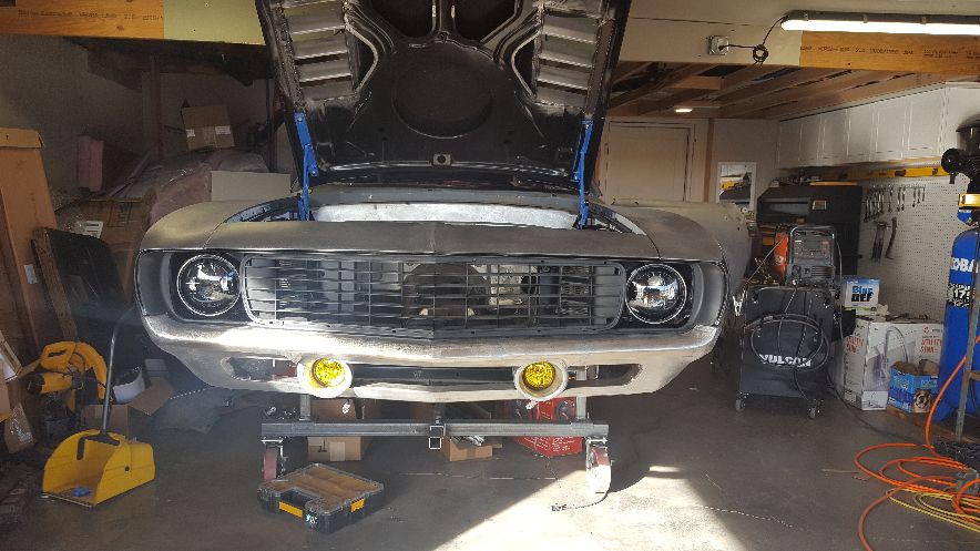

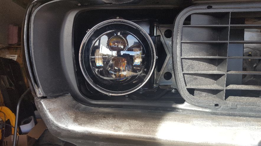

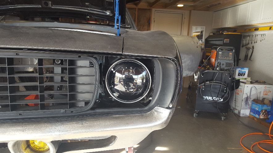

Modified the headlight buckets to accept some JW Speaker LED headlights and still allow the doors to close.

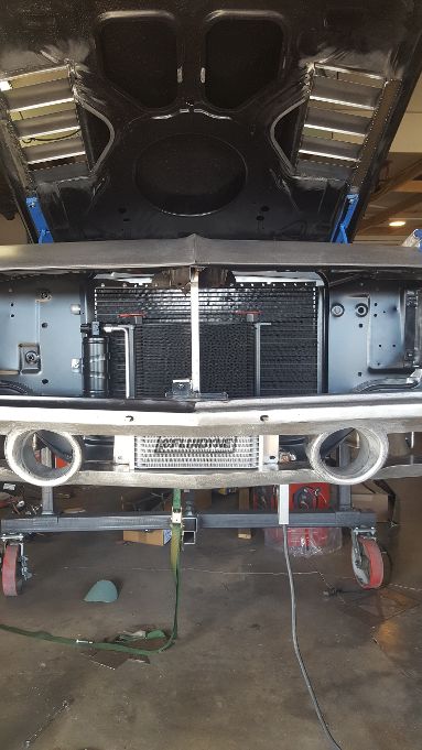

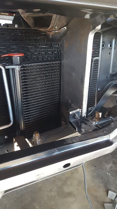

Made a new core support hood latch from scratch. This allows me to mount the external oil cooler and power steering cooler centered in the grill opening. I needed to be able to mount the Porsche/VW hood latch and most importantly, my OCD would not allow me to have a bracket that was offset and not centered in the grill opening.
