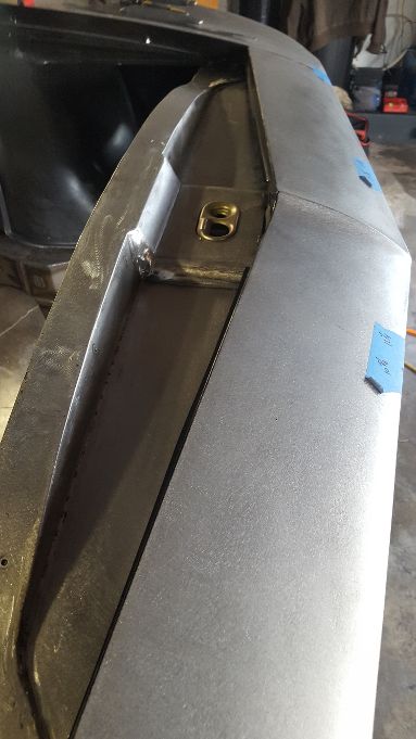

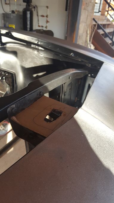

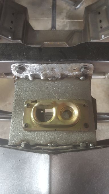

Made a new core support hood latch from scratch. This allows me to mount the external oil cooler and power steering cooler centered in the grill opening. I needed to be able to mount the Porsche/VW hood latch and most importantly, my OCD would not allow me to have a bracket that was offset and not centered in the grill opening.

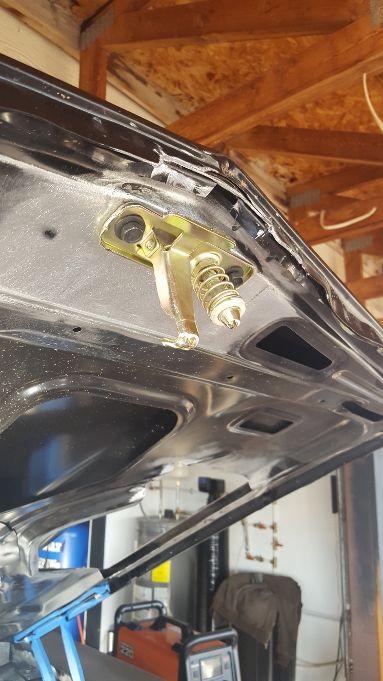

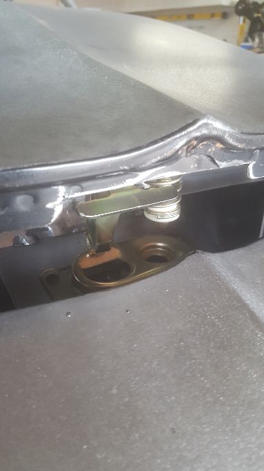

Here is some work that went into installing the Porsche/VW hood latch.

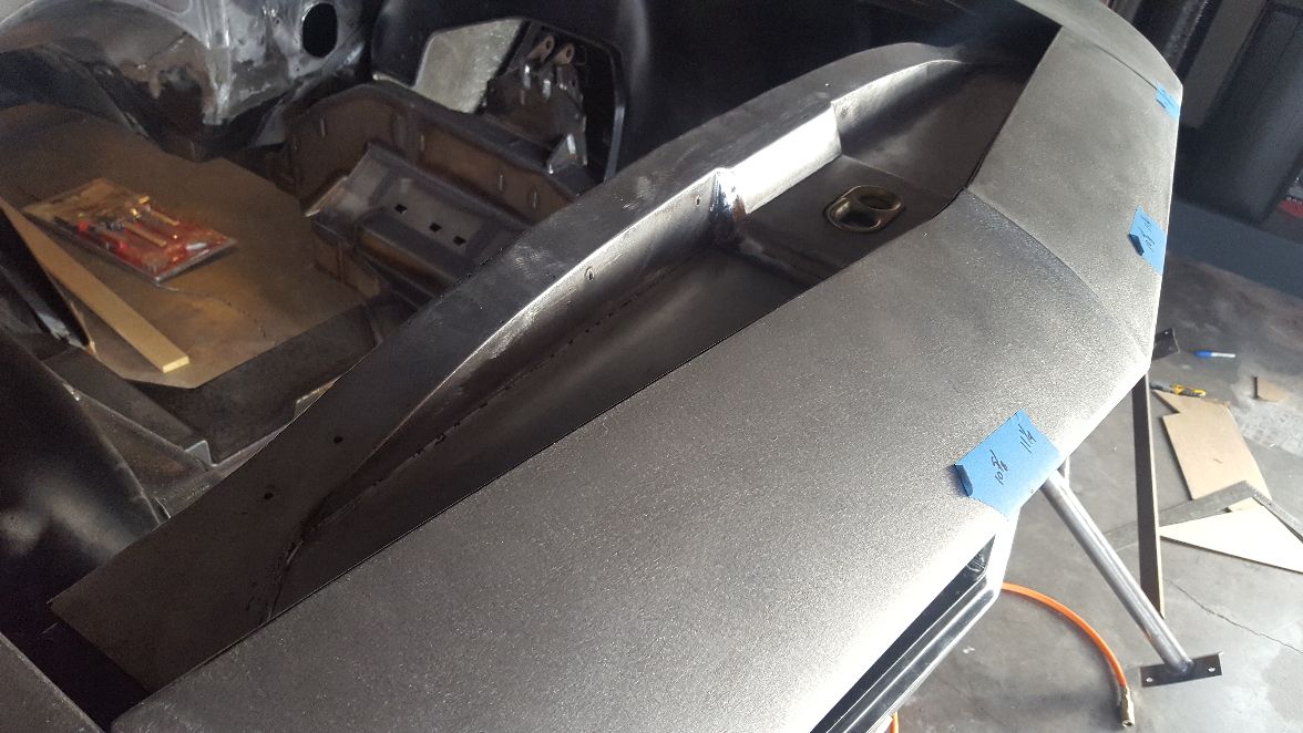

Here is the closeout panel we made to hide everything. This is a drop in removeable panel. There is a lip on the back side which drops down over the stock core support to allow it to sit in place. Once it is in, it really doesn't move at all. However it is held in place with the bolts that hold the billet fender braces. This piece will be body worked and painted the same satin black as the engine bay.
