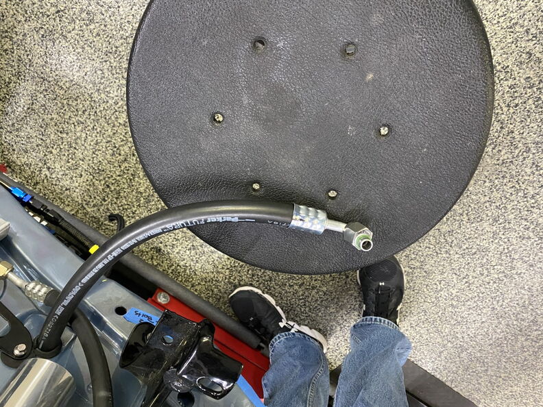

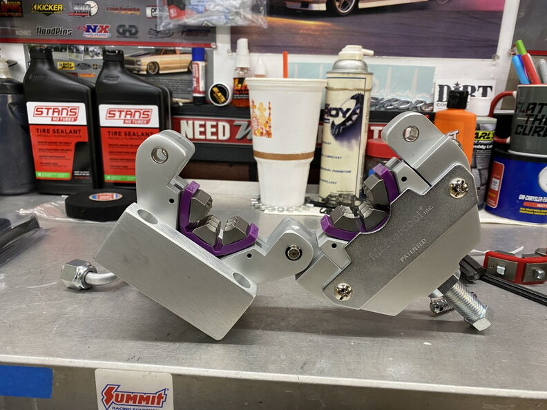

Default I needed something easy to do I made an AC line. (03-22-21)
Since yesterday didn't go so well I decided to make an AC Line.
I plan to crimp the fitting in the engine bay once I have all of the lines in the car.

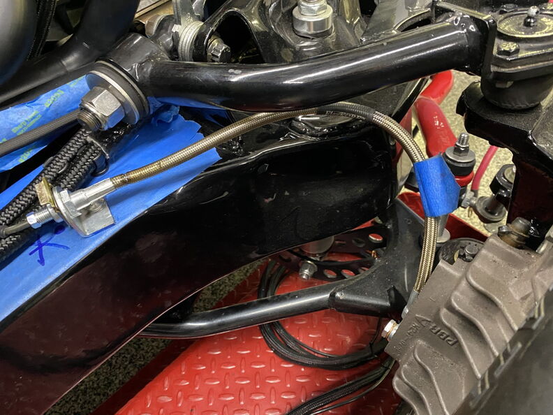

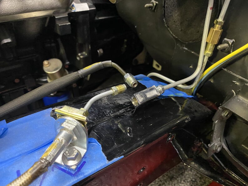

Default Notch-Head Brake Line Clips (03-31-21)
Time to installed the Notch-Head line clamps. Drilling the hole in the frame with the itty-bitty drill bit is very very scary.

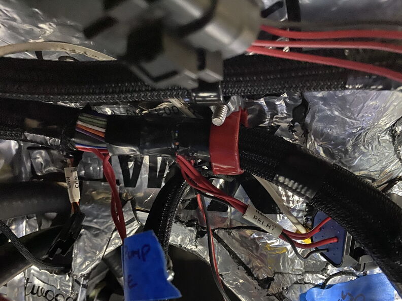

Default Holley EFI Wiring (04-07-21)
Jumping back on the Holley EFI Wiring.
What is that song ???
https://www.youtube.com/watch?v=c9lh7lqZojc
Wire Wire Everywhere a Wire, Messing up the scenery, losing my mind.
So my goal is to make all of this look as clean as possible and work.

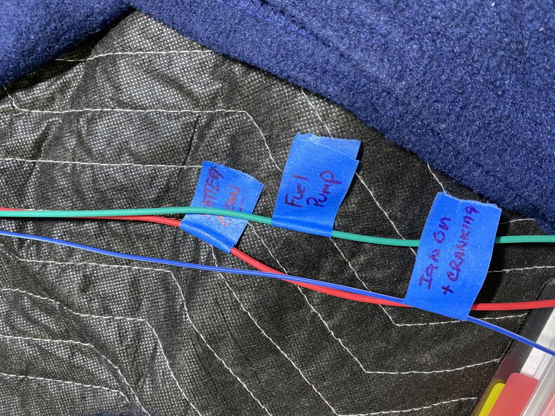

More notes

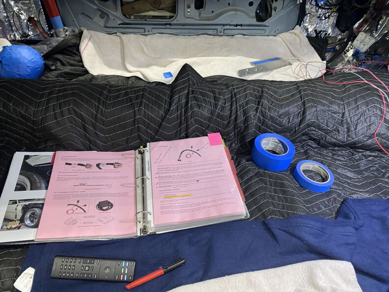

As you all know I am fairly organized and since my memory sucks (chemo-brain) I have a binder for instructions and another for all of my To Do Lists.
I love my blue tape.
I've learned that is you write the not immediately and put it in the place that it needs to be there is a good chance you won't forget the task and get burned later.
I will be installing Tessa tape on both sides of this line clamp to stabilize the line so it doesn't move back and forth and pinch the fuel pump fuse. The Holley ECU has a direct power for the fuel pump which is very nice.
It's a cute little wire.
Good news I just so happen to have a green 14 gauge wire in my box. (Note this wire was not to spec and I ended up using this wire to trigger a relay.)
Of course I labeled it under the dash and in the trunk.

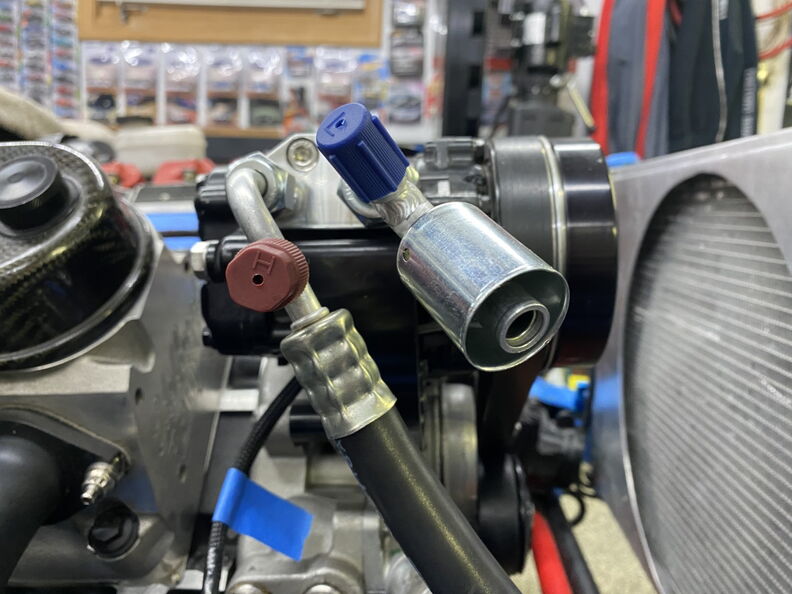

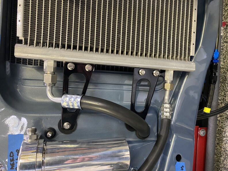

Default Making A/C Lines (04-10-21)
So I am finally coming back to the A/C lines.
