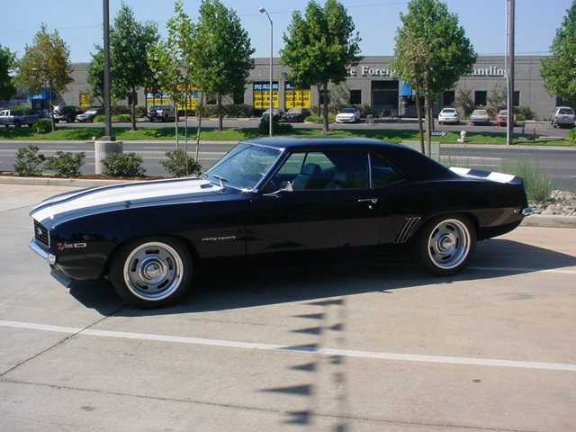

Just bought a 1969 camaro. So excited, but it has some enormous 18" wheels that I cant even turn while driving. Anyways, they gotta go.
I want to go with 17" rallys, but for the life of me cant find any with the 4.75" and 5.25 backspacing everyone is saying is needed. Am I going to have a problem running 17x8 4.5" BS in the front and 17x9 5" BS in the rear?
Only two companies make this combo and its Wheel Vintiques and Rev Wheels 107 series.
I was thinking of running 245/45/17 and 275/40/17, but people are saying that I should instead go with 235/45/17 and 255/45/17. Will it still look pretty with the latter?
The look I'm trying to achieve is one that I found on here by Ross Dorn. Ive done countless searches but am unable to find what brand wheel and tire combo he is running. Any ideas? This is his car.

I'll ask him.

He said they were Wheel Vintiques, and he ran the 245's and 275's without issue. Couldn't remember the backspacing but on their site 4.5" front and 5" rear is the most they make. By the way, they may be for sale soon.

Either way, in the picture above, the owner must have done something custom because Wheel Vintiques confirmed that their silver wheel is painted entirely silver, and the chrome version is entirely chrome.
I want it silver in the center and polished on the lip, just like the photo I attached.
