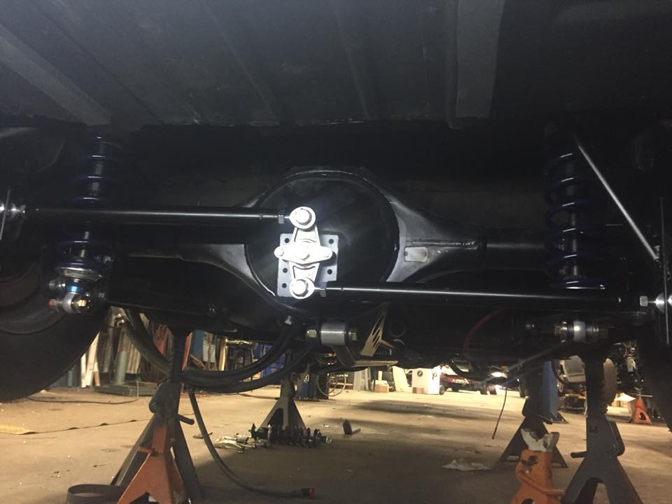

I had Moser build my original 12 bolt and put the big bearing ends on it. The only advice I have is to make sure you get the inner seals and not rely on just the O ring on the bearing.
Resized_20201229_191330 by F G, on Flickr
