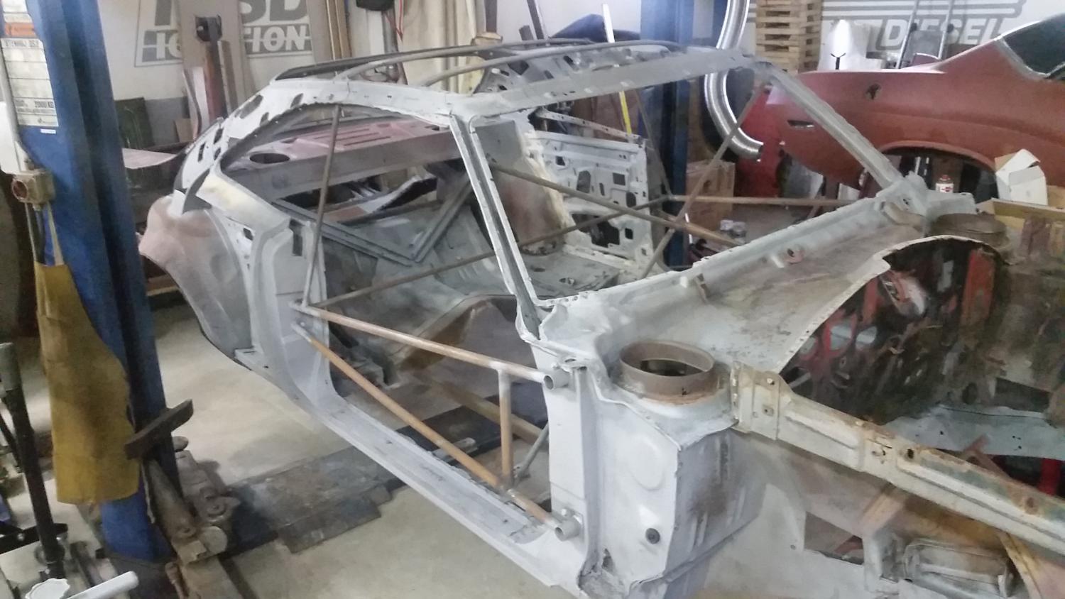

It will be low, has hidden tube frame inside its body, inside roof frame,
inside frame rails, double rails at rockers and in the middle, around transmission and drive shaft.
Removable main hope, cross- and door bars.
Many body panels will be hand made from aluminium, by me. Ofcourse
Fluss front and back glass, one piece door glass.

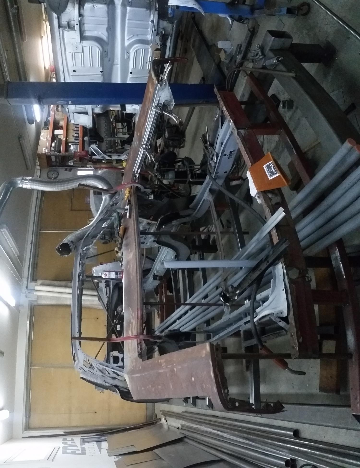

As you can see in the photos, body has cutted / drilled open,
brassed and sandblasted with home made rotesserie, then I put my frame table together
and installed body on it so that top of the table as ground,
ride hight set to 4", as you can see, front rails dont work with that.

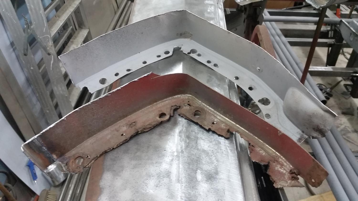

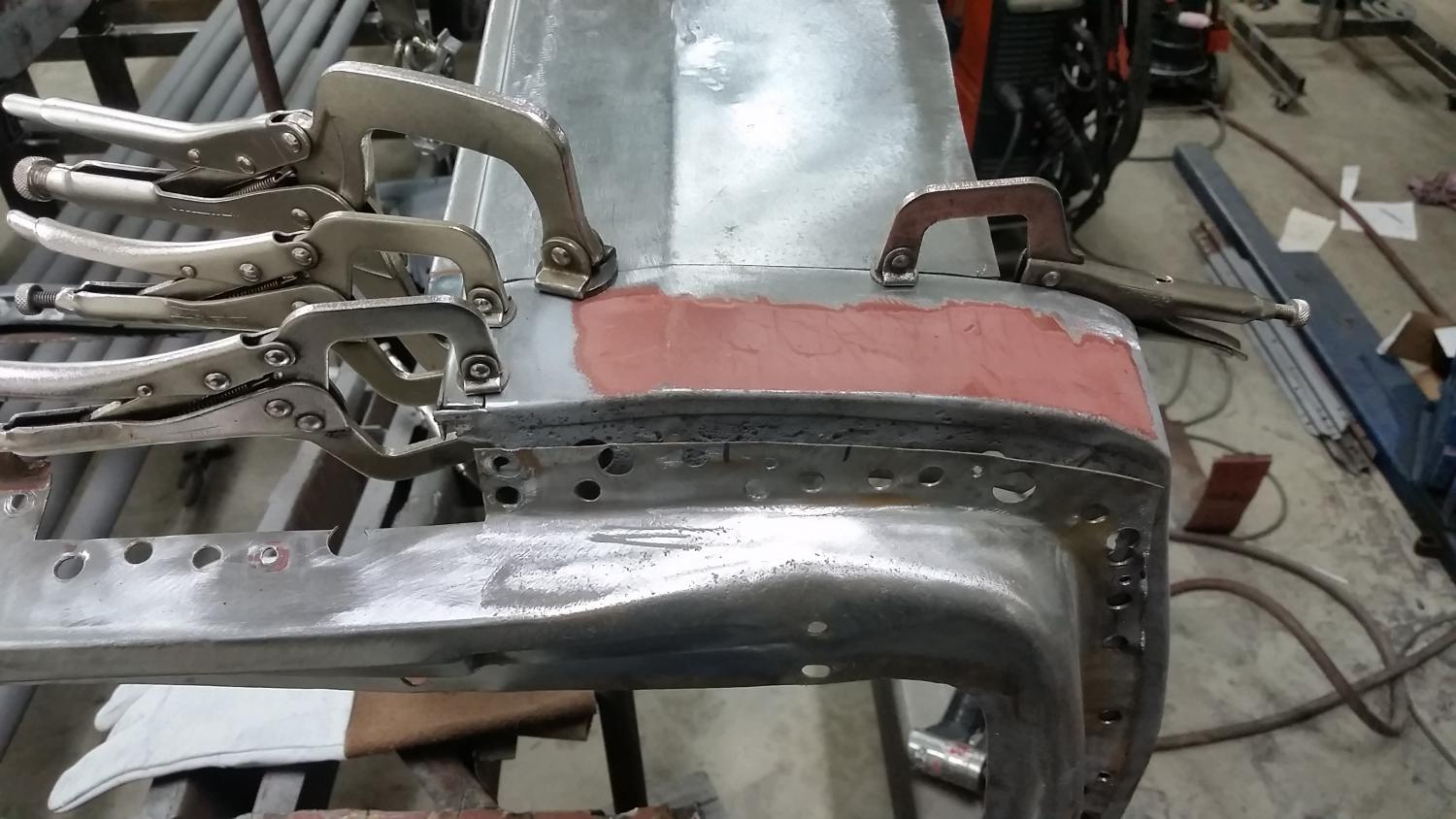

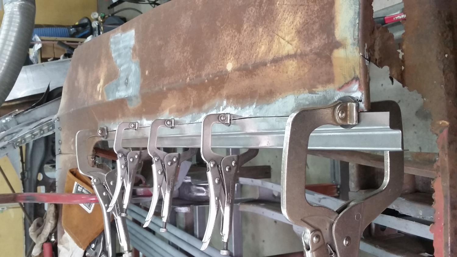

Well, lets show some progress.
Actually wanted to show what I did before sand blasting.
Back panel was shoot, I knew that,
had another panel ready, trunk gutter where also rutted, those I got repo but had to fab quarter edge lid that folds to gutter.
I also had to make the gutter
front corners. Tig weld them on and hammered
flat.
Seam between quarter and sailpanel, usual a rust spot in Mopar, well cut that off and welded a piece there.
Last one is a bonus, jump ahead abit and show have is coming. I took a shapping class in Sweden. Per the Metalman Sweden. Mechammer inventor Ben was there also as a tutor, luckily he became my tutor. Made one rear corner piece there and another at home, few years later. They will be welded on. So one seam less.

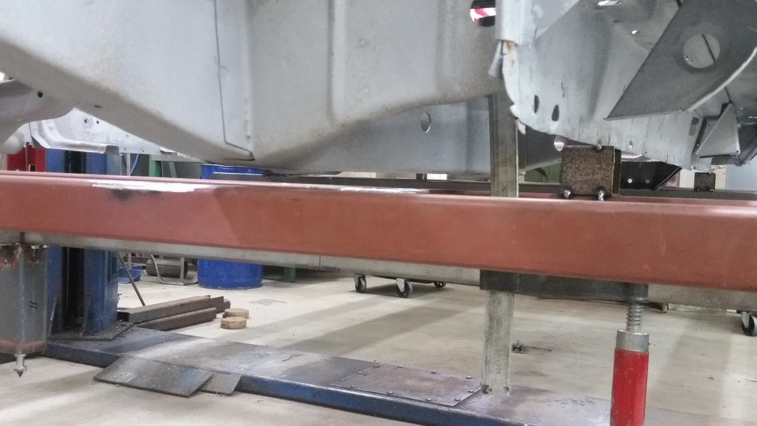

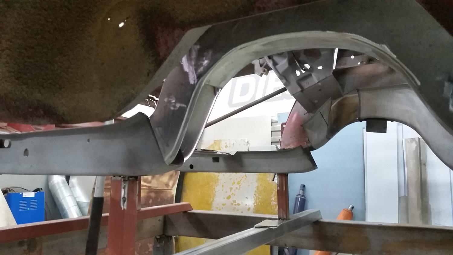

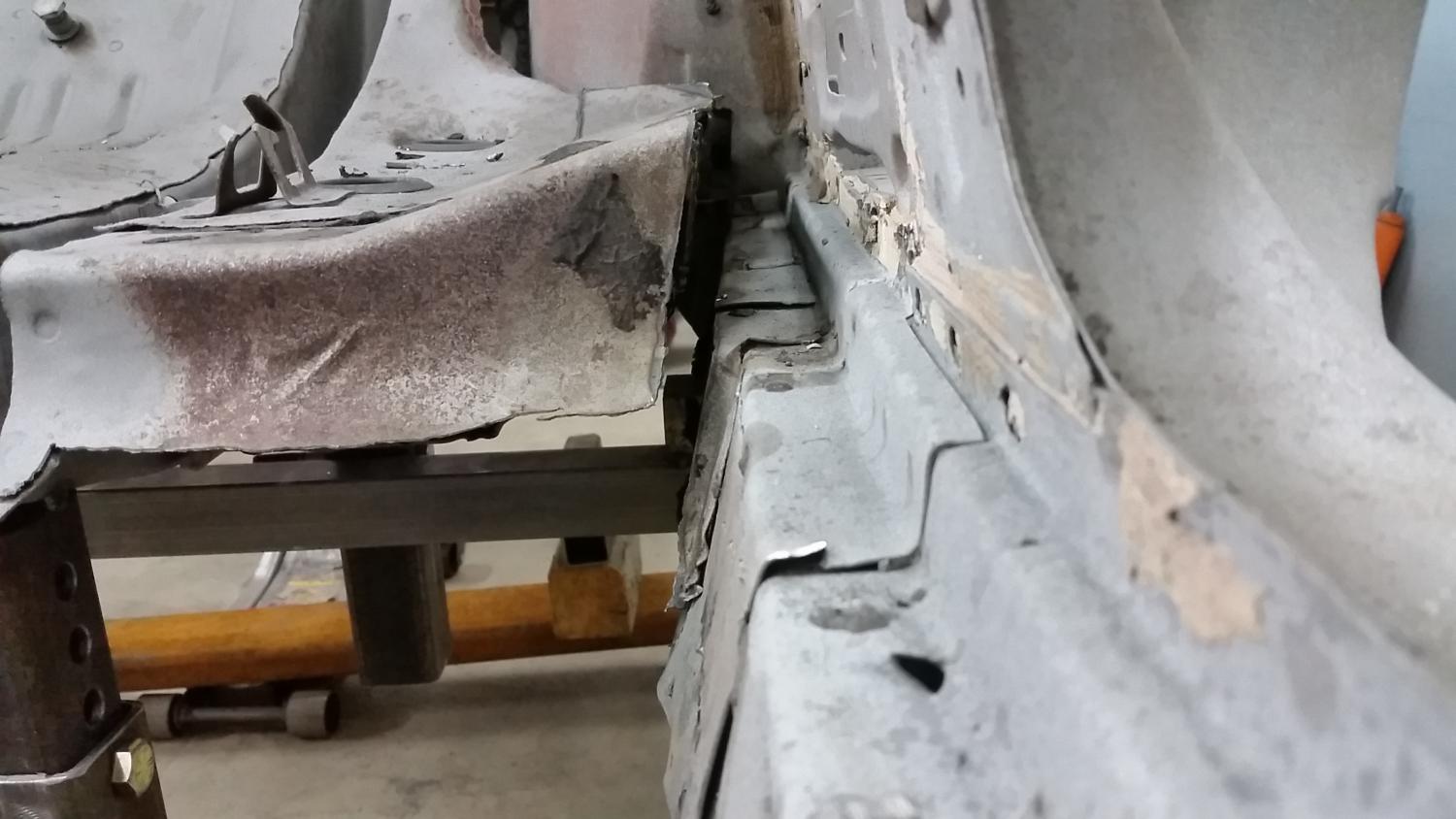

Getting low. -er.
as the plan is to get this car low, put still driveable low.
pre-measures shows it could be around 126cm/ 46" of total height.
Wheels and tires will effect it of course, but we'll see.

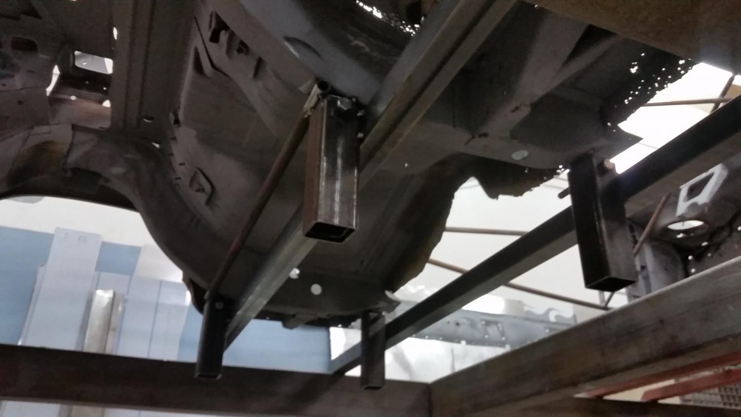

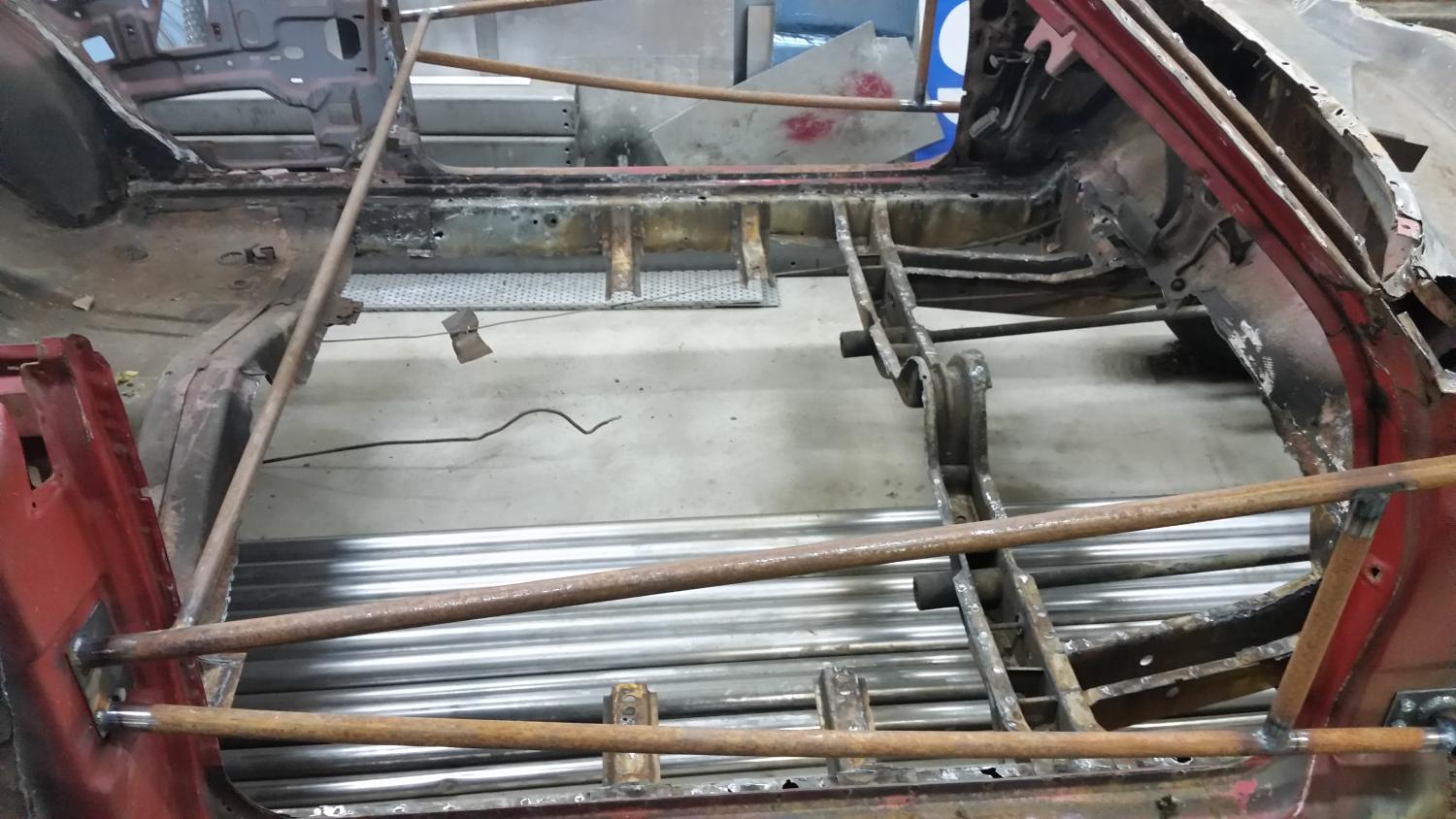

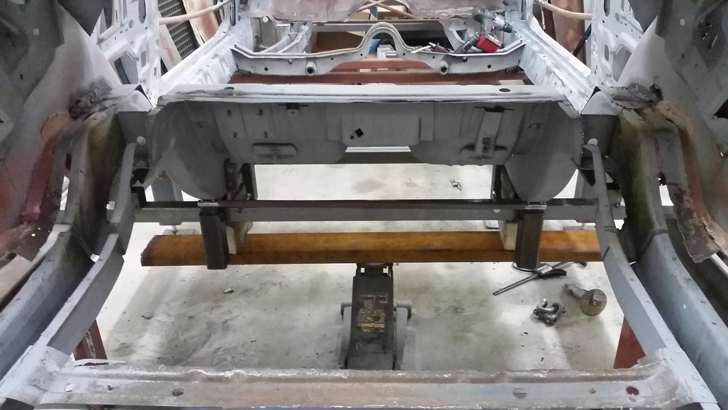

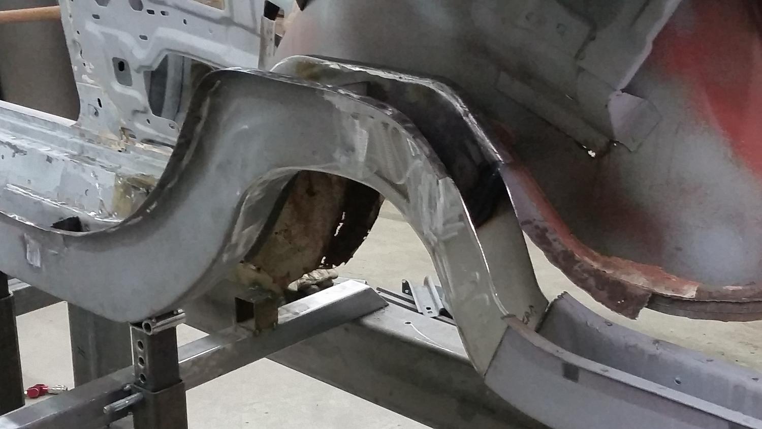

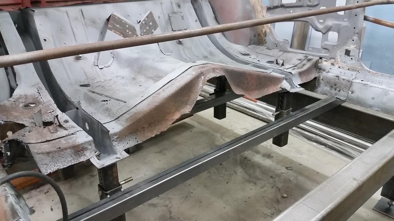

I got an idea to rise the rear frame rails above the rear axle.
To be able to rise the axle with out loosing suspension travel.
when mounted the body on the frame table,
I fab'ed adjustable stands, like jack stands.
Cut'ed the frame rails from rockers and from trunk edge.
Loose the original wheel tubs at this point also.
Leaving the trunk floor to stock location for now.
Then jacked it up 3".
Made pieces to fit the caps,
bead roller the edge to give same curve as stock rails..
After they where welded on, supported the rear panel from table.
I cut'ed the rear frame rails off, and floor under rear seat.
they where is good shape but they where too narrow for my plans.
Made new wider ones with magnetic brake. Again, with same kind of radius as stock ones. Now I can fit a tube in. Tube frame. That's coming, as are the bigger tubs.
