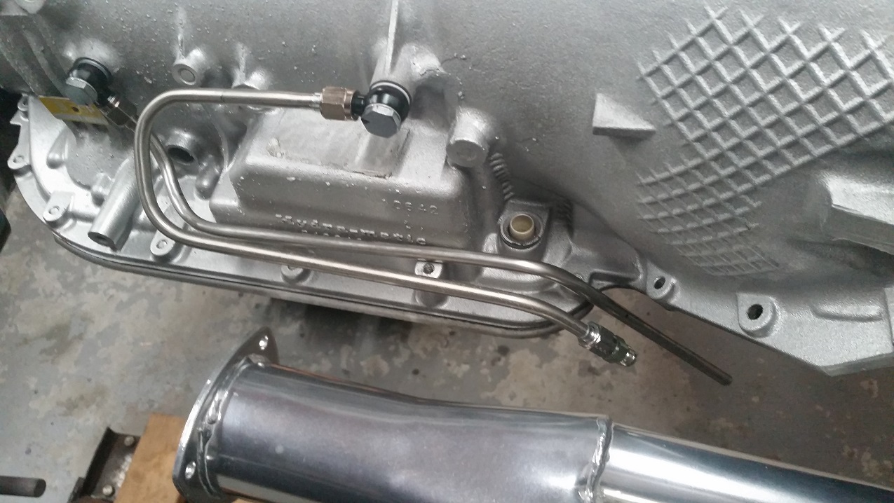

My stainless lines were a little bit of a chore too. This is from when I got the project started last year. I then ran the tubing from the starter tucking next to the pan as GM did forward up near the radiator. I used PTFE braided lines for the connections. I'm thinking with the trans cooler having -6 AN I should be good
BB
