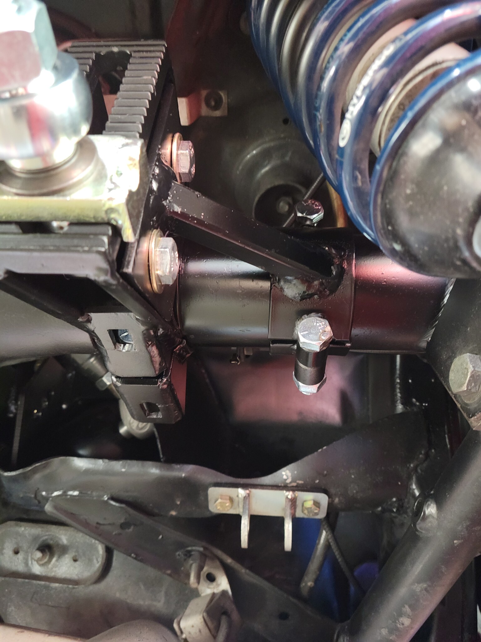

As always with this car, packaging is TIGHT. It's all in there though, and it all fits. Bernie did an EXCELLENT job designing this setup. I'm impressed.
I hope I don't have to do much work on upper link at track as it's a bit hard to get too, but I shouldn't have too once I find it's happy spot.
Tomorrow morning I need to swap out the rear springs, then it's off for it's first test drive. Wish me luck...
