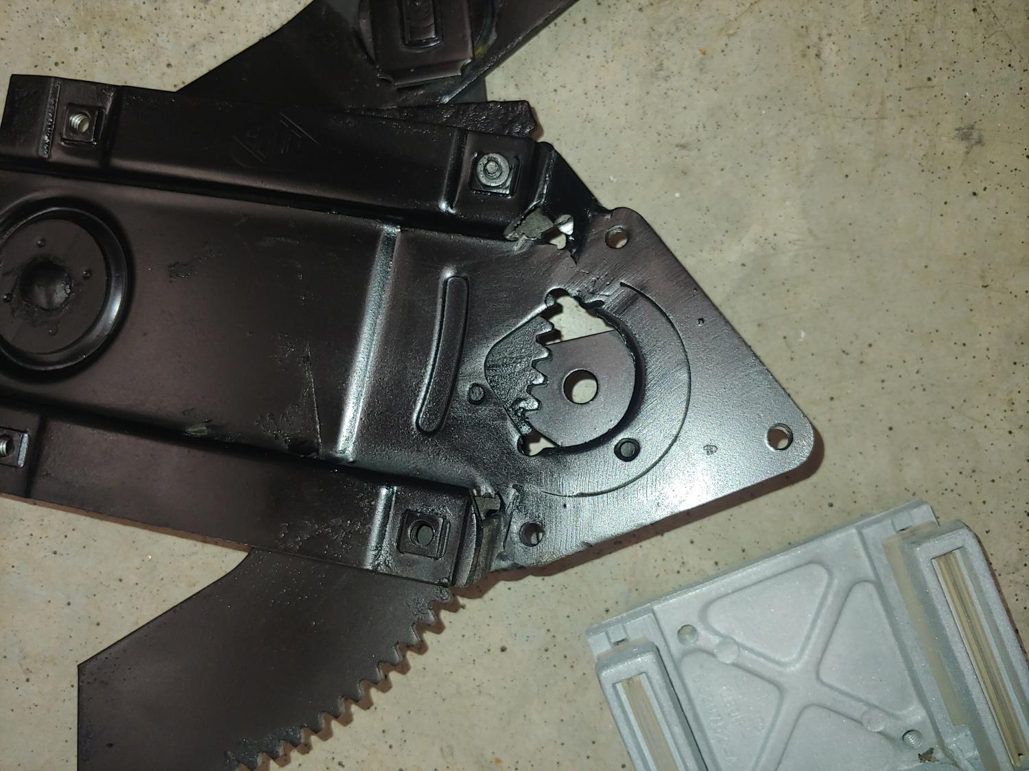

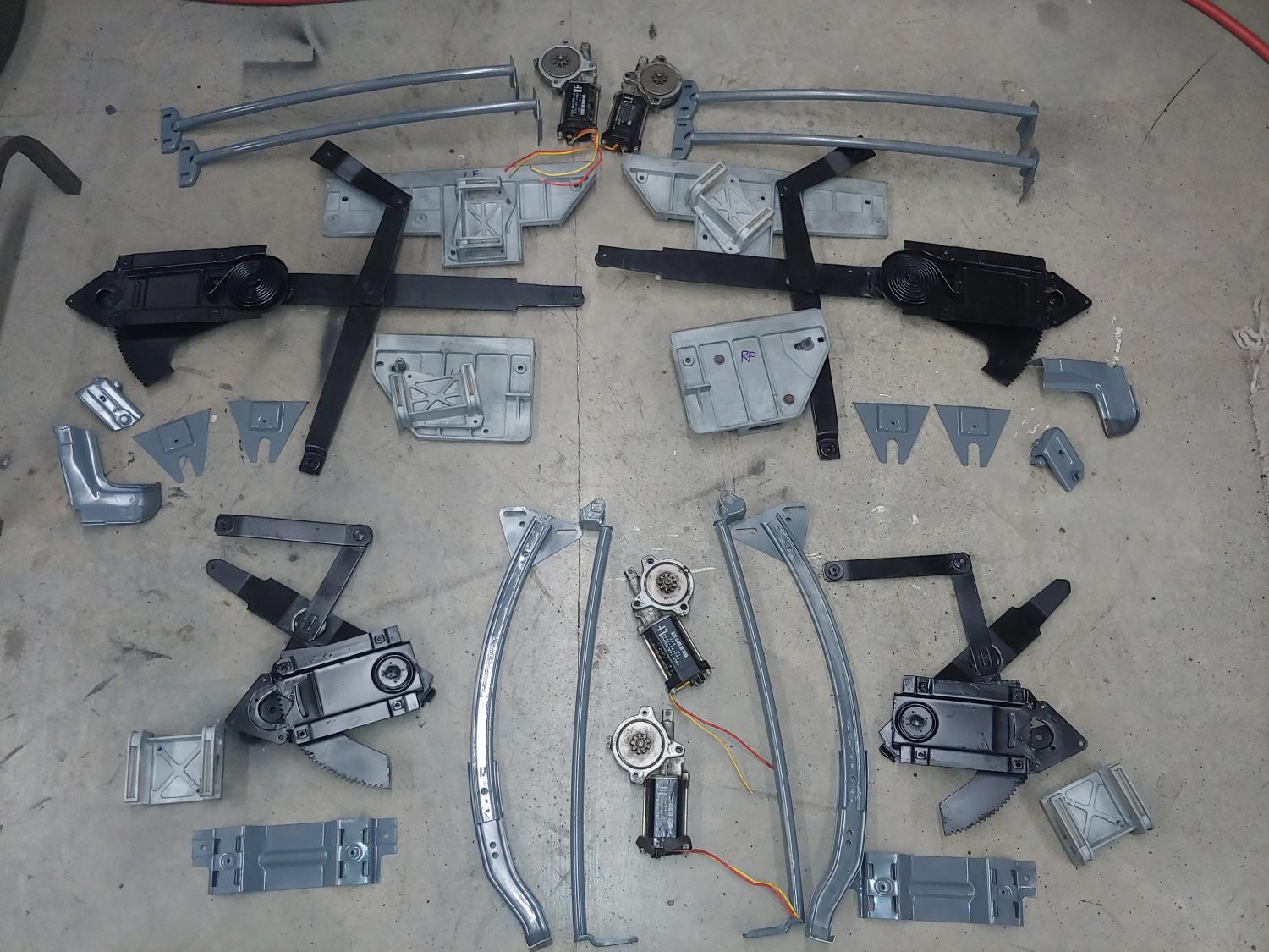

Got the stock manual window cranks converted to power. Cut the stock manual crank gear and clutch off the mechanism, Then fabbed some brackets to mount the motors. On the rear 1/4 windows I had to re index the arm to drop the motor for glass clearance. On the doors I just needed to cut some of the door frame for motor clearance. Gave all the parts a glass beading to clean them up and fixed the cracks in the tracks. Put a little rattle can rebuild on the pieces. Need to order some track guides and they are ready to go. Will pack them up for assembly day for now.
