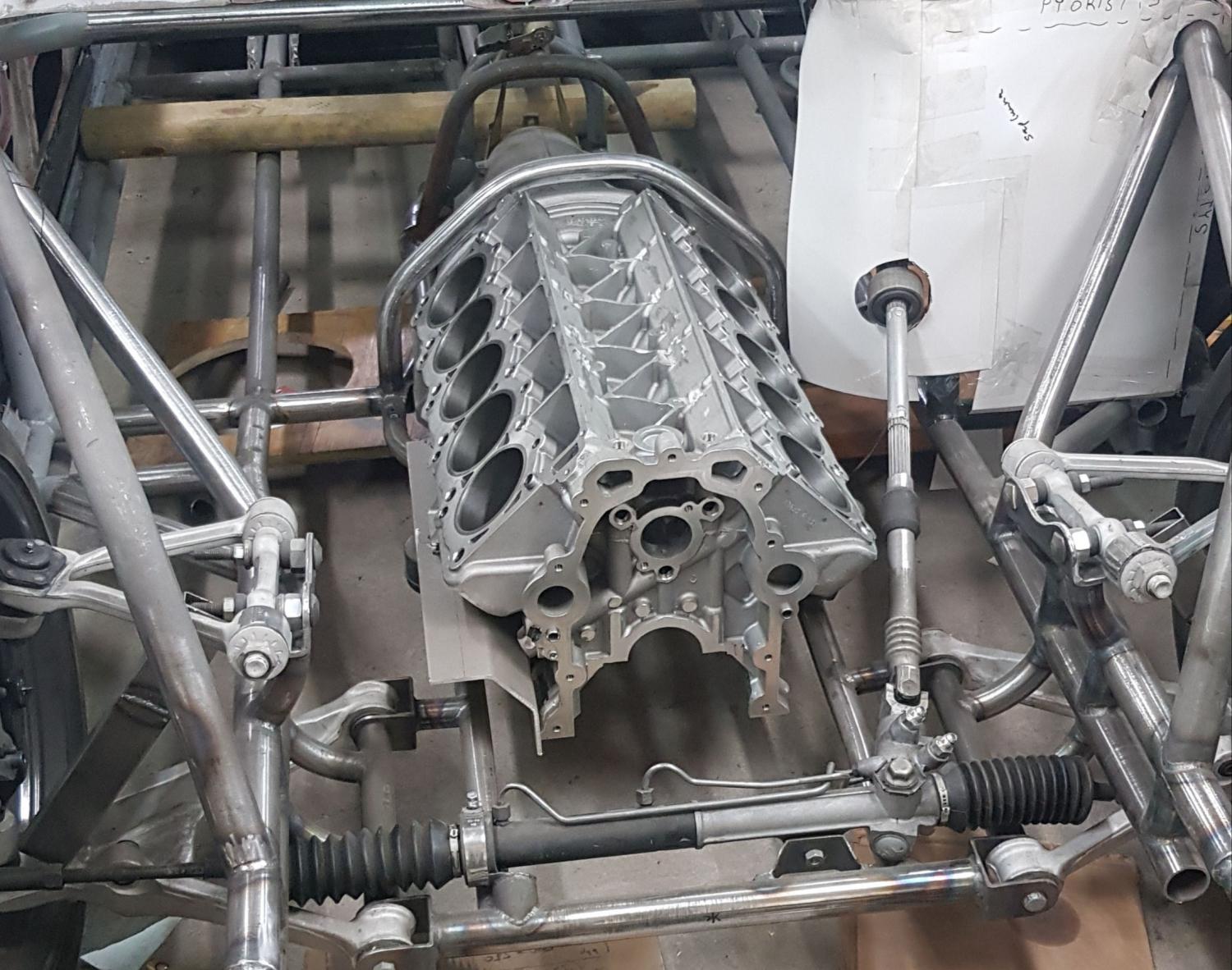

So back to front frame.
Wanted to do alot of triangles, the most strongest tube design. Connecting A-pillar tubes to front frame tubes from two places. before and after the front suspension.
Here is a trick I use im my tube bending jobs. Eliminates most of directional errors. Couple different lengths of soft 1/2" aluminium fuel line. Easy to bend, even back to straight.
UCA mounting base also from seamless tube, top piece from braked 6mm (1/4") steel.
I didnt take any pic when building rack mounting base. Or I do but would give up too much for now..
Also I had to install my new wheels on to check how much I've room on full lock.
Next go to get engine back from Sweden, installing engine to frame. Also start to design my own intake manifold.

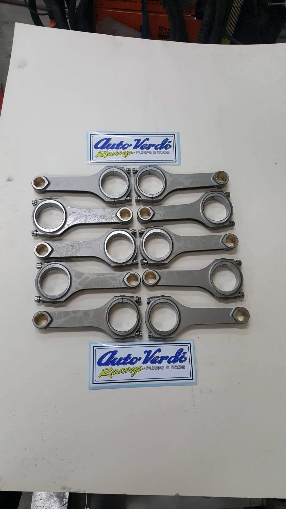

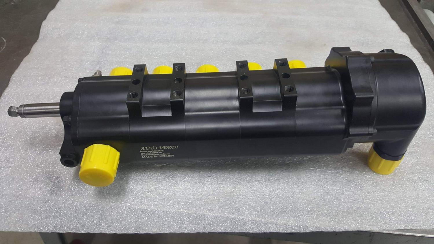

Rods are here. Went back and picked up the engine from Auto Verdi, Sweden.
Rods are totally one off, made from very special swedish military (not grade, but real military steel) steel, forged and cnc-machined billed pieces. Ready to balancing. European precision. For this engine and for twin screw supercharger. Cylinder pressure rises fast at low rpm. These are made and guaranteed for 200hp per rod. But have to use 1/4" wall wrist pin with full wall. Cant have any lighten one.
Really nice shop, hospital grade clean. Stefan is super cool guy. Provides rods for many Nascar, Pro Stock and F1 power boat teams. Those Koeningsegg rods where sexy. Sorry that I can show any pics from inside the shop.
Same time picked up my dry sump oil pump. Also from Auto Verdi. 5 stage, all sucktion stages are internally channeled, to back of the pump to oil air separator so one stage can be used as an vacuum pump. Provides 99.99% airless oil back to tank. Mounting tabs are also custom ones, designed to fit Viper engine block. But not like Competition Coupe, not putting this under oil pan, but to passenger side of the block. Had to make room for it, loose lower water hose connection, belt automatic adjuster and oil filter housing. They need to be relocated. I got a plan...

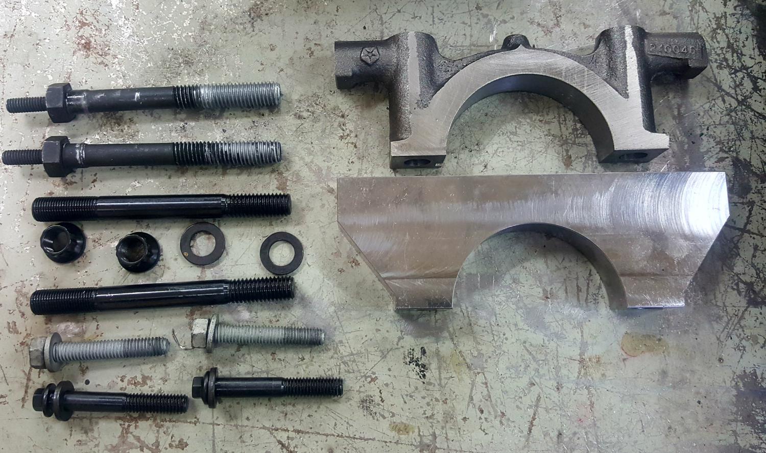

Had nice suprise when arrived home, my own design mail caps arrived. One of my friend took the task of machining them from our local steel factory tool steel Imaroc 410 M. (MoC410m) new ARP hardware. Next to linebore.
Had to install empty block to se how it fits my new frame.. had steering rack/engine cradle finished. More that later.

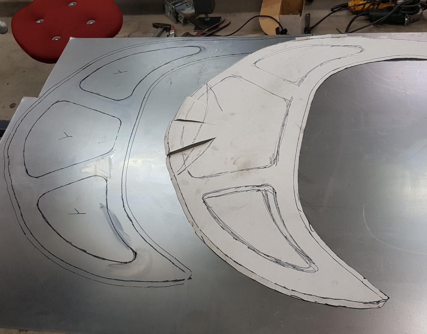

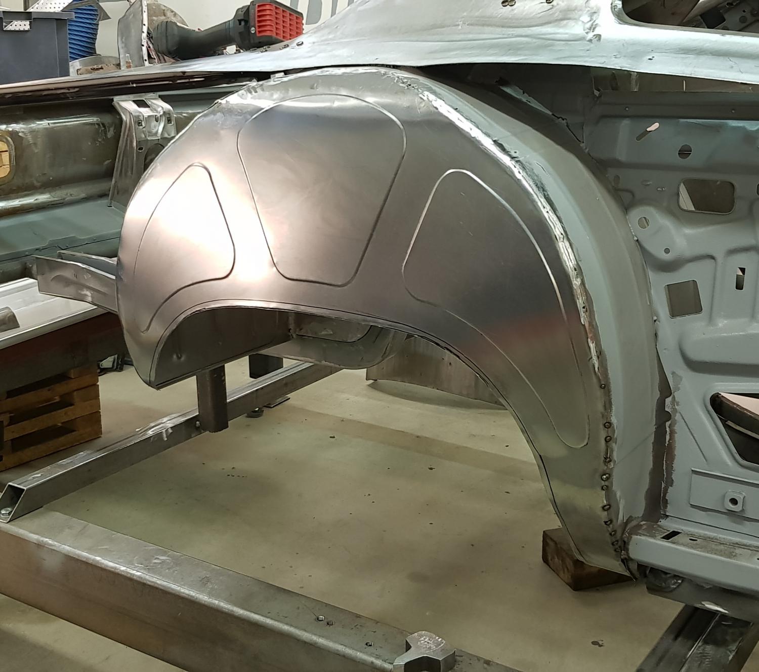

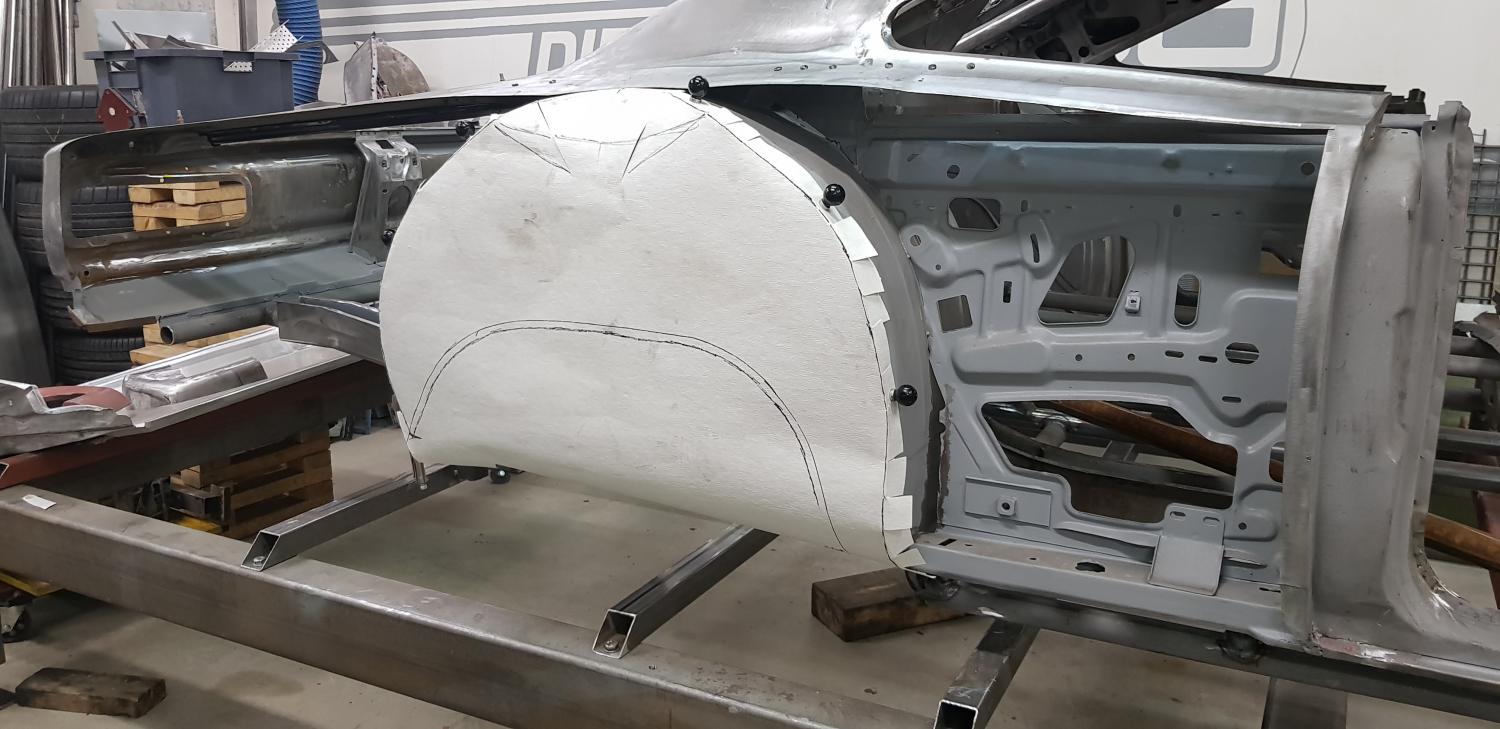

Next task is to make outterskin of rear wheel tubs. Have glued tubs to quarters on earlier builds but now wanted to make them "right". Made them with flance to match the lip in original wheel archs. Glued again but now with 2k body adhesive.
Paper template, bead rolled edge and some stifnings. Tig welded and hammered. Used mig to hang them on. Hard to do by you self.
Made them as big as possible. Even had to cut down the top most outter corner so that quarters would fit.
Gray stuff is industrial grade epoxy paint. Body will be painted all over everywhere with that stuff.

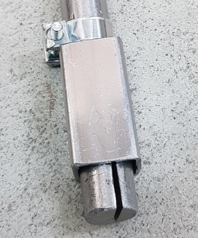

Little tip again. Flancing hand tool. Just an old 1/2" socket T-handel, one end cutted off and slotted with 1mm cutting wheel. Piece of squar tube and small hose clamp make a easilly adjustable back stop. Just bend in little steps and go back and forward. Works great.
Now I can start hanging new quarters..
