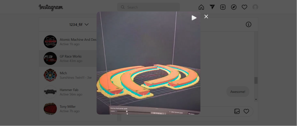

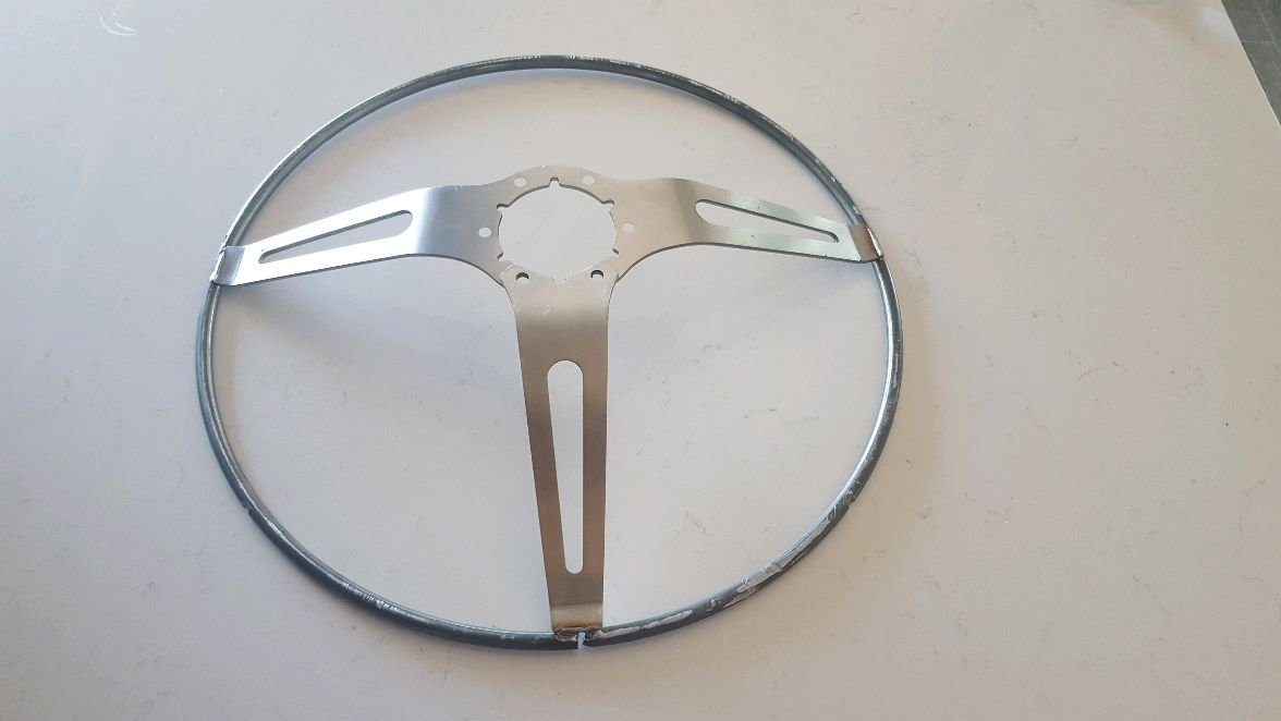

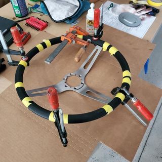

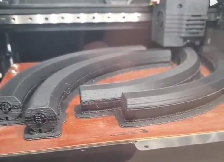

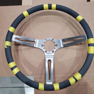

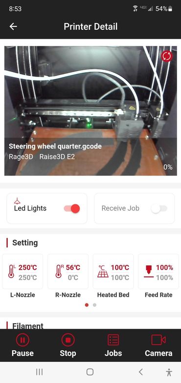

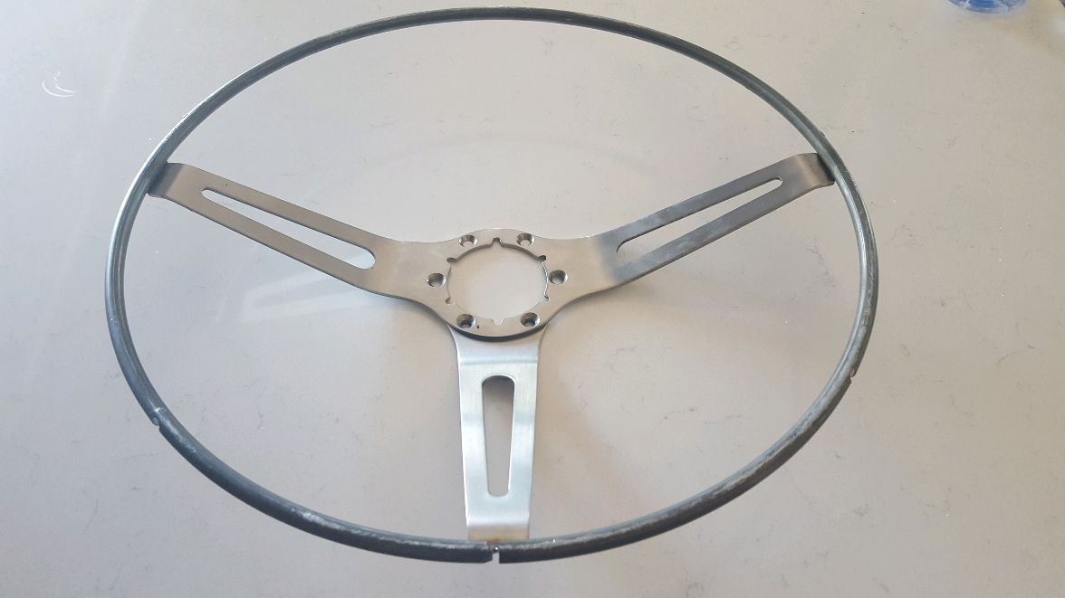

While the body work continues, I am working on knocking some other items off of my to do list. In continuing with my pro-classic theme, I wanted to keep the original 3 spoke steering wheel. I know I have said this before, but I still want it to feel like I am driving a 69 Camaro. The grip on the original NK1 steering wheel was just a little to skinny for my liking. I peeled the original grip off and sent the steering wheel to Greg from GP Raceworks. He 3D printed me a slightly larger grip which had to be printed in 4 pieces and then epoxied back together around the steering wheel. This grip will now be wrapped in leather. The steering wheel and original horn button will be finished in a black cerakote.

Very cool. I like that 'original' vibe tweaked to how you want it. It has the 'nothing to see here folks' yet is actually custom. Cool to know/have people involved in your project that can help w/things that you want to tweak.
