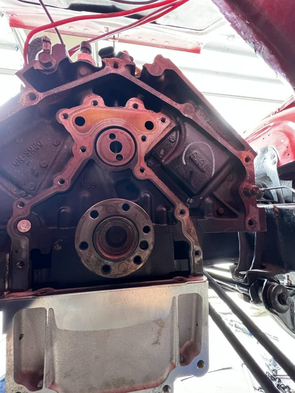

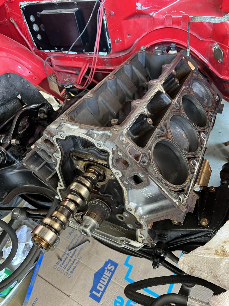

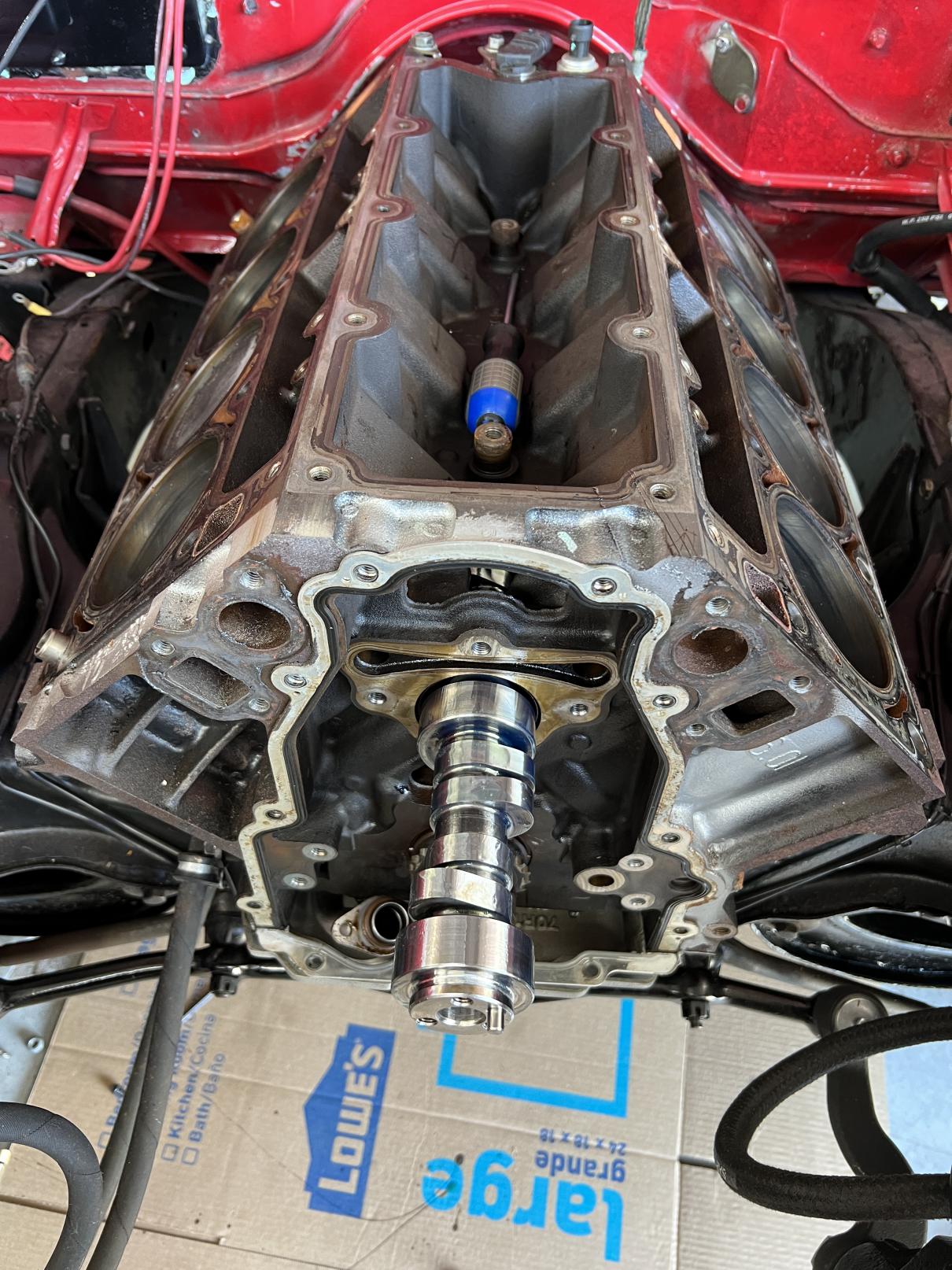

Out with the old…. In with the new!
Opted for the Summit Pro LS cam kit #8720

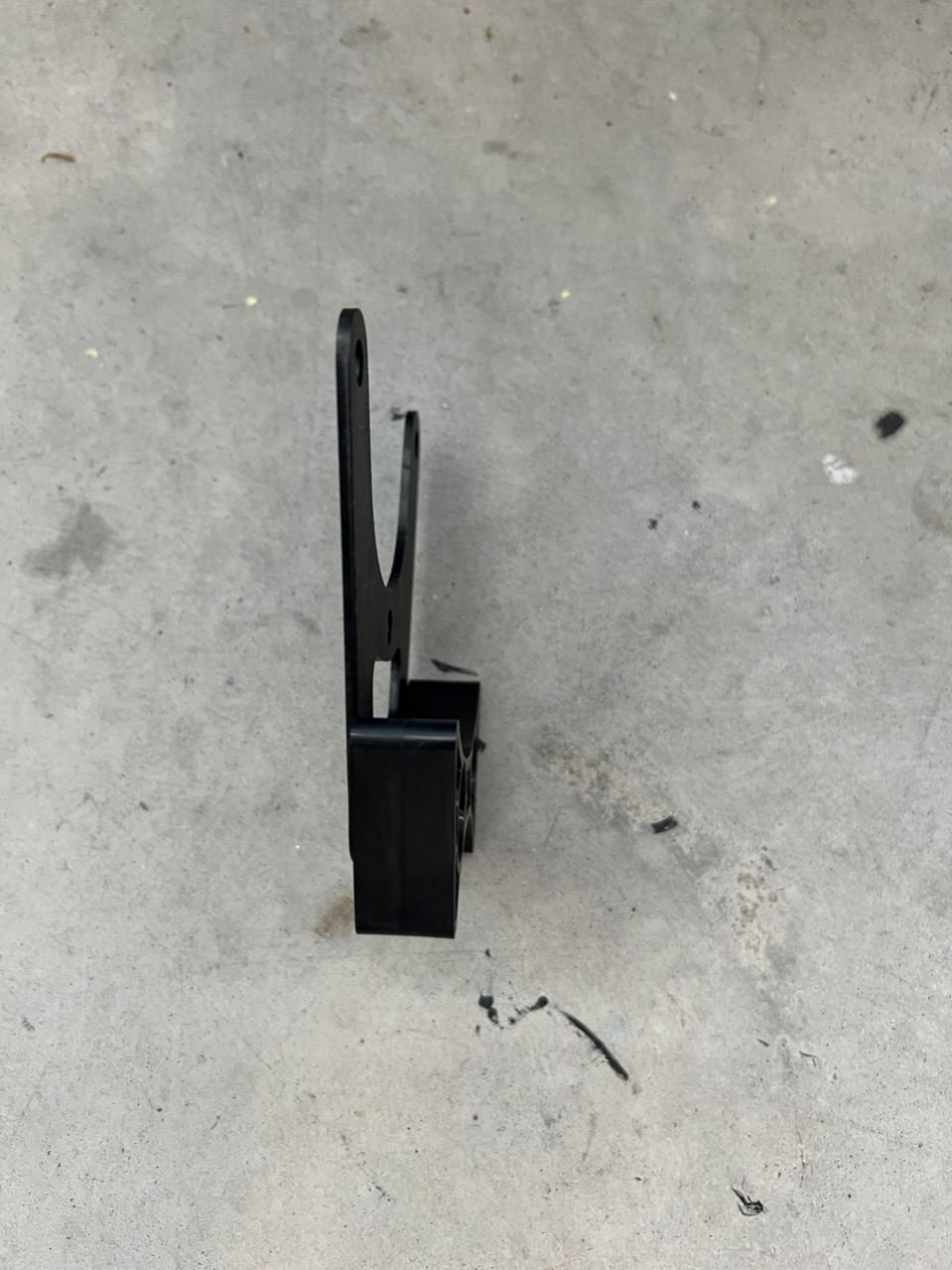

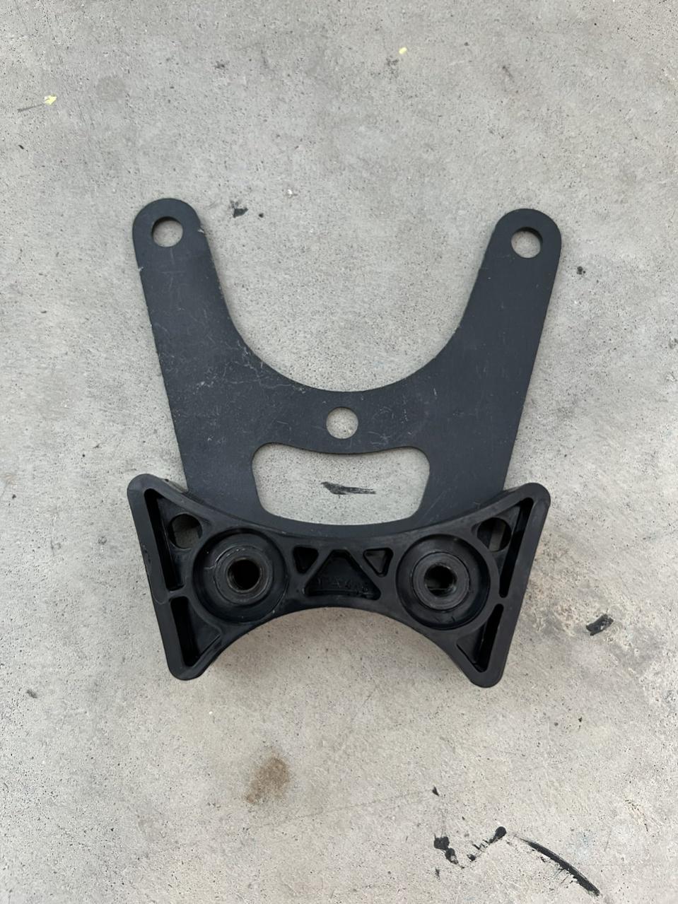

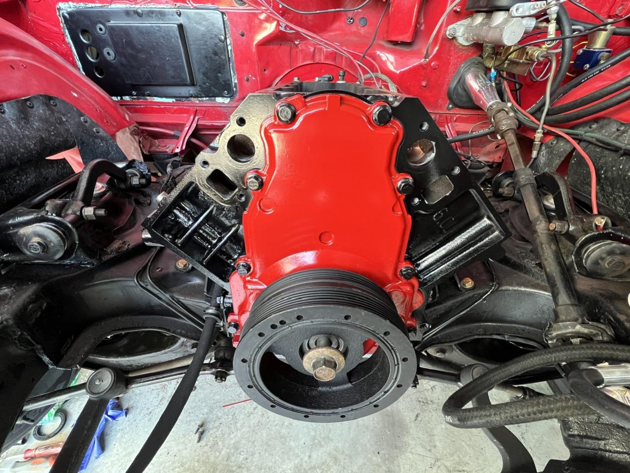

Also added an LS2 style dampener with Melling adapter bracket and new timing chain set.

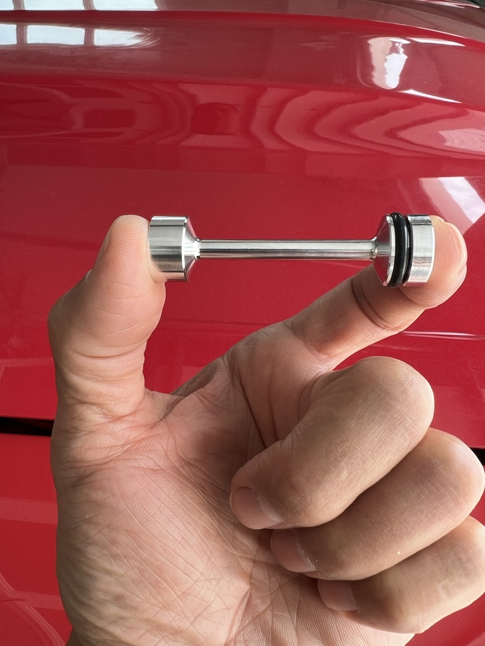

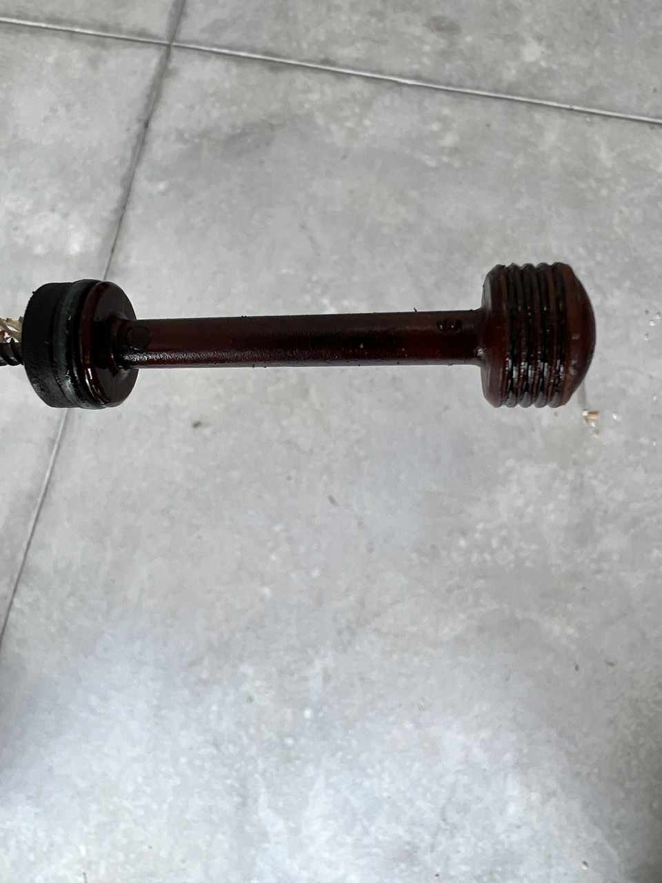

While I had the oil pump off, I massaged the passages a little bit to improve flow and shimmed the spring. I figured since I improved flow and bumped up the pressure a little, I thought it would be a good idea to replace the barbell. I picked one up from SacCityCorvette.com.
I definitely love all the room in the engine compartment of these classics! I was able to reach all but the bottom two transmission bolts from the top! It’s great!

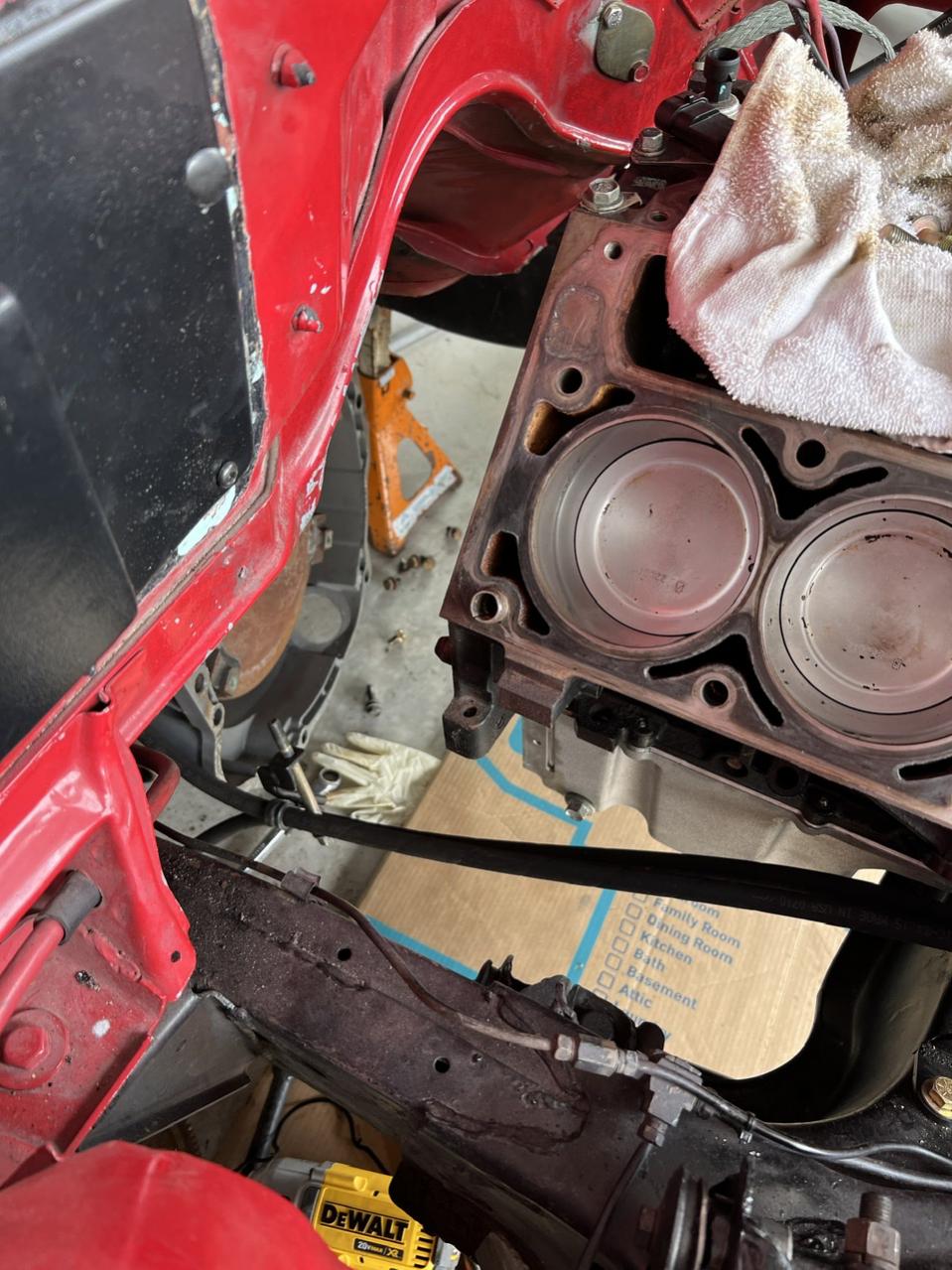

And…. Slowly getting the motor back together. I picked up a set of 243 heads and massaged them a little bit. They probably didn’t need it since I’m not racing anymore, but I enjoy doing the work and I’m sure it won’t hurt it. I upgraded the rocker arm trunnions and installed them along with new springs. I also had to order a set of 7.425 pushrods to get the right lifter preload. I topped it all off with an LS6 intake.

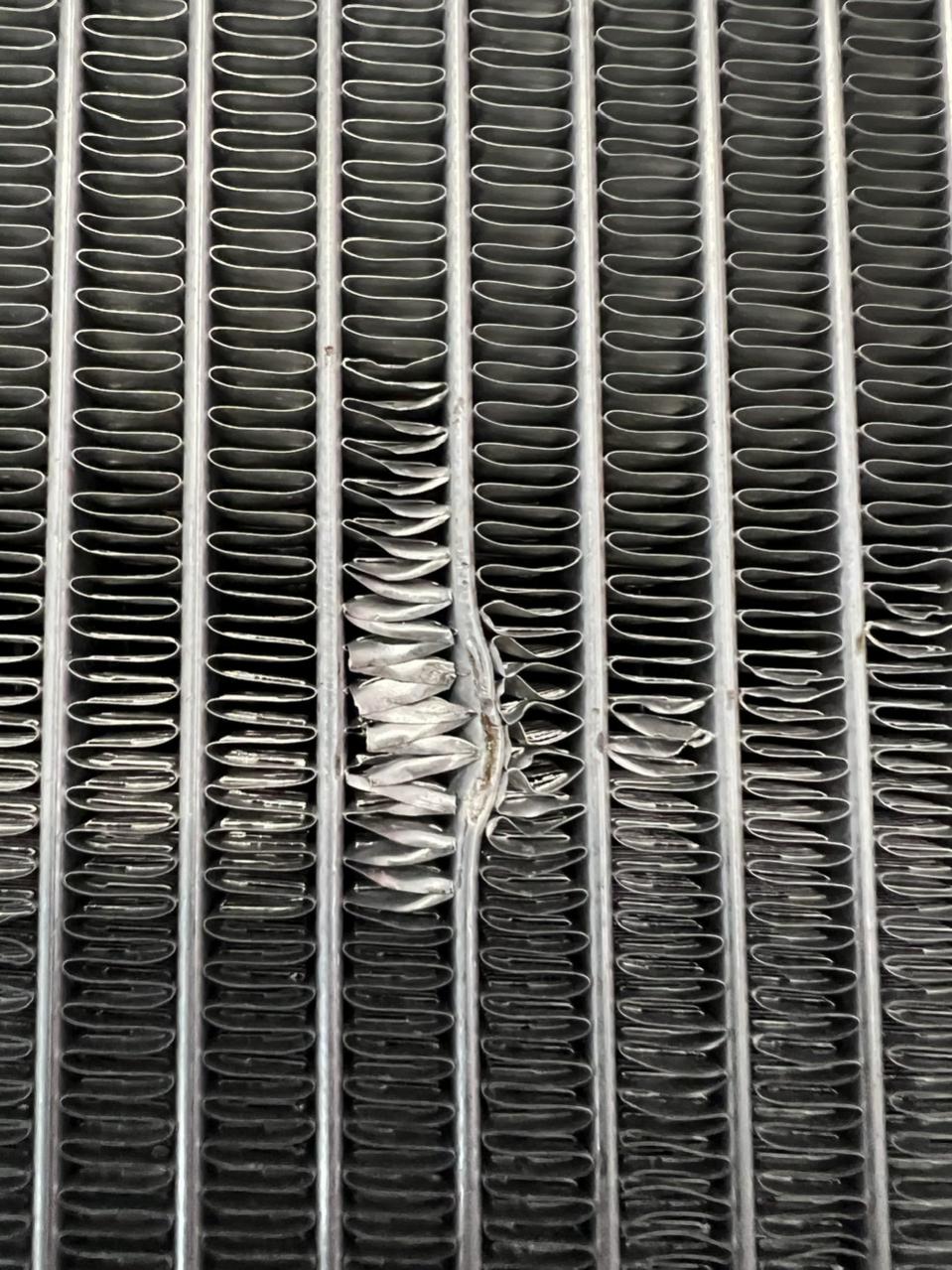

Found this spot on the radiator, so I’ll be taking by a shop sometime next week hopefully to get it checked and repaired if needed. Always something…
More to come as I get things completed.

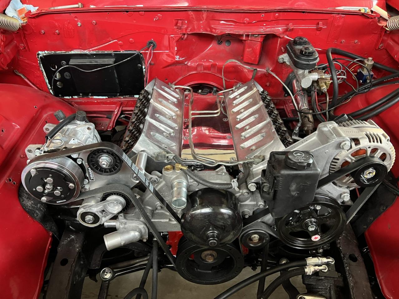

I’m getting ready to start installing the Vintage Air and finding a good home for the Holley Terminator X Max.
First order of business will be getting the ginormous bench seat out. I will them pull out the carpet so I can put some sound deadening material in, and Yes, I will be cutting the drop bars on the cage. As you can see, they are a hinderance for getting in and out. I am not getting any younger and I would also like to make it easier for my kids to get into the back.
