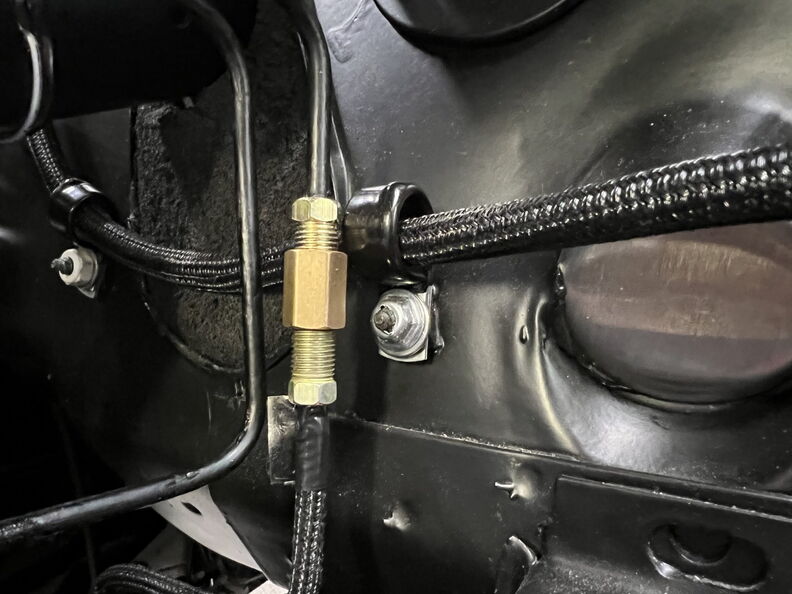

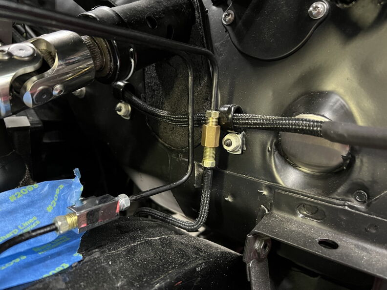

Working on routing the Vintage Air Coolant line using the Mag Daddy Line clamps.
I also moved the valve from in the inside of the car to the cowl as it will be much easier to service if I am have to replace it.
I made this little mock up bracket to stabilize the valve
While I am here I also routed all of the extra wire from the Holley ECU to the front of the car.
Vintage Air wires that will be eventually connected.
I used the heat shrink spade connectors instead of adding heat shrink tubing.
AC Lines added into the mix
You know the bracket I made ... well that was became useless when I ran the AC lines as there just wasn't enough room.
These cloth Velcro wire ties work really nice during mock up and they come in multiple lengths and they also offer more aggressive Velcro closure.
I need this fitting so I can remake the one AC line as I plan to reroute it in front of the battery instead of under the tray.

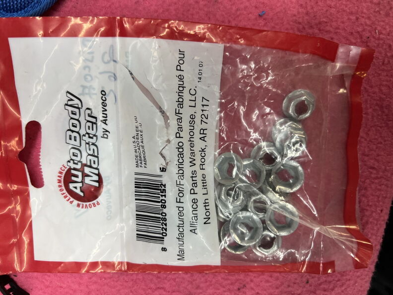

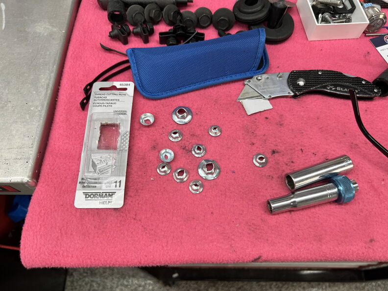

So I am running the DSE wiper harness under the steering column so it looks somewhat factory. However I am trying to come up with a solution to retain the line clamp. Since the hardware isn't a machine thread there really isn't a nut available. In the end I should have just drilled out the holes and tapped them for an actual bolt and then I could just use a nut & washer in the engine bay.
Attempt #1 License plate nut. -- Fail
Attempt # 2 I forgot what these are called. -- Fail
They kinda work but not really
In the end I am just going to drill & tap the holes and do it the right way.

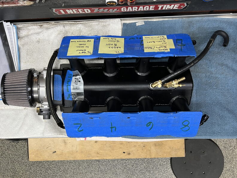

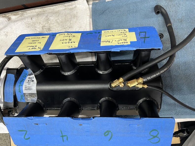

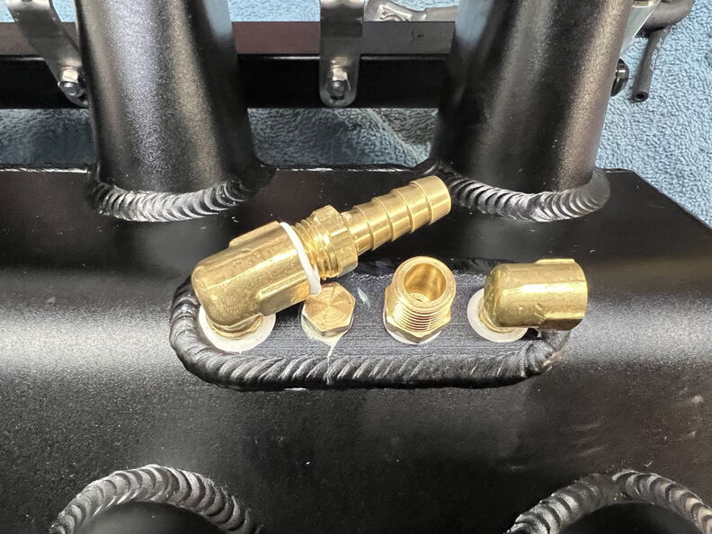

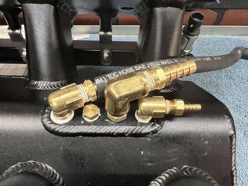

Time to finally finish the intake manifold so I can install it in a couple weeks.

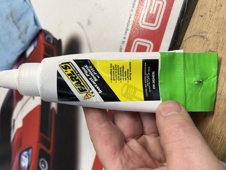

So does this stuff ever dry ?
marty-mj
