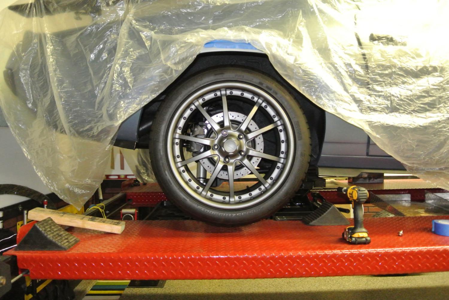

It looks like I figured it out and apparently the line is hitting the caliper before the banjo bolt can be tighten down all the way.
Here is a picture of the Drivers Side and it doesn't leak.
Here is the Passenger side and you can see it is resting on the caliper body.
Once again this line is coming off and being bagged.
Back to my Grandfathers vise.
2nd Attempt as the 1st one was not successful.
Looks like it's going to work.
Line is back on and I will try to bleed the brakes again tomorrow.

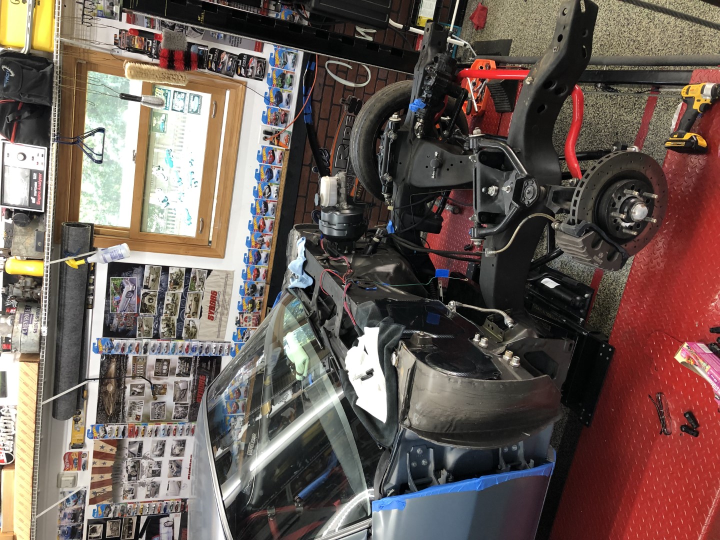

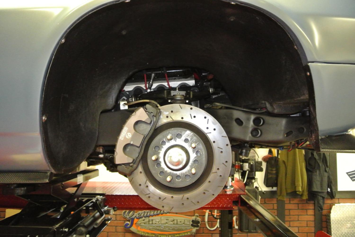

The brakes are from Tobin at Kore3. It’s a c5 / c6 kit with the DSE Corvette Reduced angle brake booster. It like having modern factory brakes on an old car. One of the other benefits is if I break down on the side of the road, I can go to Napa or AutoZone or any other local auto parts stores. I’ll be back on the road.
Sorry, I just added pictures
