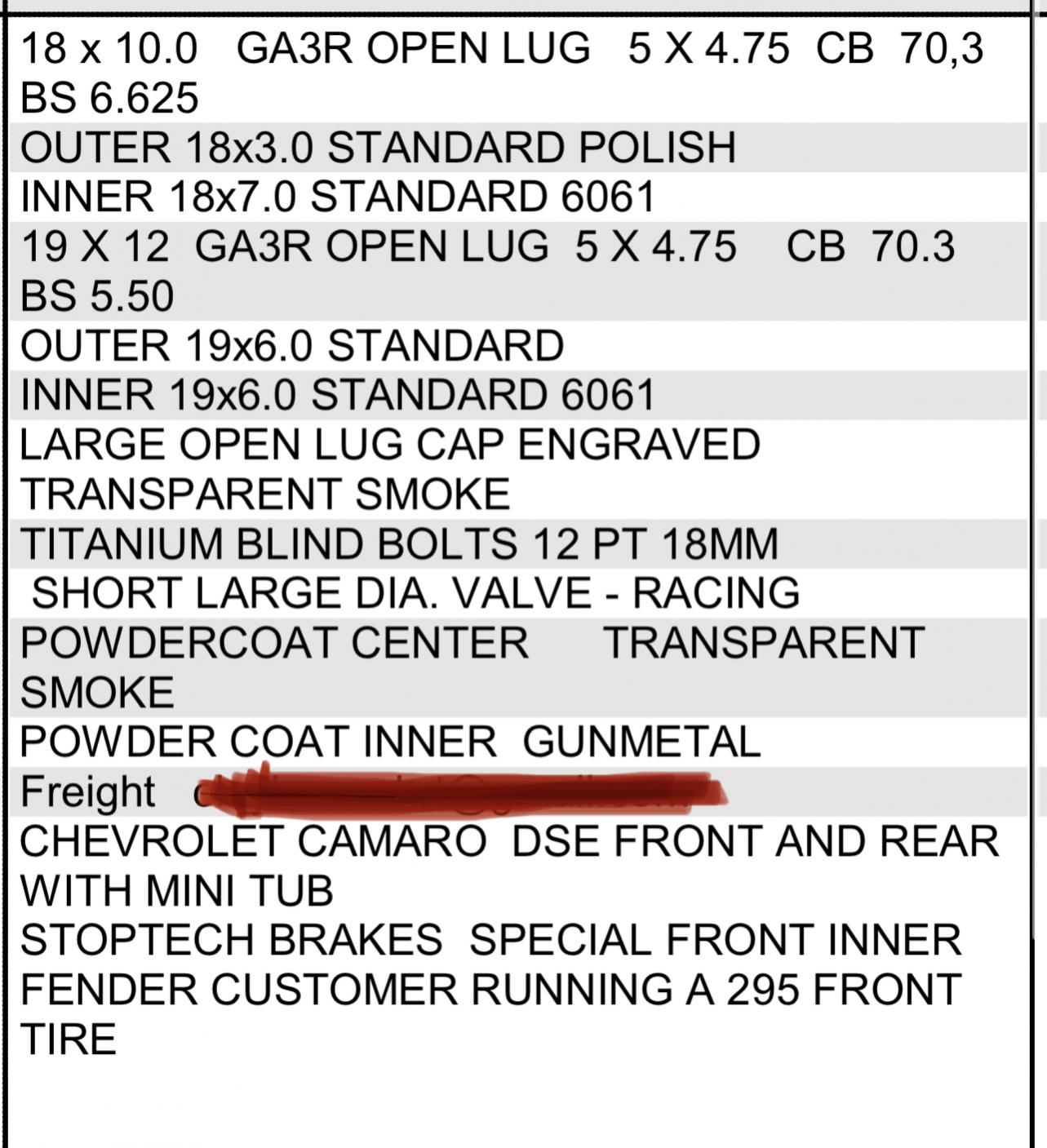

295/35 up front on 18x11
345/30 out back on 19x12
I'm late to the party.
Any specifics on the offset for the front wheels? I also have a DSE front subframe for my 76 T/A.

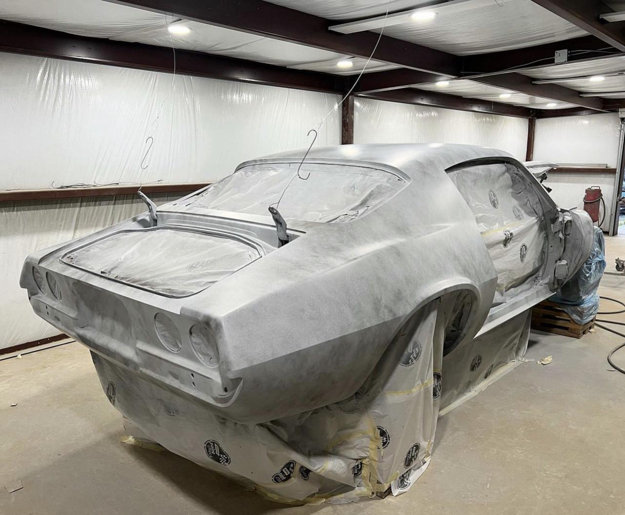

Cars in final prime.

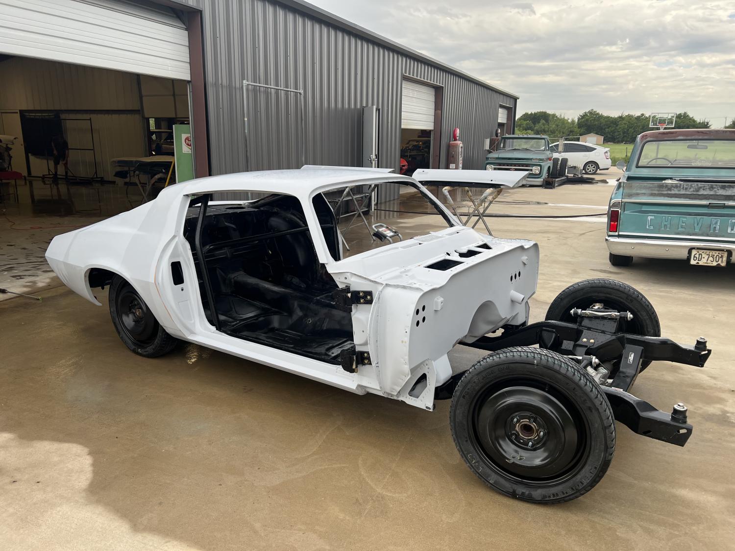

The Camaro is finally going to get color. It’s been a long time coming but the final sand before going in to the booth is underway.

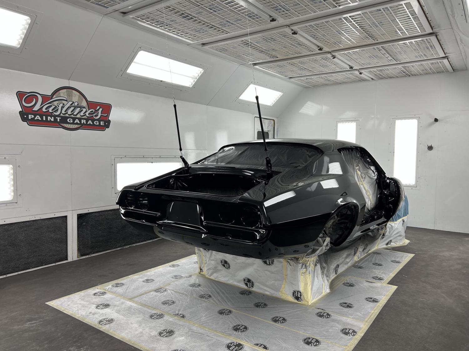

After 5 years the Camaro is black.
