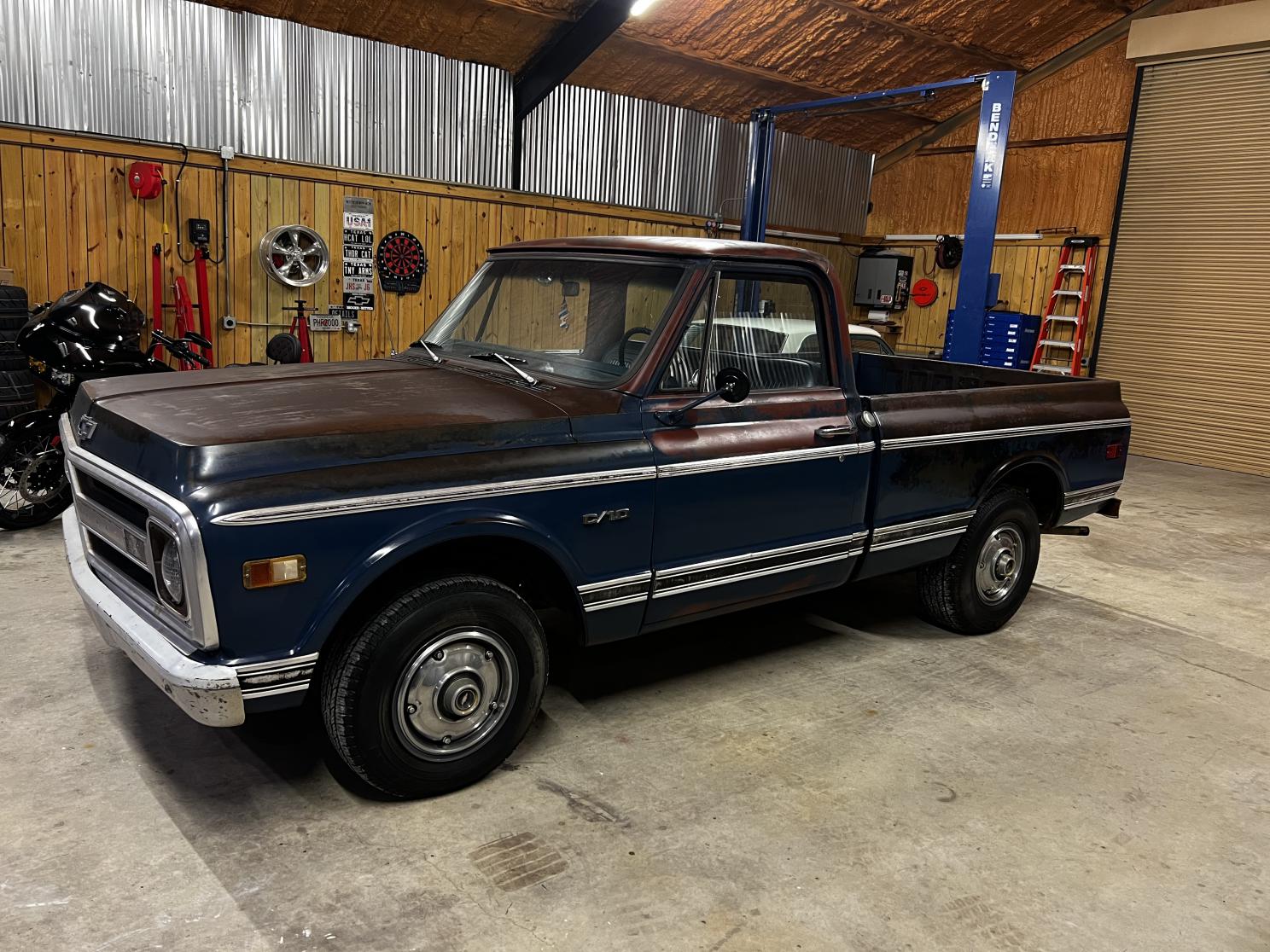

Quick run to FL and got the truck home. Also stopped in to a buddies place and grabbed a 8HP90. It is a very solid/straight old truck. Not all beat up. Plan to drive it as is until the chassis is ready. Wheels and brakes are ordered.

Got the motor and trans mocked up to build mounts. With the high hump floor I have all kind of room. We’ve got the front of the motor sitting about 3” higher than it has to be but it gives me plenty of room for headers and nothing is close. Running about a 3° down angle on everything so I think that’s we’re it’ll live. Everything is sitting level with the crossmembers.
