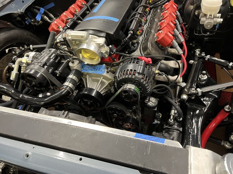

Default Intake piping (( 12-06-22 ))
So I ordered a bunch of 4" Aluminum piping from Amazon.
I went out to the garage and I realized I don't need the center section.
This looks like what I need.
12-11-22
Final Mock Up using the tighter polished bend
Looks like I need to shorten the line clamp bolt
Years ago I received at Craftsman Stainless Steel Socket Set. It has come in handy so many times. Once again the plastic grip on it allowed me to hand tighten the line clamp.
I kinda like it.
I will need to add some sort of support bracket.
I will also be installing a 6" long filter so I will have to shorten this pipe.
marty-mj
