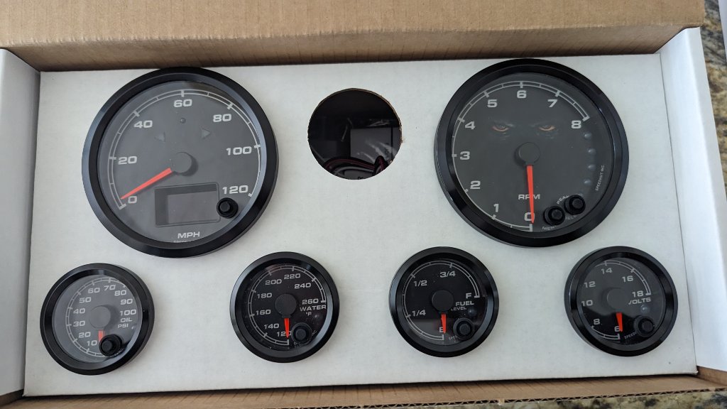

Gauges arrived.

Originally Posted by Goosesdad View Post
Gauges arrived.
Attachment 79759
120mph speedo?
I think someone underestimated this rocketship. Lol

Originally Posted by Tinker View Post
120mph speedo?
LOL. I’m sure he’ll never go over the speed limit. LOL
WHAT gauges are those? SpeedHut ??? Those look great.
120mph speedo?
Well played!! LOL.
Yeah, struggled here. SpeedHut just came out with these new gauges and the only option they have right now is the a GPS speedo that maxes at 120. They will do the trans input coming soon but I needed to pull the trigger now so I can take the next step with the dash. Guess I'll have to stay away from 4th gear!
