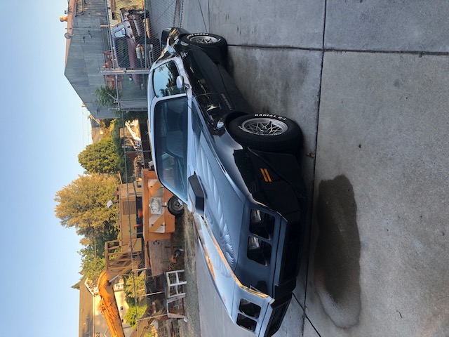

Picked up a 79 Ta the other day
Has speedtech front and rear suspension (leafs)
with viking shocks, new ridetech steering
Has a premium package which means everything
including power windows, tilt, cruise, AC, rear defroster,
T Tops, trunk release, dual rear power antennas
and it is in really good shape... love a TA dash and this
one is perfect
Paint needs some work and may respray it
Will see what the paint Dr can do to fix it up
403 automatic car so nothing special there yet
Upgrades coming
Subframe connectors, true dual exhaust and headers
Engine change maybe later, roll bar
